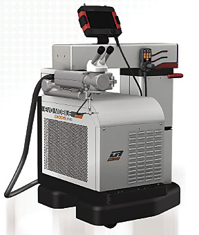

OR%20Laser%20EVO%20mobile%20welding%20station.tif
Courtesy of O.R. Lasertechnology
O.R. Lasertechnology’s EVO mobile laser welding station allows for precise repair of mold components.

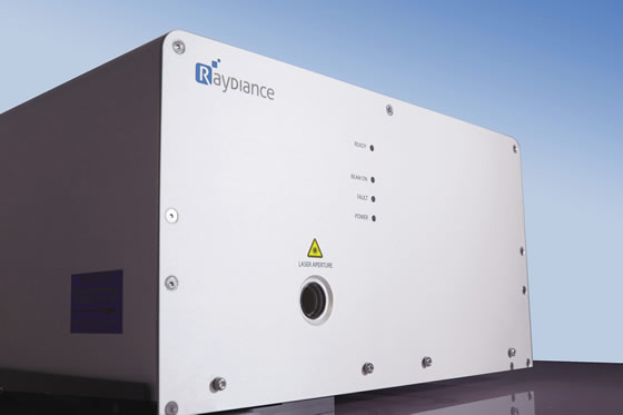

While 3D laser deposition is a newer addition to the moldmaking toolbox, ablation is still the standard application for lasers when it comes to finishing cavities. Many types of lasers can be used to impart textures, but Raydiance Inc., Petaluma, Calif., offers what it says are complete machining solutions involving ultrashort-pulse lasers.
“Usually when folks turn to [femtosecond lasers], they’ve tried other tools, maybe even other lasers, but can’t reach the dimensional precision they need,” said Michael Mielke, chief scientist for Raydiance. “We deal with part-to-part consistency on the order of 1µm.”

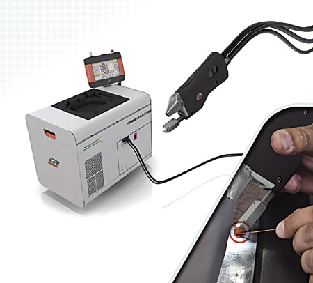

OR%20Laser%20iQ%20welder.tif
The iQ hand-held welder allows the user to make repairs on mold inserts without removing them from the fixture.
Raydiance recommends femtosecond lasers—which produce the shortest pulse of any laser—for moldmaking work. According to Mielke, the accuracy of fs lasers has led to shops using them to replace other machining options—such as drills, mills, EDMs and conventional CO2 and Nd:YAG lasers—for finishing work, as well as other applications typically reserved for traditional machining.
“If you’re drilling a hole or milling a surface feature in a mold or die, you often have very precise tolerances and surface quality requirements,” Mielke said. “Femtosecond lasers can routinely do submicron-level surface finishes and can maintain flatness on the order of 1µm or less. In comparison [to other types of tooling], sure, a femtosecond laser is going to be more expensive initially, but shops can see a full ROI within months, not years.” Mielke added that moldmakers report reduced material waste and less post-processing when using fs lasers.

And when the mold itself eventually wears, Dieburg, Germany-based O.R. Lasertechnologie GmbH offers an advanced repair solution. (O.R.’s U.S. operation, O.R. Lasertechnology, is located in Elk Grove Village, Ill.)
Laser welding—the practice of using a preprogrammed laser system to melt deposition wire directly into the weld—all but eliminates operator error and provides superior weld quality resulting from a simpler operation than conventional welding, according to the company. “With lasers, you can weld very specific areas, put down exactly the amount of material exactly where you want it, making the post-work cleanup very quick and efficient, compared to conventional welding,” said Sales Manager Michael Barsanti. “The deposition wire could be anywhere from 0.004 ” to 0.040 ” [in diameter], so if there are tiny areas that flash on your molded parts or wear marks that require a very small weld to bring the part back to spec, laser welding is the answer. There’s no oxidization, no porosity, no arc or stick or melt pool to control. The operator just needs to understand the geometry of the workpiece and hold the wire steady, and the machine will give you a uniform weld every time.”
Raydiance.tif
Courtesy of Raydiance
Raydiance lasers utilize pulses in the femtosecond range to ablate material and create finely detailed textures in the mold cavity.
Laser welding is not new, but O.R. says its line of diode lasers has refined the process. The Nd:YAG lasers typically used for laser welding introduced in the 1980s were water-cooled and utilized multiple moving parts, as well as lamps and other consumables that had to be monitored and replaced. O.R.’s Diode-brand diode lasers, by contrast, are air-cooled, have no moving parts and use single-phase power, eliminating the need for a bulky transformer. In addition, the laser welding process can be automated.
Operating O.R.’s Diode lasers does not require extensive training or craftsmanship, according to Barsanti. “The machine is positioned on an X-Y arm and is run by a joystick, and, once positioned by the operator, the entire process is mechanized. That means a novice laser welder can come in after just a few days of training and do a professional repair job on a mold, something that was never possible before.”
O.R. said its iQ hand-held tool takes advantage of laser welding being extremely precise and using only a small amount of material. The tool allows a user to repair an injection mold without removing the inserts, potentially saving days of work, according to Barsanti.
