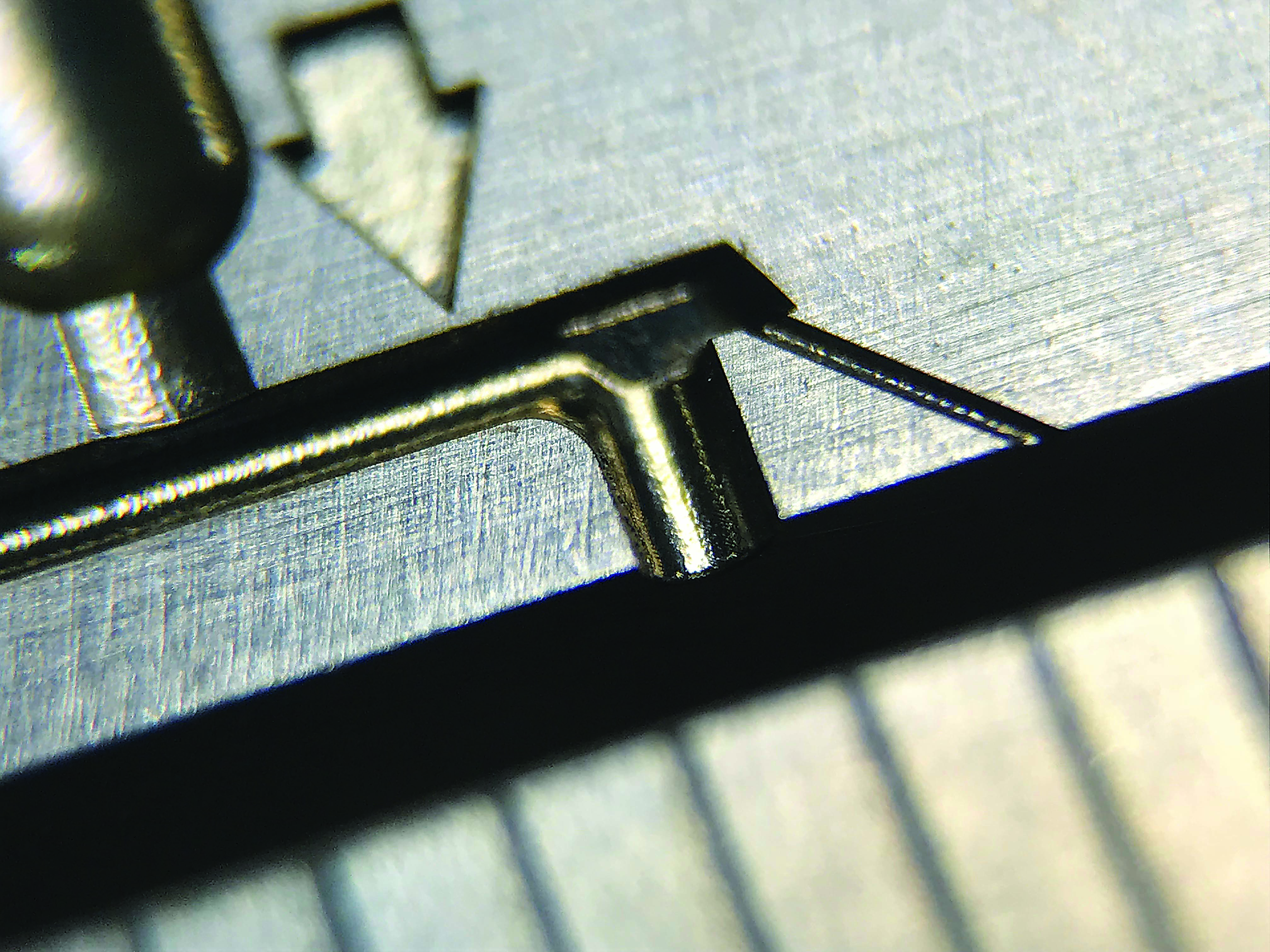

A femtosecond laser machined this cavity in a mold for a medical implant. Providence Texture cut the cavity, injection runners, venting, guide channels for over-molding and identification information in a single setup. The blurry lines in the foreground indicate 1mm increments. Image courtesy of Providence Texture

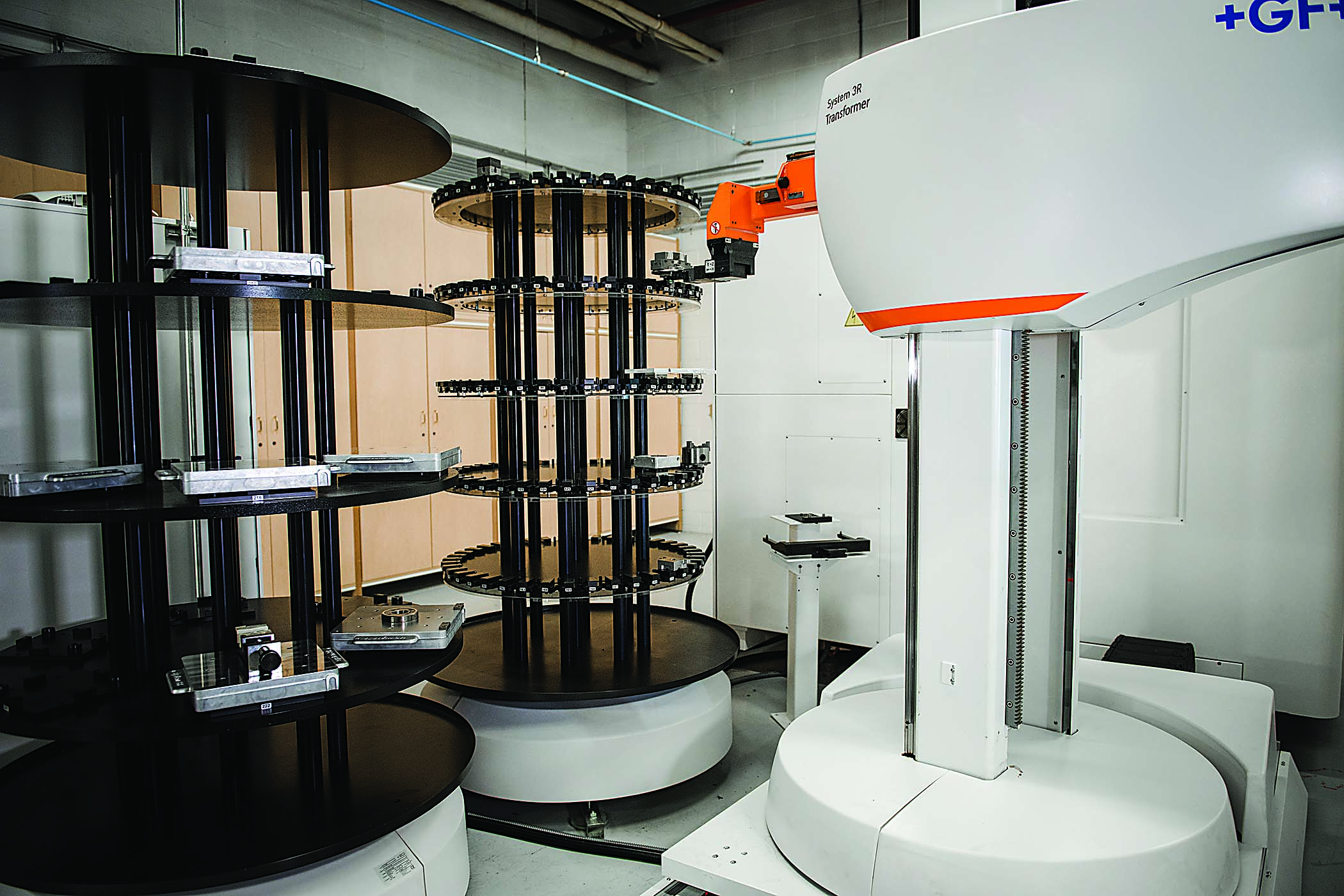

Several AgieCharmilles laser texturing machines at Providence Texture are connected with a System 3R palletized automation system. Image courtesy of Providence Texture

The production cell at Providence Texture’s 5,000-sq.-ft. facility includes a Laser P 1200 U with a 50w infrared nanosecond laser, a Laser P 1000 U with a 30w infrared nanosecond laser and a Laser P 400 U, which features a dual-source 20w infrared femtosecond laser and a 30w infrared nanosecond laser. The 1000 U and 400 U are connected with a System 3R palletized automation system featuring Dynafix and Macro standard pallets with custom fixturing, as well as 28' of linear track for a Transformer robot.
Providence Texture has found that the key to maintaining the highest levels of part precision during production is automation. With its System 3R automation and custom fixturing designed around the laser’s capabilities, the shop keeps repeatability within ±3µm. Automation capacity also makes it possible for the shop to handle a high-mix, low-volume manufacturing environment and easily adapt to high-volume production when necessary. Production lot sizes range from one-offs to tens of thousands of parts.
Providence Texture’s System 3R palletized automation system features Dynafix pallets and custom fixturing, as well as 28' of linear track for a 6-axis Transformer robot. Image courtesy of Providence Texture
“I would definitely recommend a laser paired with automation,” Matt said. “With our custom fixtures, we can program a reference offset and know that we’re within 2µm to 3µm of accuracy when that fixture goes back in front of the laser. That kind of precision is key when you’re working at the micron level. We keep the ambient shop temperature within 4° F to ensure the greatest possible accuracy.”

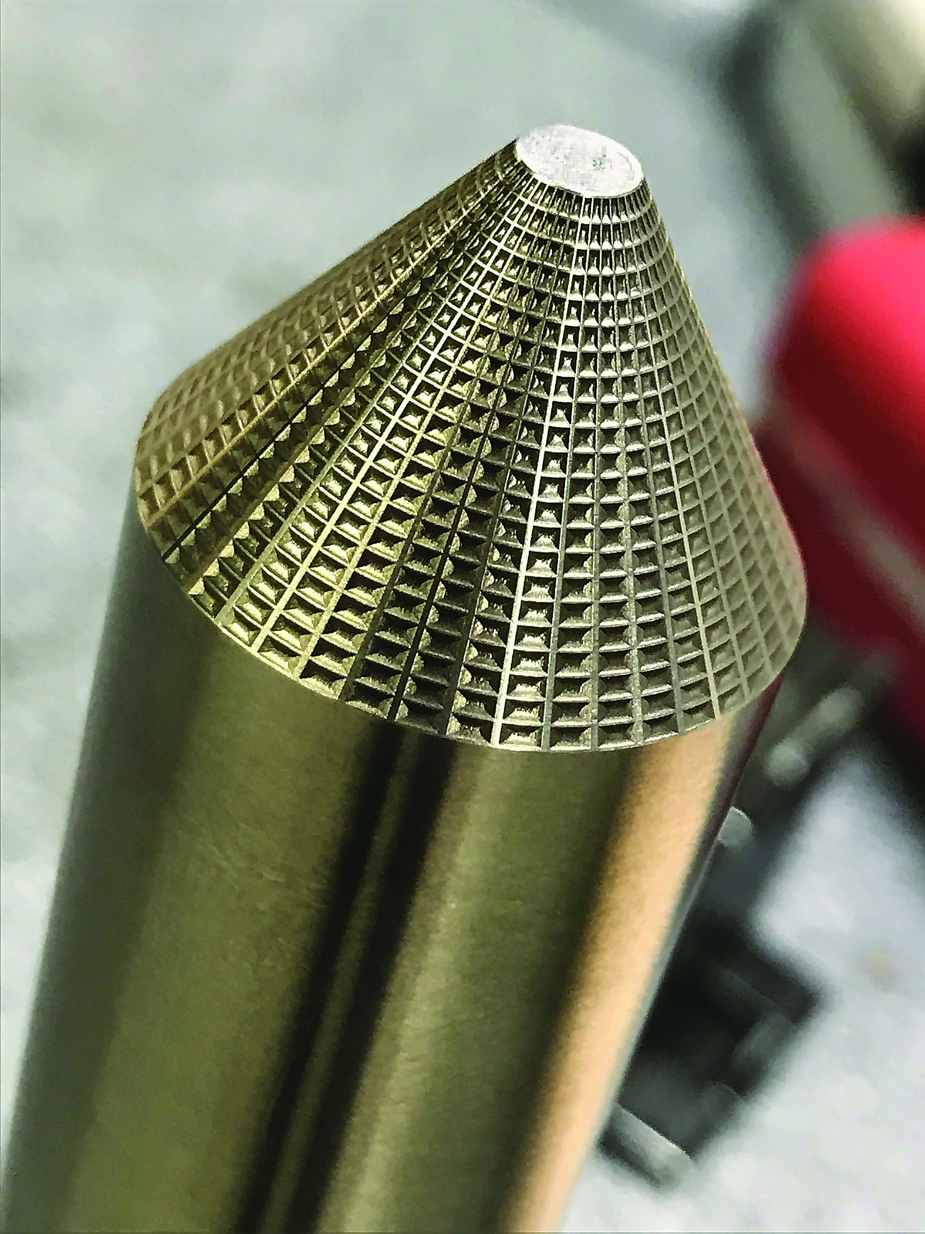

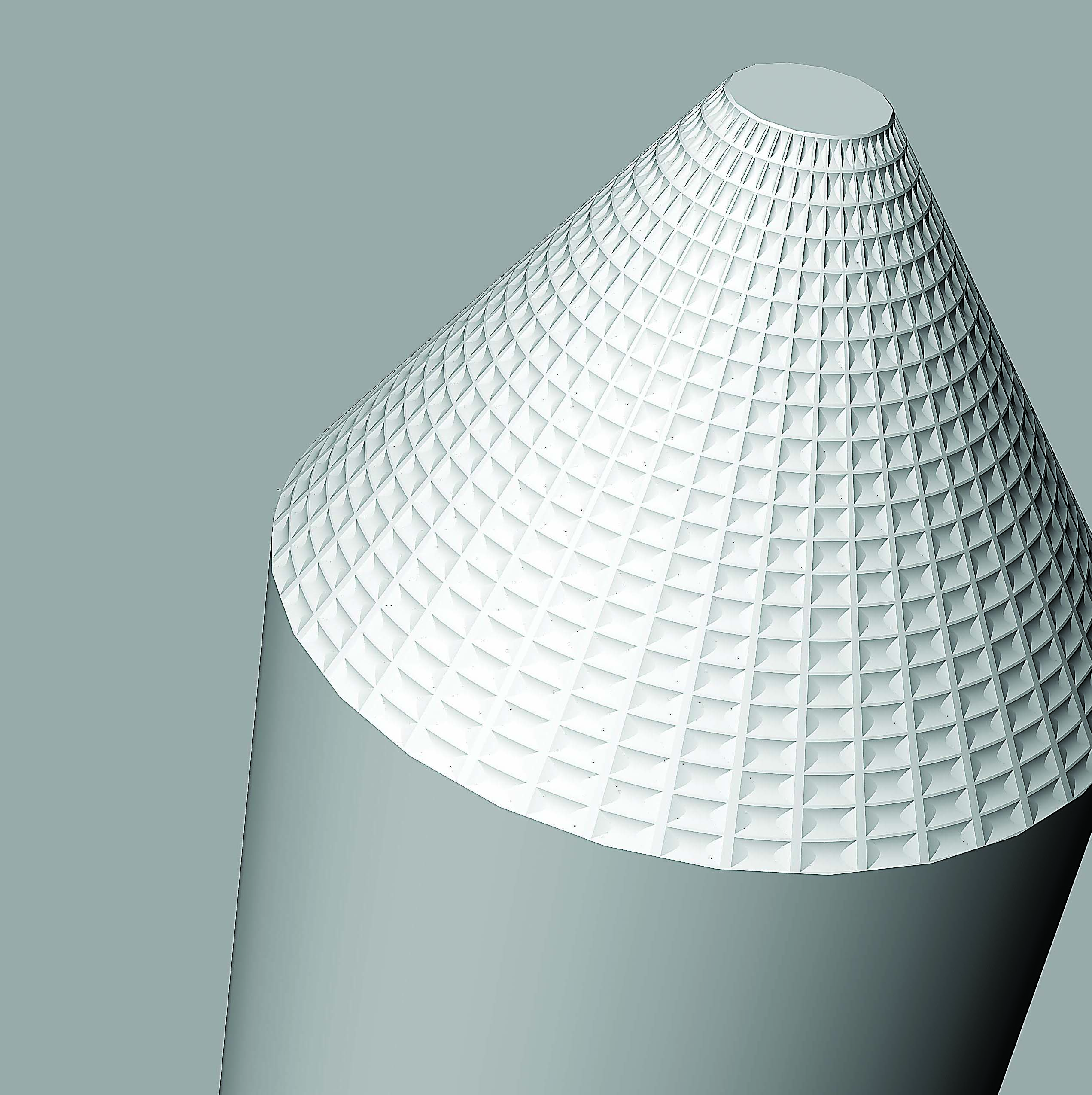

With its AgieCharmilles laser texturing systems, Providence Texture quickly generates precise microstructures on workpieces as shown in this photo and CAD illustration. Image courtesy of Providence Texture
Since starting Providence Texture, Matt has had the opportunity to rethink and establish many of the parameters he uses today. His background is in mold texturing dominated by packaging, consumer goods and automotive, but his company also serves a range of other industries, such as medical, aerospace, lighting, defense, jewelry, sports equipment and electronics. The shop produces a vast scope of textures, including those with extremely low Ra value surface finishes. However, more and more the company uses its Laser P 400 U to micromachine part features.
Many of these part features are deceptively simple, such as V-shaped grooves to add pressure to gasket seals that may be as little as 0.005" deep or 1mm to 2mm threaded features on a plastic syringe barrel injection mold. Femtosecond lasers can create many of these features faster and at less expense than a typical sinker EDM, as well as features that demand micron-level tolerances that would be difficult or impossible to achieve with traditional techniques.
