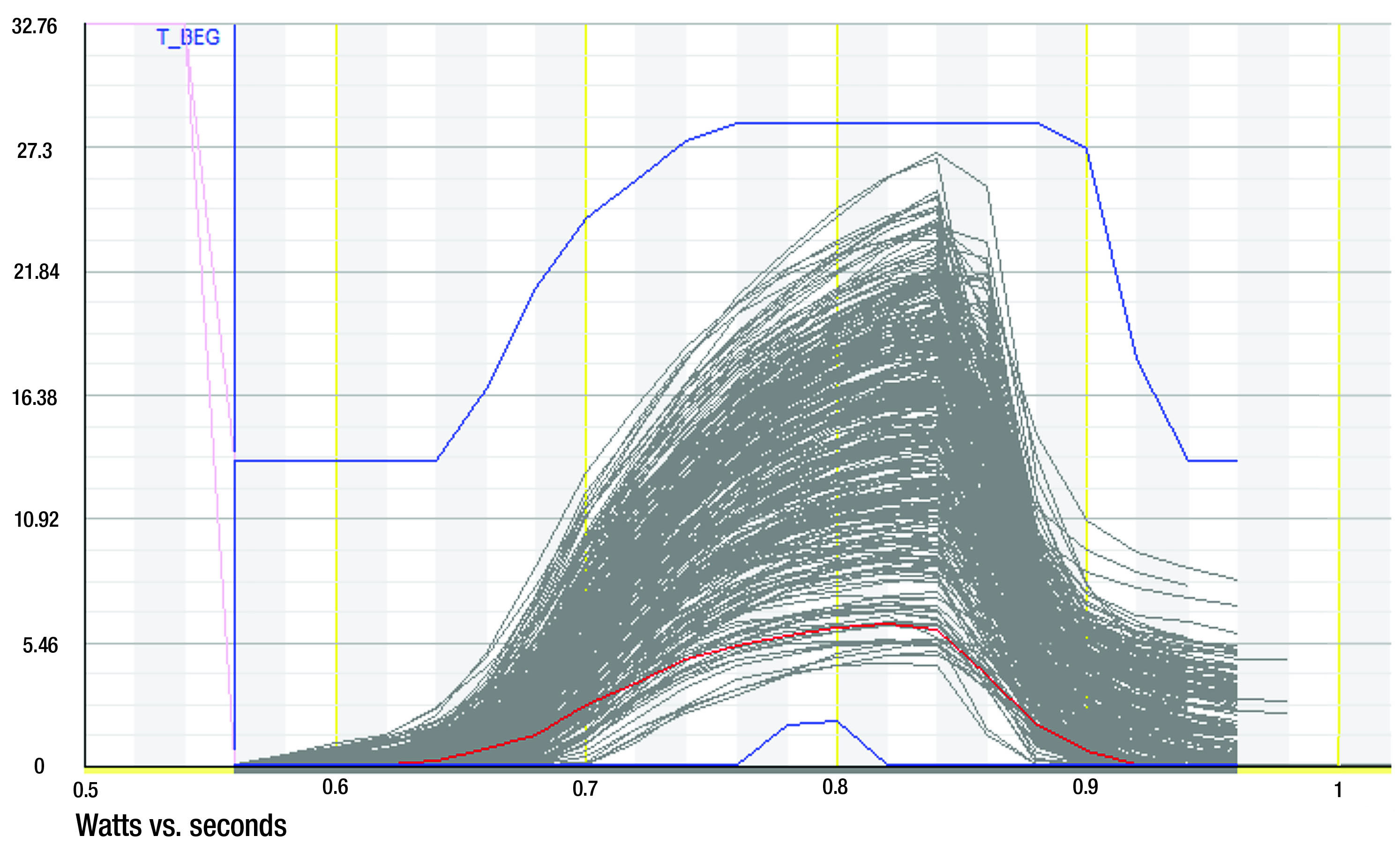

An example is shown of a 0.47 mm-dia. (0.0185″) drill on a 5-kW spindle. Machining power is about 5.5 W. The red curve represents a new drill, and the blue lines are the upper and lower power limits. Note the increases in power due to drill wear. Image courtesy of Digital Way
