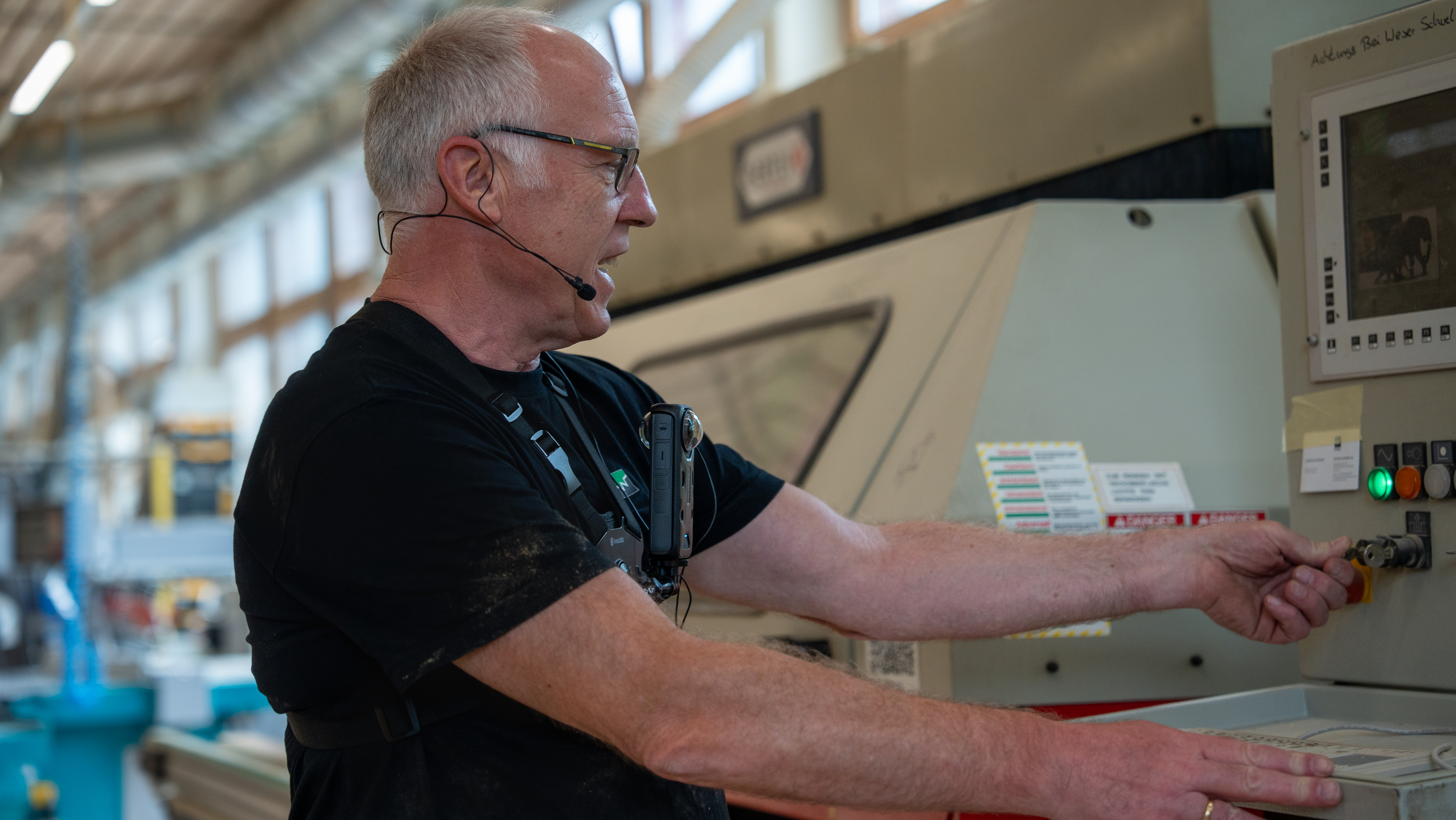

Having a positive result for the chatbot, Saurer said LNS decided to incorporate Rimon’s video-based documentation system as its second AI project. Rimon reports that at the heart of the system is the Digital Walter software, which is the “experienced worker/handyman” assistant that makes expert knowledge searchable and finds the right spot in videos and documents. Experts at manufacturers record their work hands-free with body cameras and the system instantly turns the recording into multilingual instructions.
Worker recording a procedure for Rimon’s video-based documentation system
Rimon’s video-based documentation system enables experts at manufacturers to record their work hands-free with body cameras, and the system instantly turns the recording into multilingual instructions. Credit: Rimon Technologies
Saurer emphasized that LNS employs many experienced workers who will retire in the coming years, and the company wants to keep their critical know-how in the organization after they leave. Automated by AI, the Rimon system enables that by capturing experts’ actions and verbal instructions so that it can be accessed by younger workers.
