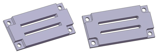

Avoid flippantly adding fillets, radii and chamfers on parts just because it is easy to do with a computer. Such features can substantially increase the time it takes to make parts, as special cutters and additional programming may be needed.
More Help for Engineers
Square corners are nearly impossible to cut with a milling machine. Include radii on pockets and cutouts when possible. All images courtesy J. Harvey.

Be aware that milled pockets must have a radius somewhere. If you submit a drawing of a part that has pockets or windows with square corners, the job may get sent out for wire EDMing at a substantial cost increase and/or delay to the project.

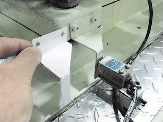

When designing and creating a drawing for a bracket that’s added to a machine after it is built, avoid holding a ruler to a machine and saying, “That looks about right.” I can almost guarantee you that approach won’t work. Instead, go to the machine where the bracket is going to be used and, with a pair of scissors and piece of cardboard, make a model of the bracket. Mark the hole locations on the cardboard—take your time. Then make a drawing of the bracket using the cardboard model as a reference.
I once had to remake a simple bracket a dozen times until it fit on a machine properly. Some machinists see this type of inefficiency as job security. Vendors may love it because they can charge for each revision. I see it as a waste of my time. As one of my respected mentors used to say, “It’s easy to make junk.”

Be aware that small inside radii take longer to machine than large ones. For machinists, inside radii are more of a concern than outside radii. The larger you can make inside radii in your part designs, the more options you give the machinist in terms of choosing endmill sizes to cut them. The larger the endmill, the faster the part can be made.

Low-tech still has its place. For example, it's a good idea to construct a cardboard model of an odd-shaped bracket to see how it fits on a machine before releasing a drawing.
Low-tech still has its place. For example, it’s a good idea to construct a cardboard model of an odd-shaped bracket to see how it fits on a machine before releasing a drawing.
