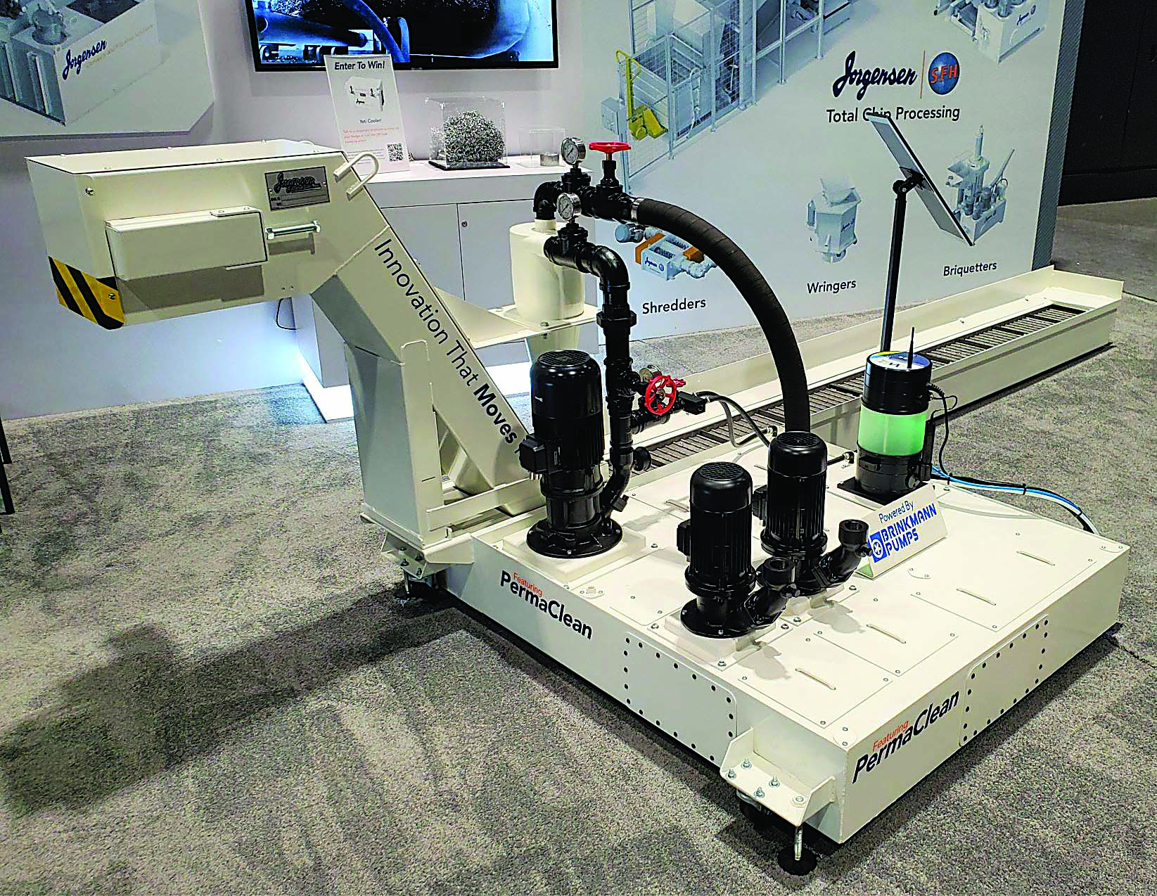

One new product that falls into this category should be welcomed by shop maintenance personnel. Sold by Jorgensen Conveyor and Filtration Solutions in Mequon, Wisconsin, the PermaClean filtration option is said to make coolant tanks virtually maintenance-free when combined with cyclonic filters that rely on centrifugal force rather than filter media to remove contaminants. According to the company, PermaClean eliminates sludge buildup by using eductor nozzles to keep coolant in motion in a tank. This in turn keeps chip particulates suspended in the coolant, thereby preventing them from settling in the tank. PermaClean can be incorporated into any of Jorgensen’s multistep filtration systems, the company notes..
