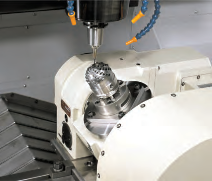

Courtesy of Makino
A trunnion/table arrangement, such as this one on a Makino F5-5XR VMC, permits drilling of angled holes without the need to employ a compound-angle drilling head.
For example, a more common application of 5-axis machines uses the two rotating axes to move or index the part into position, then performs the machining in the more familiar X, Y and Z axes. Compared to simultaneous 5-axis machining, “3+2,” or five-sided, machining can be accomplished without complex programming and can reduce labor cost and production time while maximizing quality, even when machining routine parts.
