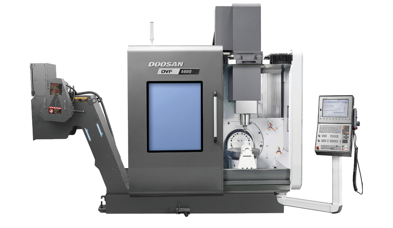

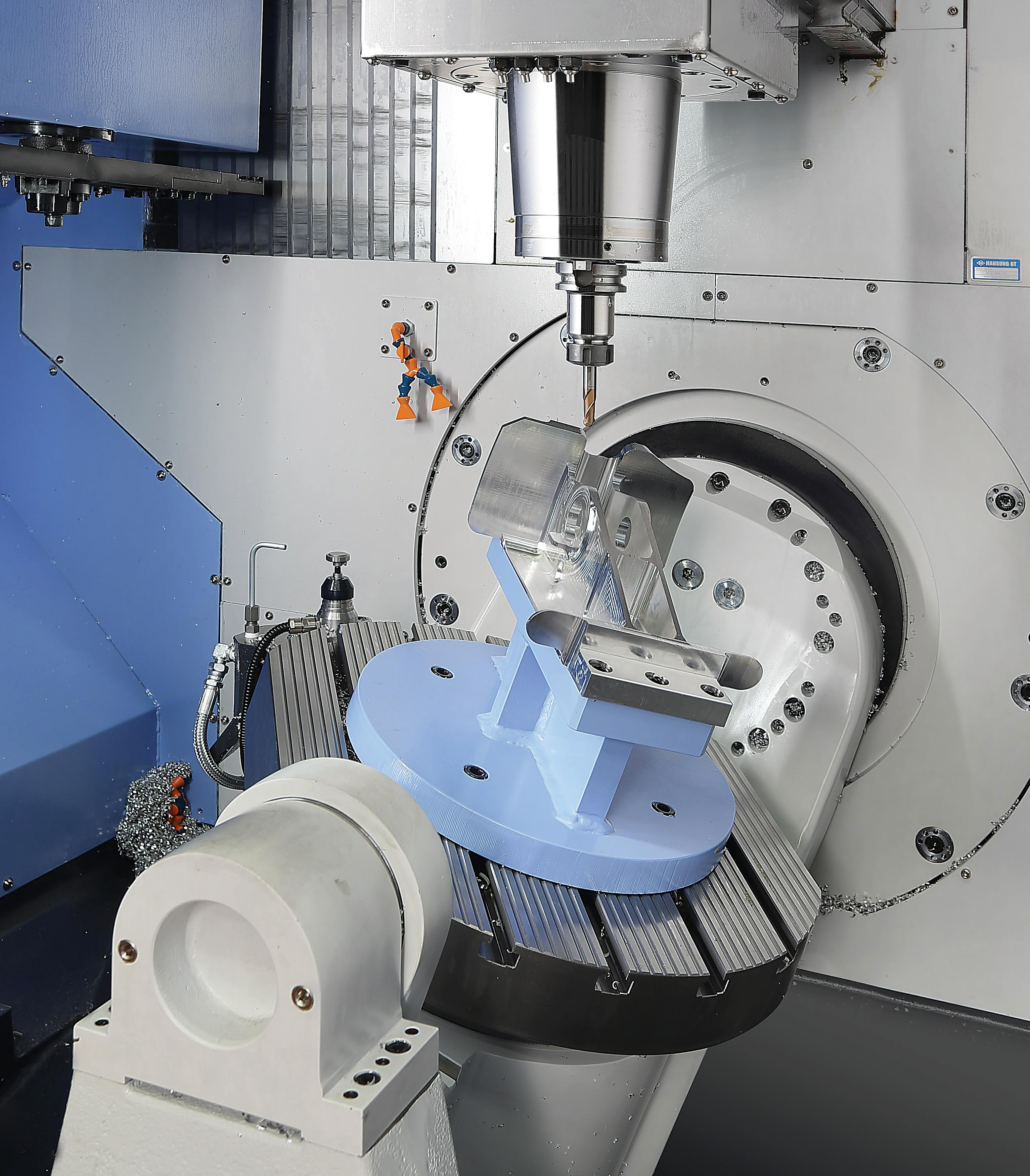

Doosan’s DVF 5000 multitask machine (left and above) enables simultaneous 5-axis machining. Image courtesy of Doosan Machine Tools America

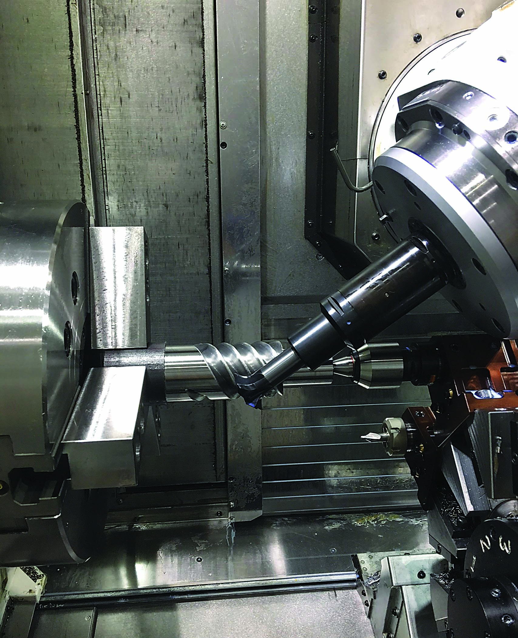

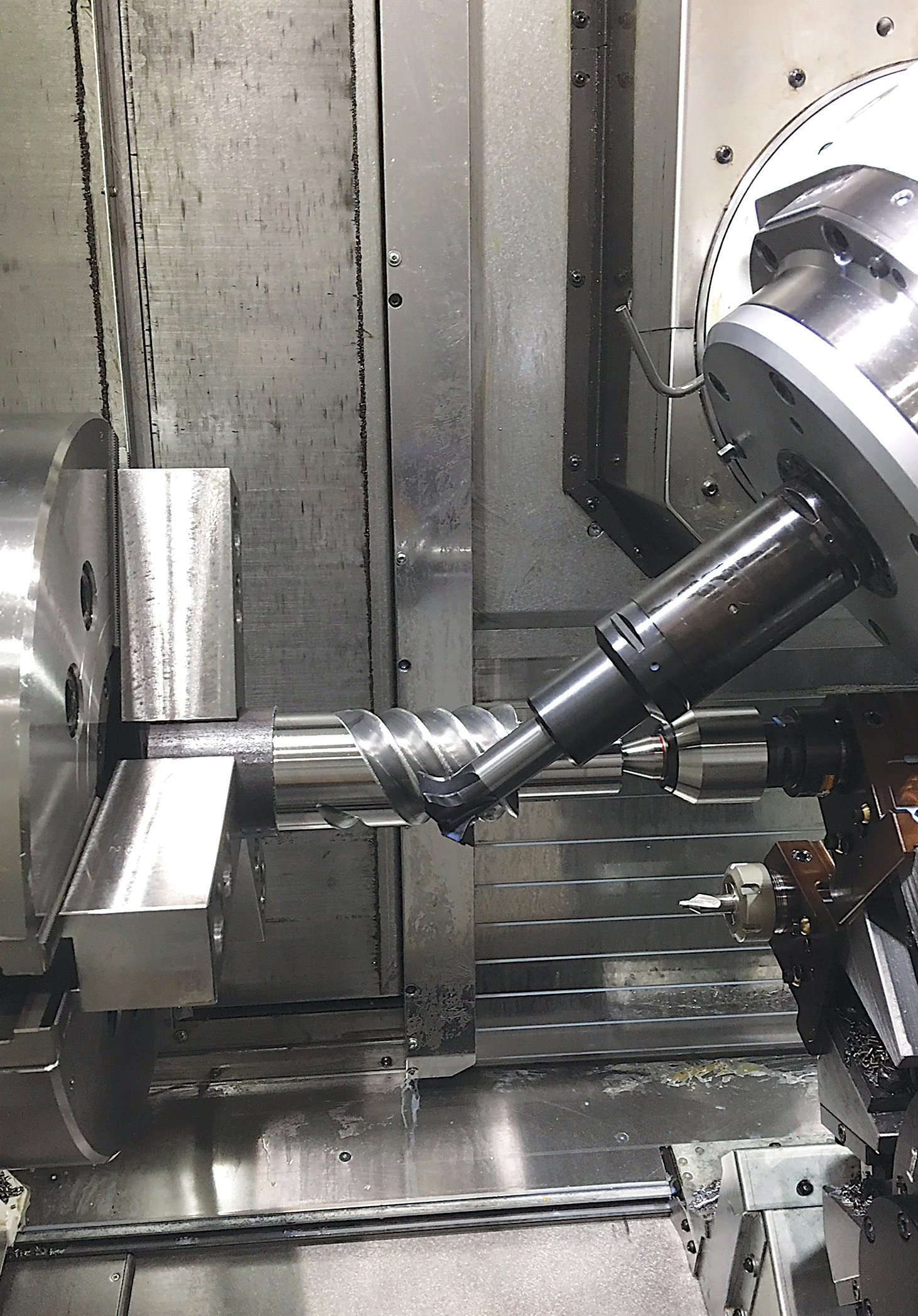

Okuma’s Multus U4000 multitask machine (below) has a 240° B-axis range. Image courtesy of Okuma America
“These types of machines did minimal milling work and 85% turning,” Fischer said. “But over the years, the systems have improved so that now they can do significant milling.”
For one, he said, the horsepower and torque of milling machines have increased, allowing heavier cuts. Other significant upgrades include improved software and servo systems, which have boosted accuracy for machining intricate parts. In addition, controls have become easier to use, making complex multitasking machines more accessible to operators.
With Okuma’s Multus multitask machines, “there are virtually no trade-offs at all,” Fischer said. “The turning capabilities are as good as any lathe of comparable size, and the milling capabilities are as good as any mill of comparable size.”

The Multus features a turret that rotates around a B-axis so tools can be used in multiple orientations, allowing the creation of side holes, for example. The machine holds up to 180 tools, Fischer said. Even if users can’t put all the tools for their jobs in the machine at the same time, the control can monitor up to 999 tools.
“So if you have to switch out some tools between jobs, the control is managing that to significantly reduce setup time,” he said.

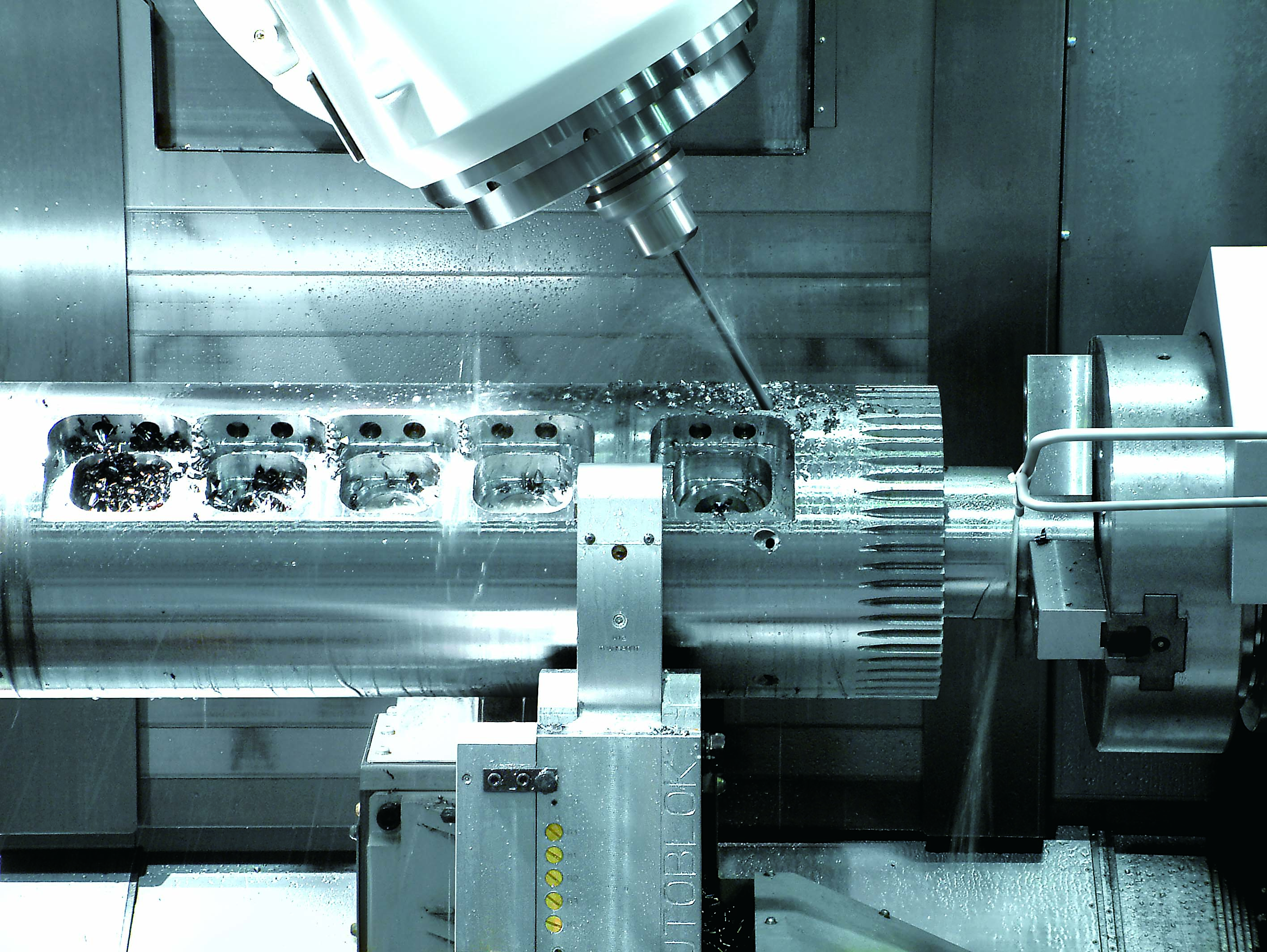

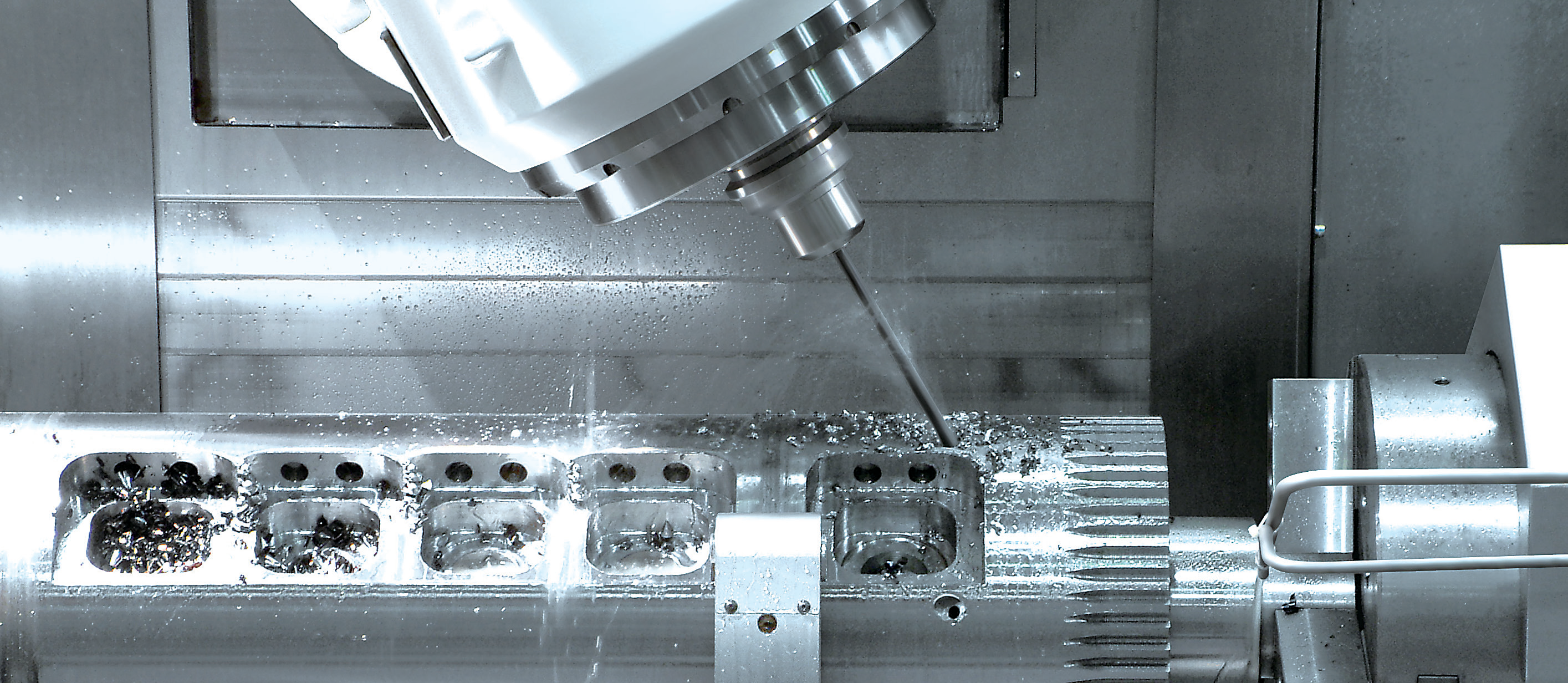

Mazak’s Integrex e-H multitask machine features a B-axis milling spindle with Y-axis capability. Image courtesy of Mazak
However, measuring parts during the machining process increases cycle time—a sacrifice that some users would rather not make.
These users “want their machine to make parts and chips, so they’ll take a part out of the machine and measure it while the machine is making another part,” Wilker said.
