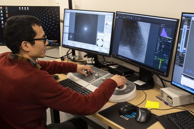

Xiaoqing He, a senior scientist at the Electron Microscopy Core Facility, works to adjust images from an electron microscope showing an experiment happening in real time. Image courtesy of Pate McCuien/University of Missouri
“The TEM is capable of letting researchers visualize reactions and material changes with up to atomic resolution, which is amazing,” he said. “But conducting experiments within a TEM environment is challenging because only small amounts of material will fit into a TEM chamber, and the system operates in a high-vacuum environment. Traditionally, researchers acquire TEM images of what a material looks like before and after an experiment, which leaves them to make an educated hypothesis about why and how a material has changed.”
