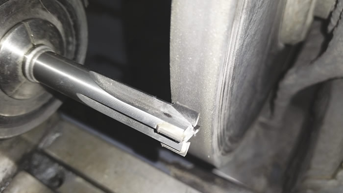

PCD reamers provide consistent results for a longer time than their traditional counterparts, because production does not have to be periodically interrupted to change worn tools. (Note: As with HSS and carbide, PCD edges can be sharpened to extend their working life.)
For a manufacturer engaged in steady production, a carbide tool might last a few days to a week, while a PCD tool could last for months.
Experience shows that during production reaming, the extended tool life a PCD reamer provides, along with reduced secondary operations, typically results in a cost per hole that equals 20 percent of the cost per hole when a carbide reamer is used.
In addition to high-volume-production facilities, job shops can achieve savings with PCD reamers. The reason is because a tool’s effective life is measured over the total number of holes reamed, regardless of the number of separate projects involved.
PCD reamers run at significantly higher speeds than carbide ones. A carbide reamer is usually operated at about 2,500 rpm, whereas PCD reamers need to run at 8,000 to 12,000 rpm to work effectively. In fact, PCD will actually produce lower-quality results when run at the speeds typically used for carbide reamers.

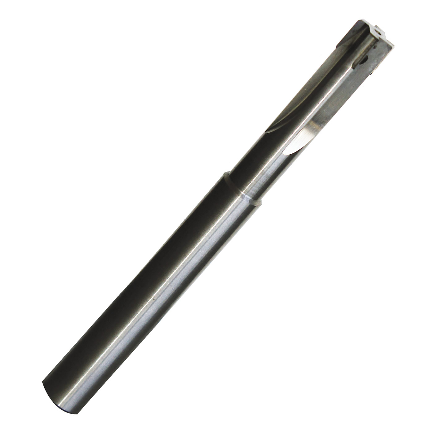

A 4-flute, through-coolant reamer is suitable for automotive applications.

For large-diameter holes, however, a PCD reamer can still run effectively at speeds as low as 6,000 rpm.
While the need for PCD reamers to run at higher speeds may make them unsuitable for some older machine tools, most equipment in active service today can handle the higher speeds. These speeds increase throughput and result in quicker delivery of finished parts to customers. In some cases, the heightened productivity justifies investment in a new higher-speed machine.
PCD reamers do have drawbacks. They cannot work ferrous materials, for example. But they can ream aluminum, brass, copper, carbide, bronze and abrasive materials, such as some of the advanced plastics used in aerospace and automobile manufacturing.
Moreover, PCD reamers can cost three times more than comparable carbide reamers. The higher cost deters some companies from even exploring the technology.
Another factor that has limited companies from adopting PCD reamers in the past has been their long delivery times—up to 14 weeks or more. This was partly due to low demand for the tools, which did not drive toolmakers to focus on more effective ways to produce them.
Today, however, thanks to growing demand and advanced production techniques developed by manufacturers of PCD tools, delivery times have been dramatically reduced. A standard PCD reamer can be delivered in 48 hours and specials in 3 to 4 weeks.
