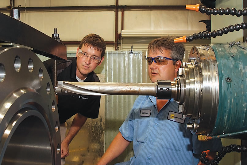

Steve Eldridge (right), shop superintendent for Sun Manufacturing Co., discusses the performance of Kennametal’s KSEM Plus modular drill (below) with David Hray, applications engineer at Kennametal.
According to Steve Eldridge, shop superintendent for Sun, the workpiece material isn’t particularly challenging to machine, having a hardness of about 212 to 235 HB and a tensile strength of about 75 ksi.

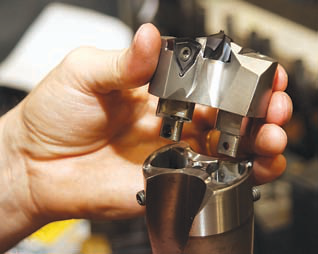

Sun searched for a solution and solicited quotes from toolmakers. After producing four spools with the spade drill applied for drilling the flange hole, Sun switched to the KSEM Plus modular drill from Kennametal Inc., Latrobe, Pa., based on the recommendation of David Hray, applications engineer at Kennametal. In addition, Kennametal’s tool cost less than the other drills that Sun Manufacturing quoted. The KSEM Plus modular drill consists of a steel body coupled to an indexable-insert, high-strength steel head, and a single tool body accepts a range of drill-head sizes.
Like the spade drill, the modular drill has through-coolant capability but that’s where the similarities end. Instead of consuming about half an hour to drill one hole, the KSEM Plus drill was able to produce a hole in 1.6 minutes. Plus, the spade drill caused chips to coil up after 1 ” to 3 ” of depth, whereas the KSEM Plus geometry generated small C-shaped chips that were easily evacuated. The drill’s differential-helix flutes enhance chip evacuation, according to Kennametal.
Sun was feeding the spade drill at about 1 ipm and was able to increase that tenfold with the modular drill. And feeding faster is possible with the appropriate machine tool. “We could have run at 12 ipm, but it turns out we didn’t have the horsepower,” Eldridge said, noting that a call to the toolmaker’s customer application support line yielded new machining parameters. “I plugged in the new numbers and we were running again in 15 minutes.”
