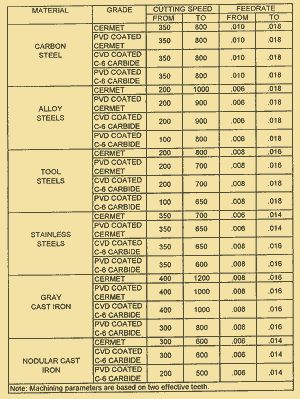

Table 1 lists the insert grades, speeds, and feeds that can be used to cut common ferrous materials. Nonferrous materials can be core drilled as well. Chemical-vapor-deposition (CVD)-coated carbides are available for general applications and operations that require toughness and wear resistance. Physical-vapor-deposition (PVD)-coated carbides are available for low-speed applications and operations that require toughness. PVD-coated carbides also are ideal for stainless-steel applications. More machinists are turning to cermet inserts for stainless steel because of the grade’s finishing capabilities and the ability to machine with cermets at higher speeds. Uncoated cermets are available to core drill a wide variety of materials in operations ranging from semi-roughing to finishing. New coated cermets are available for the semi-roughing to finishing of carbon steels, alloy steels, tool steels, and stainless steels. PVD-coated cermets combine the wear resistance of a cermet with the toughness of a carbide.

Table 1: Machining recommendations for core drilling various materials. Speeds are given in sfm, feeds in ipr.
