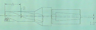

Another drill setup problem that can lead to poor drill performance and unacceptable hole quality is angular misalignment, where the centerlines of the drill and spindle are not parallel. When there are indications that the drill body is rubbing against the workpiece some distance behind the inserts, the user should suspect an alignment problem. Any misalignment between the drill and the hole becomes more pronounced as the depth of the hole increases. For example, if there is a 1° misalignment between the drill and spindle centerlines, the centerlines will be 0.017″ apart 1″ from the point at which the centerlines cross at the tip of the tool. This distance between the centerlines increases linearly as the distance from the intersection increases. At twice the distance from the intersection, the centerlines are twice as far apart (Figure 3).

Figure 3: With a 1° misalignment, the distance between the drill centerline and the spindle centerline increases linearly the further one measures from the point at which the centerlines cross (in this case, at the tip of the tool).

Figure 3 shows a situation in which the drill’s misalignment does not throw the center height off because the drill and spindle centerlines meet at the drill’s point. When the intersection is not at the point of the drill, however, center-height problems will result. The cause of a misalignment might be found in the machine tool itself or in the adapters or bushings that the drill is mounted into before the entire assembly is mounted into the machine’s spindle. To avoid introducing problems in the middle of a job, the user should check the drill’s angular alignment and radial runout whenever an adapter or bushing is changed.
