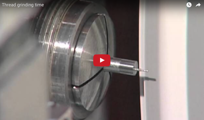

This short video provides some insight into the benefits and time savings afforded by a universal grinding machine. It is presented as supplemental information to Cutting Tool Engineering’s December 2011 cover story, “A Pitch for Thread Grinding.”​ Video courtesy of United Grinding.

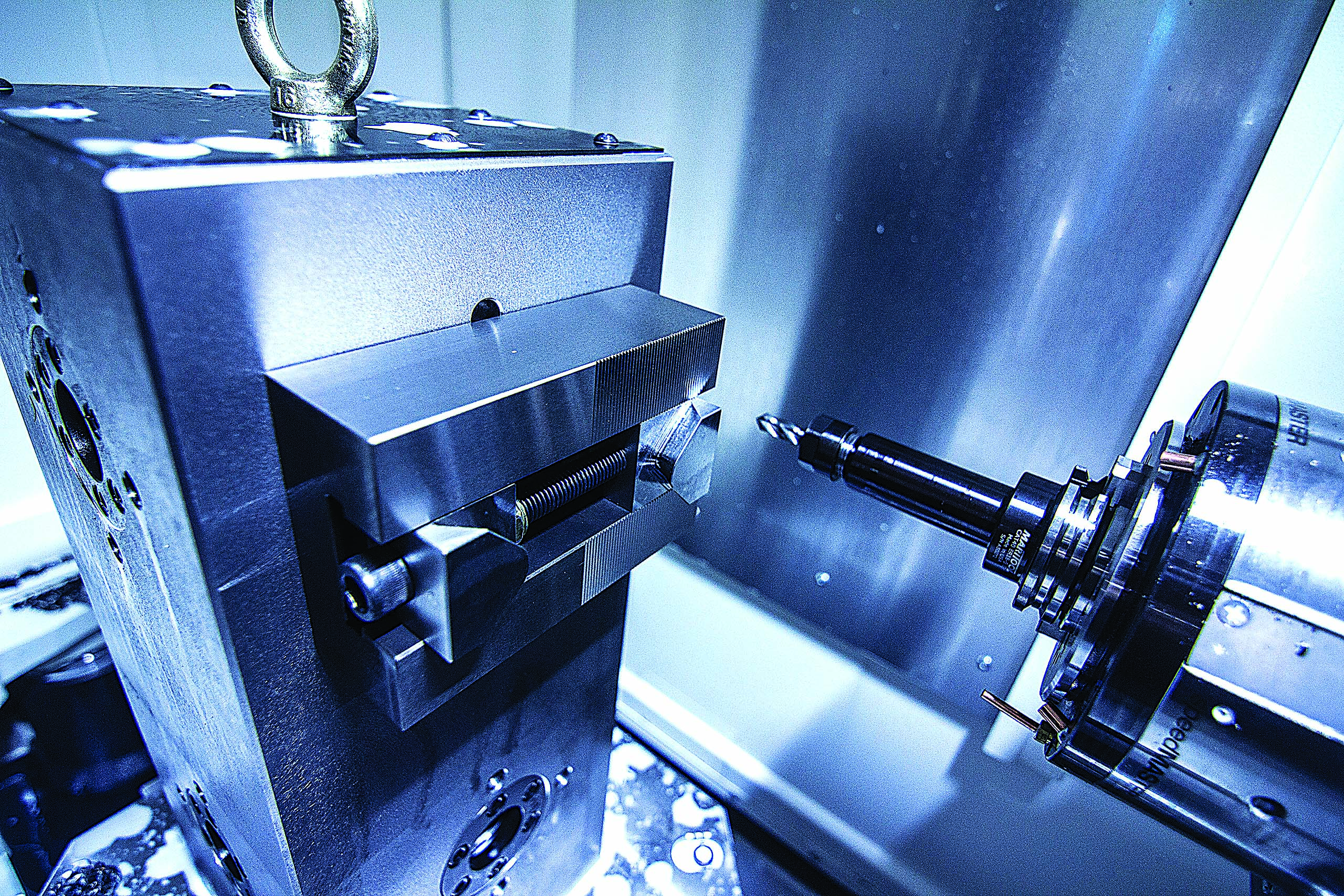

The work zone of a GS:TEM-LM (Mini) grinder (inset) from Drake is used for production-level thread grinding of parts from 0.5mm to 10mm in diameter and up to 100mm long.
