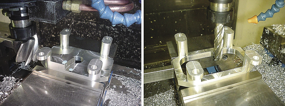

- One of the first and simplest things to look for when performing operations that involve vises is the length of the contact area between the part and the vise jaws. In general, choose the longest contact area possible. Figure 1a shows a setup made as rigid as possible before any material is removed. Initially, aggressive cuts can be made with high feed rates to remove material. As the “window” cut (Figure 1b) nears completion, the part becomes much weaker, and lighter cuts must be taken. These types of machining scenarios are common and must be planned in advance.

Figure 1a (left): This setup was chosen based on using the longest contact area possible with the vise jaws.
Figure 1b (right): As the “window” cut nears completion, the parts become much weaker. Lighter cuts must be taken at this stage.
Images courtesy J. Harvey.
