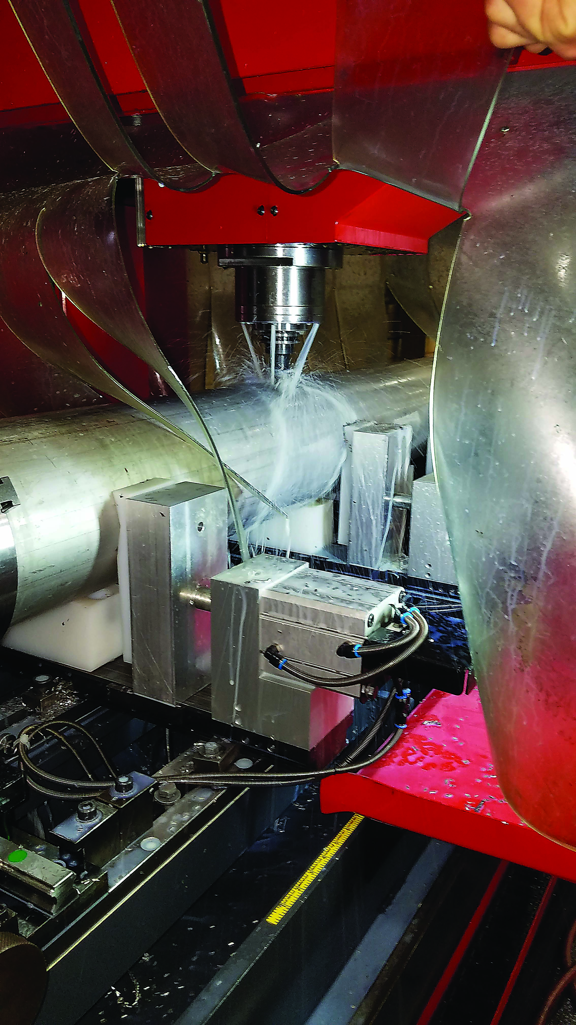

Felker Bros. estimates that when it drills 5⁄8″ holes every 8″ in 4″-dia. pipe for a 21′ length on its TRD 35-02, drilling time is reduced 50 percent compared with the previous method. Images courtesy of FlexCNC

Previously, with its drill press, Felker Bros. followed a multiple-stage process in which an operator would mark and manually drill holes, slide the pipe through a fixture to the next position, clamp it and repeat the process position to position throughout the entire pipe length while making sure that everything was perfectly level and in line. Profiling was done on vertical CNC mills.
The TRD 35-02 machine from FlexCNC drills, mills, taps and bevels large or long parts in one setup. Images courtesy of FlexCNC
The TRD 35-02, however, drills, mills, taps and bevels in one setup. As a bonus, the manufacturer eliminated a machining center, as the new machine does the work of multiple machining centers.

Now, someone programs a part and sends the program to the machine. An operator sets the pipe inside the machine with the proper fixturing and calls up the program. Whether it’s one hole or 30, the open-bed mill does the heavy drilling. A fourth axis rotates to handle profiled or other holes on some of Felker Bros.’ most difficult parts with 180° rotation from the original holes. The operator deburrs the pipe before removing it and replacing it with a new pipe for drilling.

The plant handles pipes from 3″ to 14″ in diameter and up to 35′ long. The majority of the stainless steel pipes are 4″ in diameter and 21′ long and require 5⁄8″ to 7⁄8″ holes. Felker Bros. estimated that when it drills 5⁄8″ holes every 8″ in 4″-dia. pipe for a 21′ length, drilling time is reduced 50 percent compared with the previous method.
In addition to saving time and increasing sales, hole and hole location accuracy are higher than with the manual process. Demands and parts vary from day to day, but saving half the time it previously took to drill a pipe could equal drilling twice as much pipe each day.
