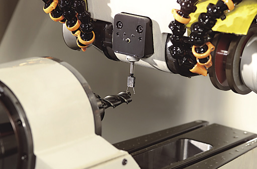

mazak Penske 4.tif
Courtesy of Mazak
Penske Engines machines cylinder heads complete using a special fixture on a Mazak multitask machine.
mazak Penske 5.tif
Courtesy of Mazak
Each cylinder head requires about 50 small holes, which are produced using through-coolant carbide tools and high-pressure coolant.

Penske uses a Mazak Integrex e410 multitask machine for cylinder head machining and Mazak machining centers for engine block production, according to Rick Huneycutt, machine shop supervisor. "For cylinder heads, we produce maybe 50 small holes using Kennametal tooling on the multitask machine," he said. "That includes drilling and tapping of a lot of mounting holes to attach the head to the block using through-coolant tools and high-pressure coolant."
The team receives engine blocks from Dodge with oil holes and other high-aspect ratio holes already machined, so complex holemaking on blocks is limited to some boring, Huneycutt added.
