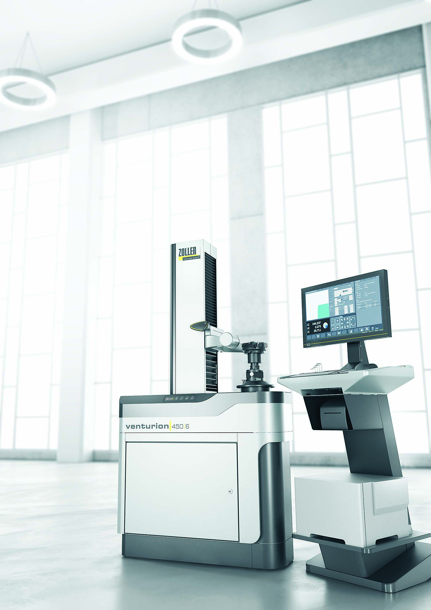

The venturion 450 presetting and measuring machine is billed as a good choice for Industry 4.0 manufacturing systems.
The venturion 450 presetting and measuring machine is billed as a good choice for Industry 4.0 manufacturing systems. Image courtesy of Zoller
The impact of this reduction on machine downtime can be huge. If a tool presetter can increase a shop’s spindle utilization by 40%, for example, the result could be a doubling of the shop’s production capability without a major capital investment, said Michael Colyer, key accounts manager at Zoller Inc. in Ann Arbor, Michigan.
He pointed out that cost analyses done by Zoller for most of its presetters at shops that have five or more machine tools usually show a return on investment in less than half a year.
“With an ROI of less than six months and the ability to significantly increase your business and the amount of throughput, in my mind (using a presetter) is a no-brainer,” Colyer said.

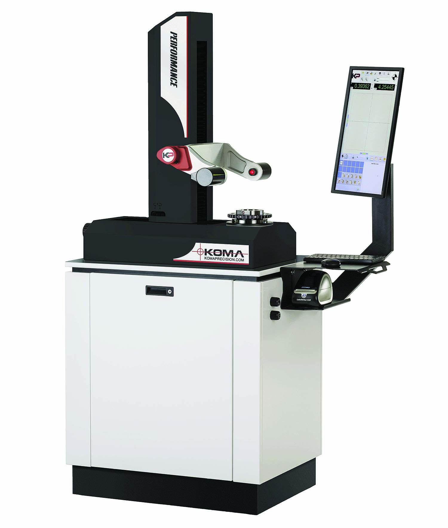

Tool presetters are suitable for all machining applications but excel in environments where tool magazine changeouts are frequent, said Andrew Esposito, vice president of sales at Koma Precision Inc., a presetter supplier in East Windsor, Connecticut.
“The more tools that get swapped out, the more of an advantage a tool presetter is,” he said.
Tool presetters come in a variety of types with a wide range of features and price points. At one end are basic, lower-cost manual presetters while at the other are presetters equipped for fully automated toolrooms.
In a simple process involving a presetter, Bied explained, shop personnel measure each tool for a particular job and print a label with the information that’s affixed to the tool. Then the measured tools are placed on a cart and wheeled over to a machine tool, where an operator keys offset data for each tool into the machine control and places the tools in the machine’s magazine.
Features of the Performance presetter include an ergonomic design and easy-to-use software.
Features of the Performance presetter include an ergonomic design and easy-to-use software. Image courtesy of Koma Precision

He said Zoller’s presetters can measure just about any tool parameter that a shop wishes to measure, including length, diameter, angularity and the nose radius of inserts, as well as rotational tool characteristics, such as runout. Accurate runout measurements are particularly helpful to shops that use cutter compensation to adjust processes for potential runout, he said.

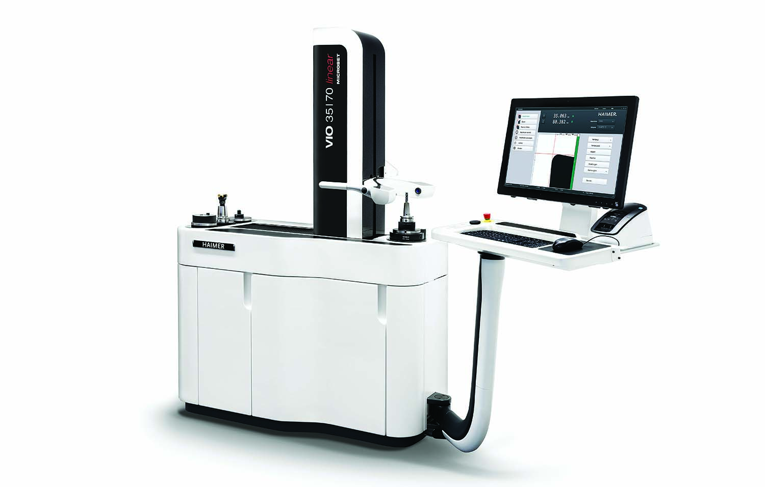

Offering customizable options, the Microset VIO linear is a fully automatic tool presetting system.
Offering customizable options, the Microset VIO linear is a fully automatic tool presetting system. Image courtesy of Haimer USA
Rather than guessing at it, “now they know exactly what the runout of the tool is and what diameter a tool is going to cut,” Colyer said. “This is a huge benefit, especially if you’re machining precision-type parts.”
He said since Zoller’s tool presetters accurately measure rotational variables like runout, the presetters allow operators and toolcrib attendants to spot possible trouble before tools are loaded into a machine. This includes problems that can reduce tool life, such as tools that are set incorrectly in holders, and issues that can cause costly in-process tool breakage. Moreover, he noted that simply presetting tools within their manufacturing standards can boost tool life by up to 20%.

Bied said Haimer also has supplied presetting equipment for robotically automated tool assembly cells in which everything is done without operator involvement. The company introduced presetter technology suitable for such cells at the EMO trade show this year.
While tool presetting systems for highly automated processes can cost $50,000 and up, he said lower-end manual presetters might set back shops only about $15,000. Still, he said some shops with machine tools equipped with tool presetting features balk at spending anything for a separate presetting device.
