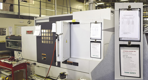

Sterling’s program uses physical logs on the side of each machine, based on OEM maintenance requirements. The shop monitors coolant level and viscosity and oil levels in all areas of the machine once a week, cleans the coolant tank and changes filters yearly and checks and addresses everything on an as-needed basis every morning during machine warm up. The system has effectively eliminated any machine downtime caused by poor maintenance, according to Lowe.

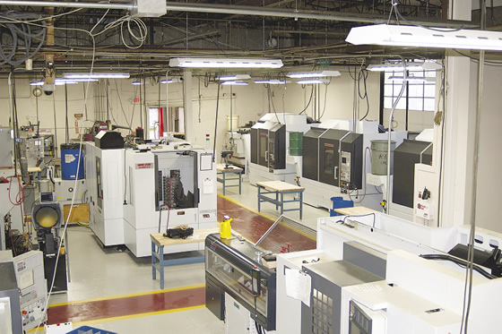

In addition to regular maintenance on the machines themselves, Sterling Instrument keeps its shop as clean and free from clutter as possible.

“Some machines we’ve purchased have come with suggested maintenance schedules,” said Stark Industrial’s Wilkof. “Those are very good, but the problem is that when we examined them, none of the forms matched—there was no consistency. The forms for different machines all had different information, and each one had to be filled out differently each time maintenance was performed.”
Courtesy of Sterling Instrument
Sterling Instrument keeps physical maintenance logs on each of its machine tools.
To address this, Stark collected all of the schedules and created a standardized, written maintenance log for all its machines. These logs include maintenance activities, the frequency at which they needed to be performed, explanations of each task and, if available, images from the machine’s manual to eliminate guesswork.

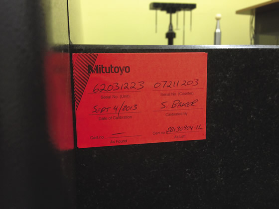

Courtesy of PTooling
Stickers, like this one on a Mitutoyo machine tool, allow PTooling to efficiently—and visibly—track maintenance schedules.

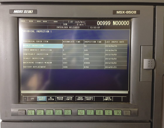

Displays, like on this Mori Seiki MSC-850III CNC, give operators a running reminder of pending maintenance tasks.
