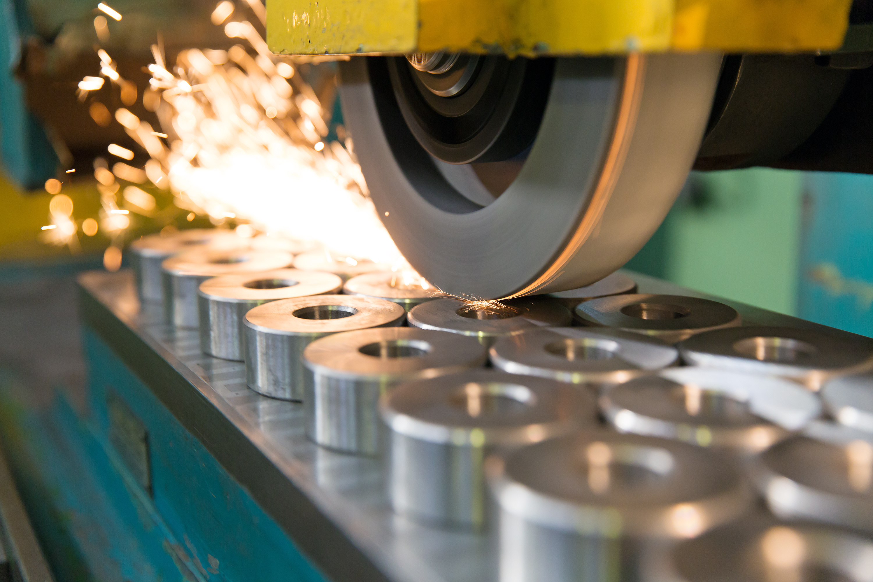

Producing a part with a silky smooth, bright appearance is regarded as a mark of expertise. Image: Cutting Tool Engineering
