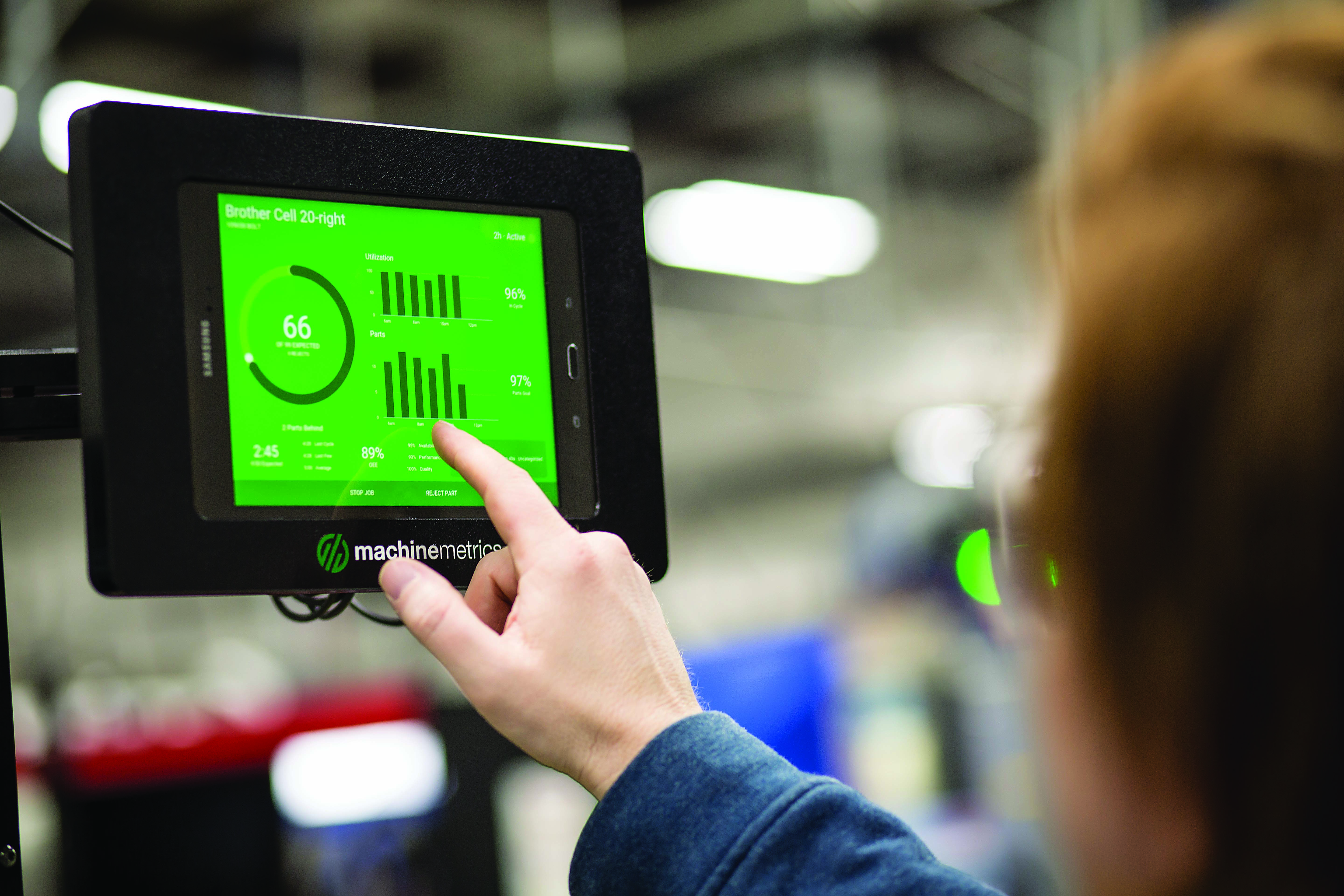

A MachineMetrics tablet is magnetically mounted onto a machine tool and displays the operator view, where operators can categorize downtime and track quality and jobs. Image courtesy of MachineMetrics.

Within about a month, MachineMetrics implemented a machine monitoring system at Northeast Tool. Now, tablets mounted to individual machines display job performance and provide operators with an interface that categorizes downtime, setups, part rejections and tool changes. Throughout the facility, large-screen dashboard monitors display job performance against Northeast Tool’s production goals, with a green tile showing that a machine is producing within its target and a red tile indicating that a machine isn’t. In addition, instant text notifications enable production managers to immediately identify underperforming machines and quickly address issues.
