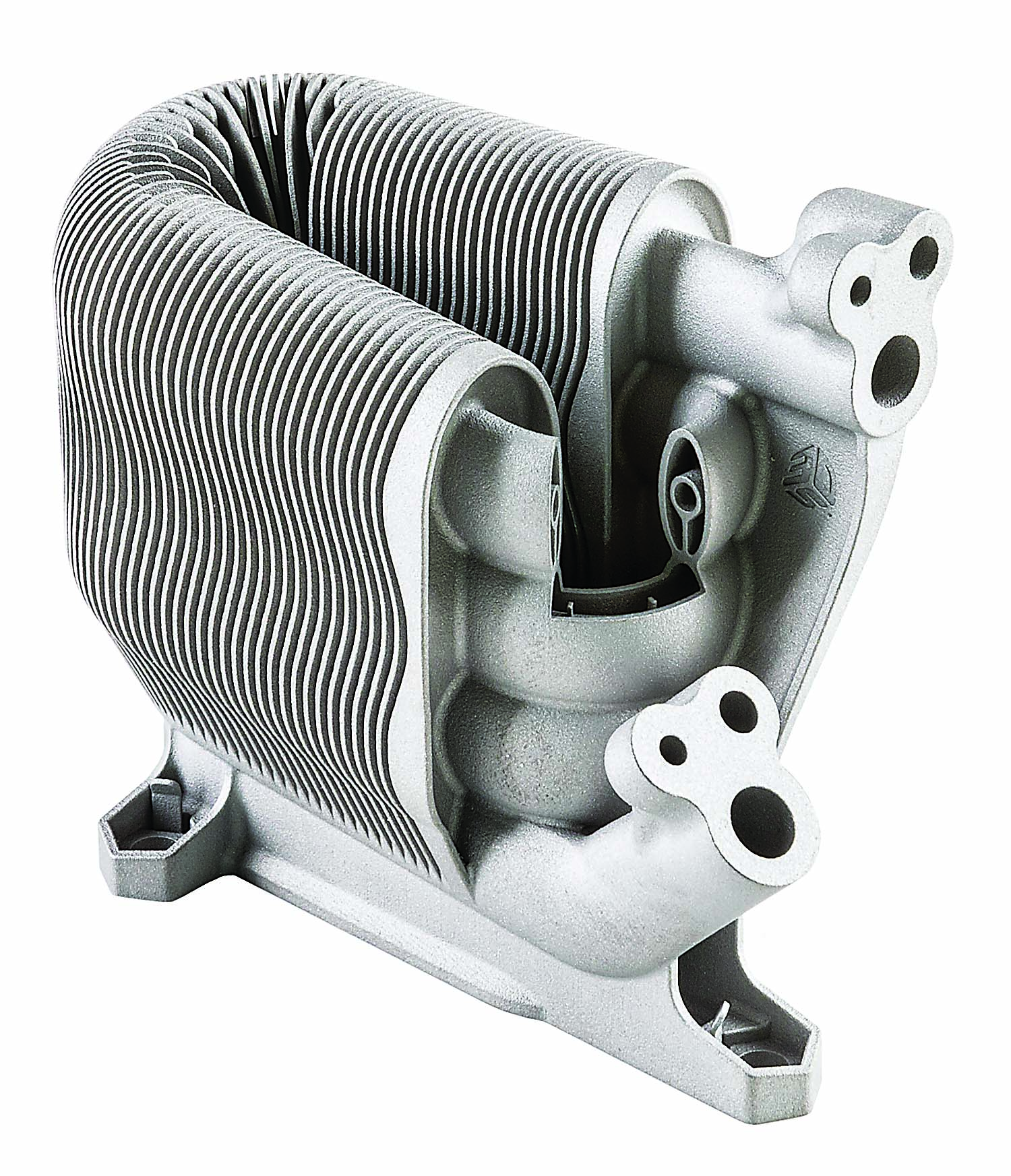

This stainless steel lamella heat exchanger was designed for restricted space in an assembly. Additive manufacturing enabled the inclusion of encapsulated conformal internal channels, as well as integrated turbulators to improve the heat transfer coefficient, and reduced the part count from 40 pieces to one. Image courtesy of 3D Systems

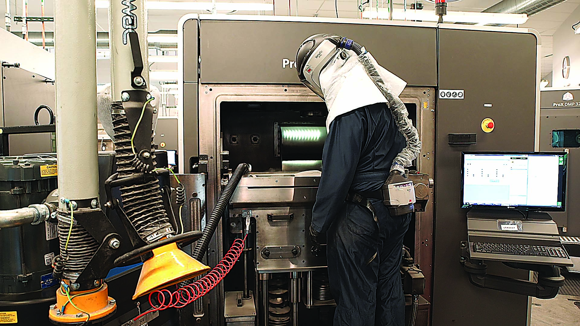

Maple Plain, Minnesota-based Proto Labs Inc., which does business as Protolabs, does not build 3D printers—metal or otherwise—but sure uses a lot of them. Joe Cretella, application engineer at Protolabs’ Morrisville, North Carolina, facility, noted that the company owns 25 of Concept Laser’s high-resolution metal powder bed printers, 24 more than when he began working there seven years ago. “We’re definitely seeing a greater call for 3D-printed metal prototypes,” he said. “It’s one of the fastest growing segments of our business.”
Supporting that many printers requires significant machining capabilities. That’s because 3D-printed metal prototypes need more secondary processing than their polymer counterparts. The metal scaffolding used to support parts and keep them from twisting and warping during the printing process must be removed, either manually with a hand-held grinder or machined away in one of the company’s CNC machine tools.

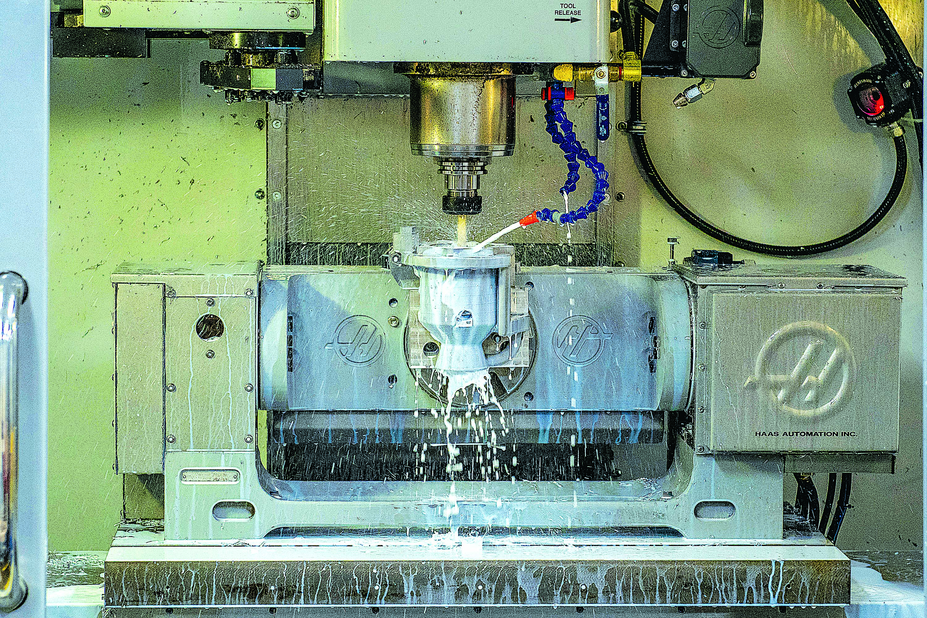

Similarly, the surfaces of 3D-printed metal parts are typically rough—similar to that of a sandcasting—and must be milled or turned if a smoother finish is specified. Holes are often reamed, bored or threaded. Features with tolerances in the neighborhood of ±0.005″ or less must be machined, depending on the application. Heat treatment to remove thermally induced stress is also needed; plus, bead blasting to remove surface irregularities is common.

Machining the surface of a 3D-printed metal part at Protolabs. Image courtesy of Protolabs

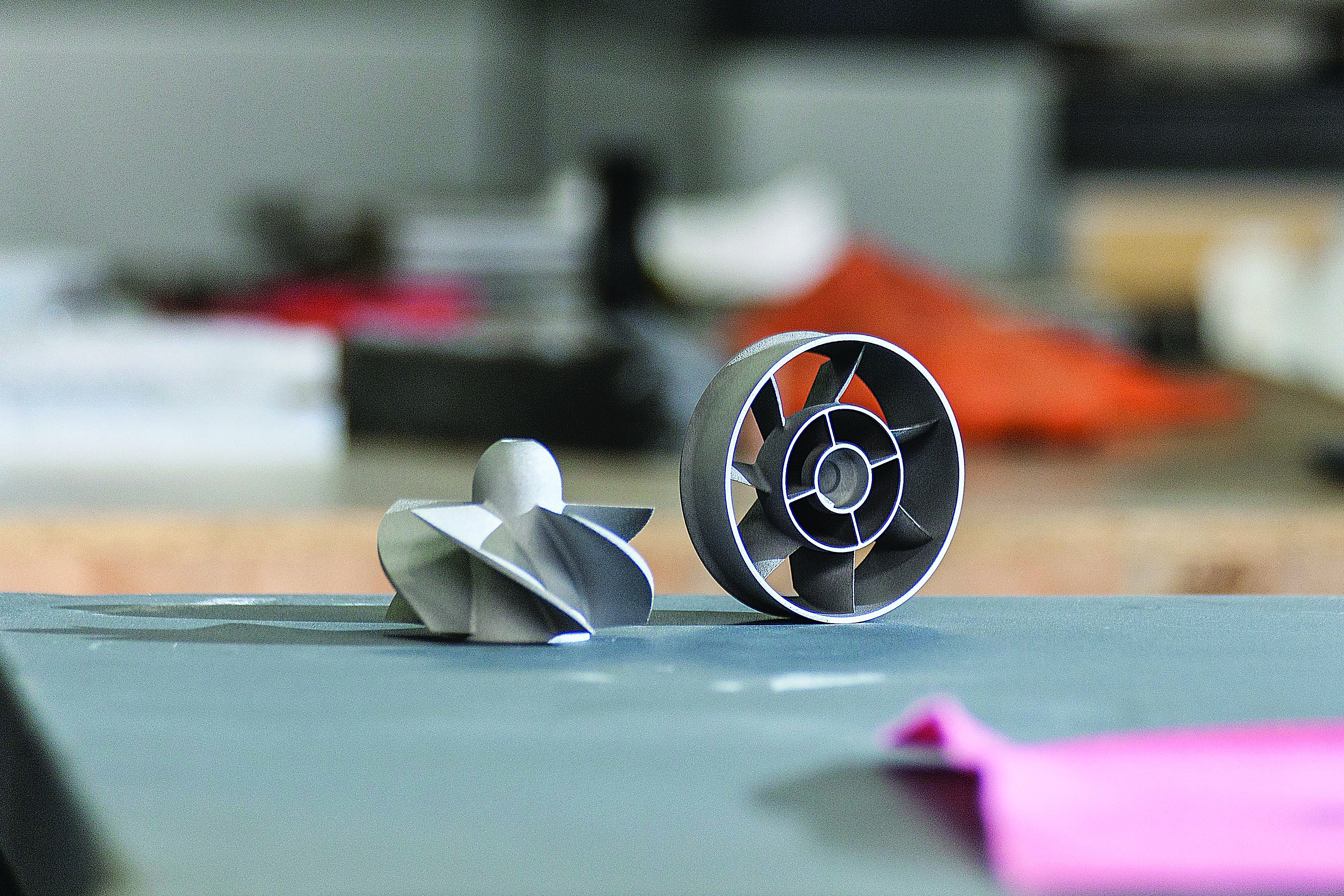

Now take that same plate and hollow it out with a honeycomb pattern or fill it with a series of square holes, and almost any CNC machine shop would immediately no-quote such a job, whereas a shop with a metal powder bed printer thrives on such complex work. Undercuts and inaccessible recesses; thin walls; weird or intersecting angles; free-form “organic” shapes; meshes; helices; and bonelike structures are common fare for any 3D printer.
“That’s one of the first things I see when a new customer is reviewing whether DMLS is right for them,” Paulsen said about a common style of metal powder bed printing. “They’ll throw a $12 part at it that they’ve been making for years and are surprised when it costs $400 to print. Yes, you can build practically anything with a 3D printer, but unless the part is actually designed with 3D printing in mind, the results will probably be disappointing.”
So how do you know which parts—prototype or otherwise—are best for 3D printing? Every workpiece is different, but remember that metal powder is relatively expensive, as are the lasers used to fuse it. If a part is not “blocky” or monolithic, contains one or more of the complex features listed earlier or is difficult or even impossible to machine, it’s probably a good fit for AM.

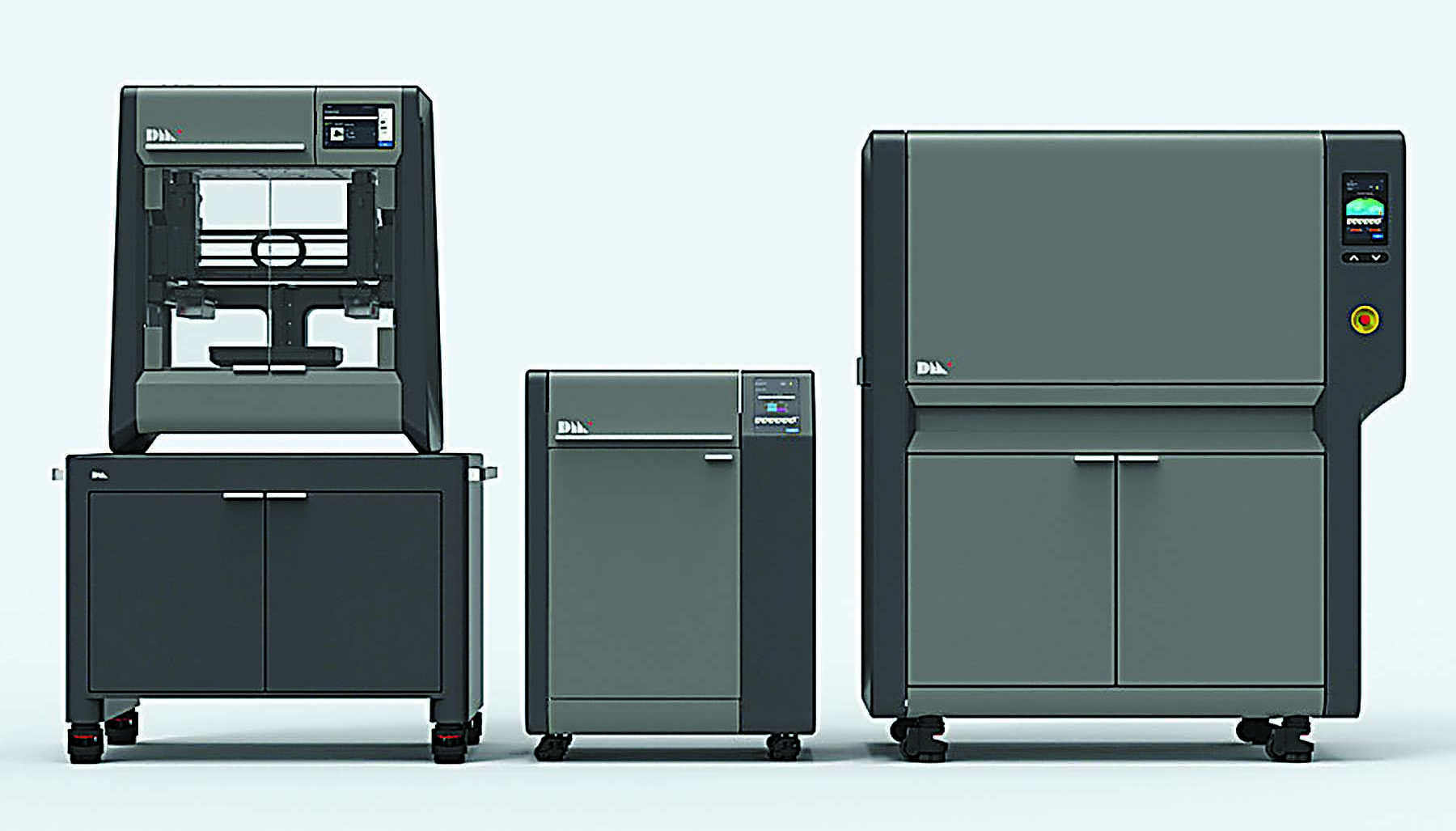

The Studio System eliminates lasers and loose powders often associated with metal 3D printing, making it safe to use at any facility. Image courtesy of Desktop Metal
“One of our first customers was Milwaukee Tool, who came to us for help with an auger bit that they’ve been producing for many years,” he said. “Using our Production System, we were able to take their existing 17-step manufacturing process and reduce it to just four steps, delivering a 15% cost savings on a product that sells at a rate of roughly 10 million units annually.”
The Production System works much like the company’s prototyping printer, known as the Studio System. As with powder bed machines, the Production System lays down individual layers of metal. But instead of using a laser to sinter them, a polymer binder is applied to hold them together until printing finishes. The Studio System, on the other hand, extrudes rods of metal powder mixed with polymer and a wax binder, similar to how an FDM-style printer works. In either case, the “green” workpiece is placed into a de-binding station before being sintered in a furnace. The result is a homogenous, fully dense metal part no different from one produced with the MIM process.
