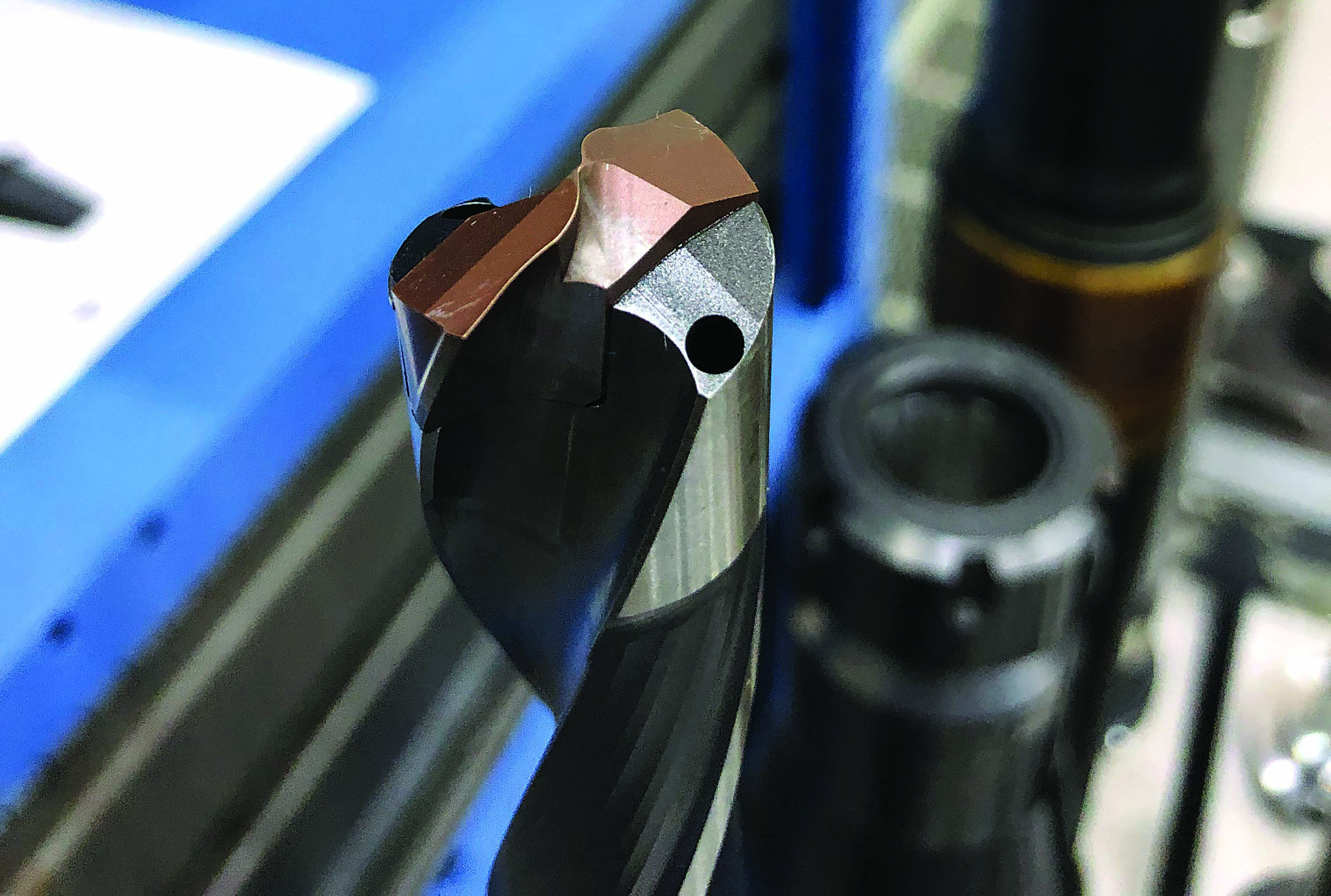

Replaceable carbide tips are molded so they conform to the shape of the drill body. Image courtesy of C. Tate
Drilling as most people know it dates to Stephen Morse’s invention of the twist drill, which was patented in 1863. Although drills had been manufactured for centuries, his twist drill design is the most familiar and the basis for many modern drilling tools. This was a major change. Now, a person could drill vertically and still evacuate chips without re-cutting them.

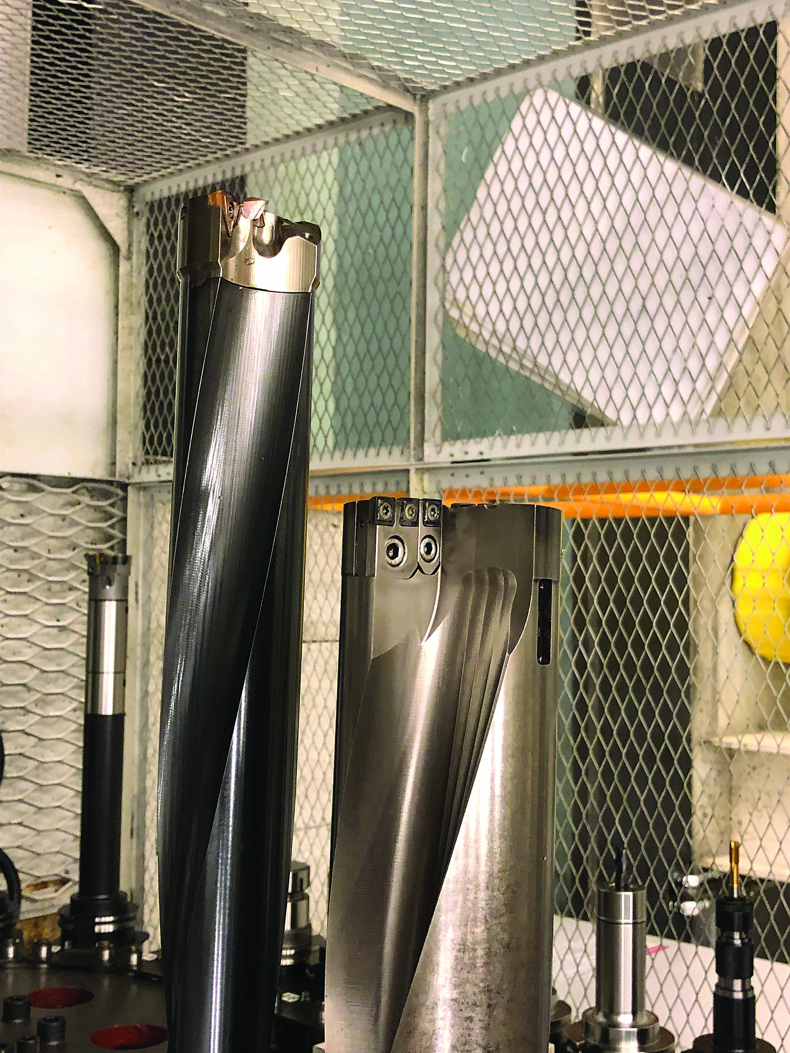

Indexable carbide-insert drills have become common cutting tools, as they offer several advantages. Indexable drills have penetration rates that are four to five times greater than HSS drills, resulting in faster cycle times. Carbide inserts also extend tool life compared with HSS tools, especially when cutting difficult-to-machine materials.
Selecting the appropriate drill design
Indexable carbide inserts offer long life, high performance and easy edge renewal. Image courtesy of C. Tate

Improved tool life and the ability to index, or turn, an insert without removing the cutter from the machine reduce the costs associated with cutting edge renewal. Indexable drills also allow end users to start holes on irregular surfaces where other types of tools would have difficulty starting. Unlike large HSS drills, indexable drills require pilot holes.
As indexable drills gained popularity, tool manufacturers began to expand the technology by developing drills with replaceable carbide tips. Replaceable-tip drills are similar to indexable-insert drills and provide many of the same benefits, such as an increased penetration rate, long tool life, low maintenance requirements and reduced inventory costs.
The major distinction is in their design. Instead of holding multiple carbide inserts in pockets on a steel body, replaceable-tip drills accept a single carbide tip on the end of a steel body and resemble the trusty twist drill. Applying a replaceable-tip drill improves hole size and finish compared with an indexable drill.
Manufacturing small multiple-insert indexable drills is difficult because they are fragile and there is a limit to how tiny they can be. There was a time when small indexable drills were not available. Shops were forced to buy more expensive carbide drills, accept the limitations of HSS drills or employ extra machining operations when the needed size of an indexable drill was not available. Replaceable-tip drills eliminated this gap and provided the benefits of indexable insert drills in smaller diameters.
