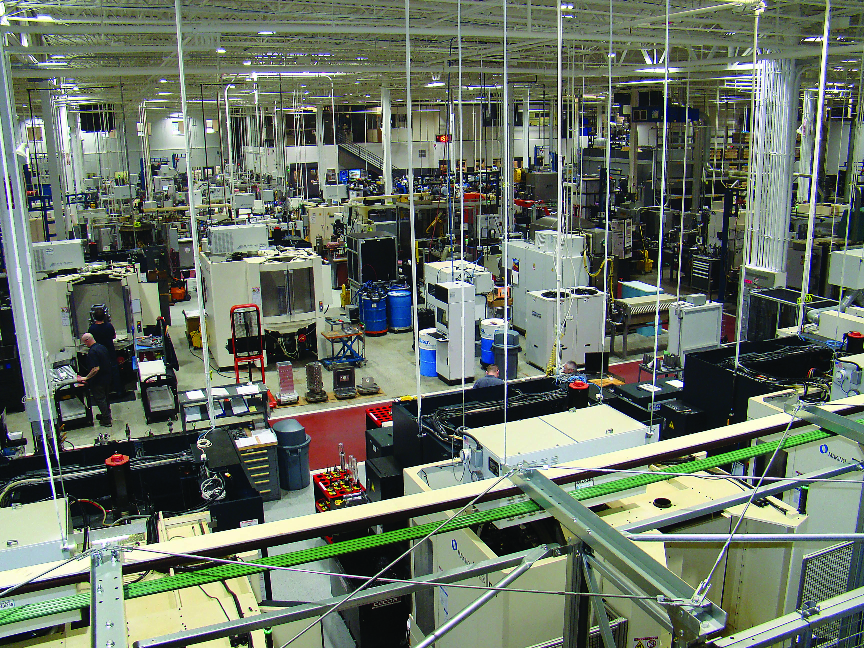

An overview of Camcraft’s machine shop, with the MMC2 automated pallet-handling system in the foreground and the two stand-alone Makino a51nx HMCs across the aisle. All images courtesy of Alan Richter

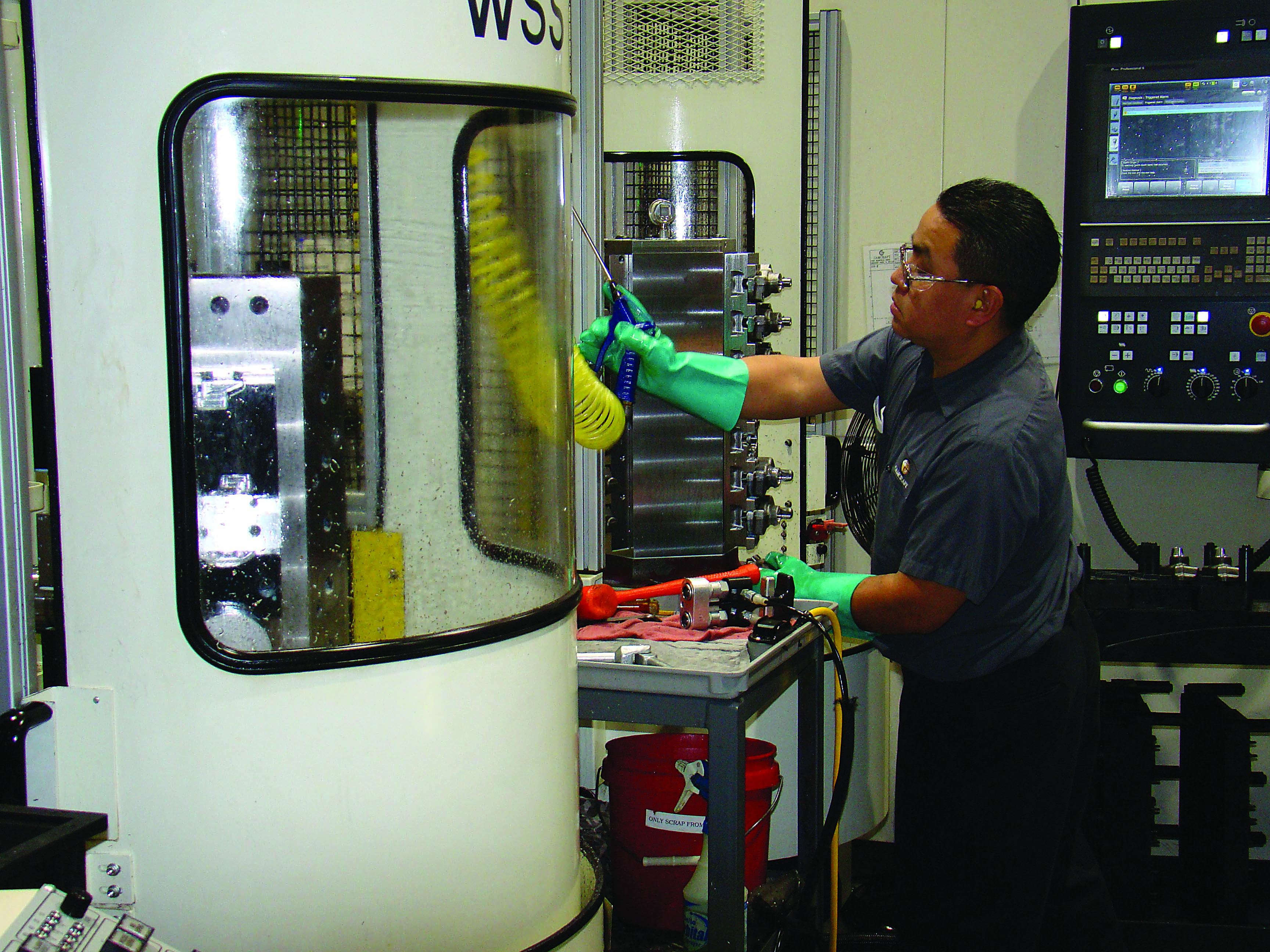

An operator loads workpieces into one of the MMC2’s two work-setting stations.

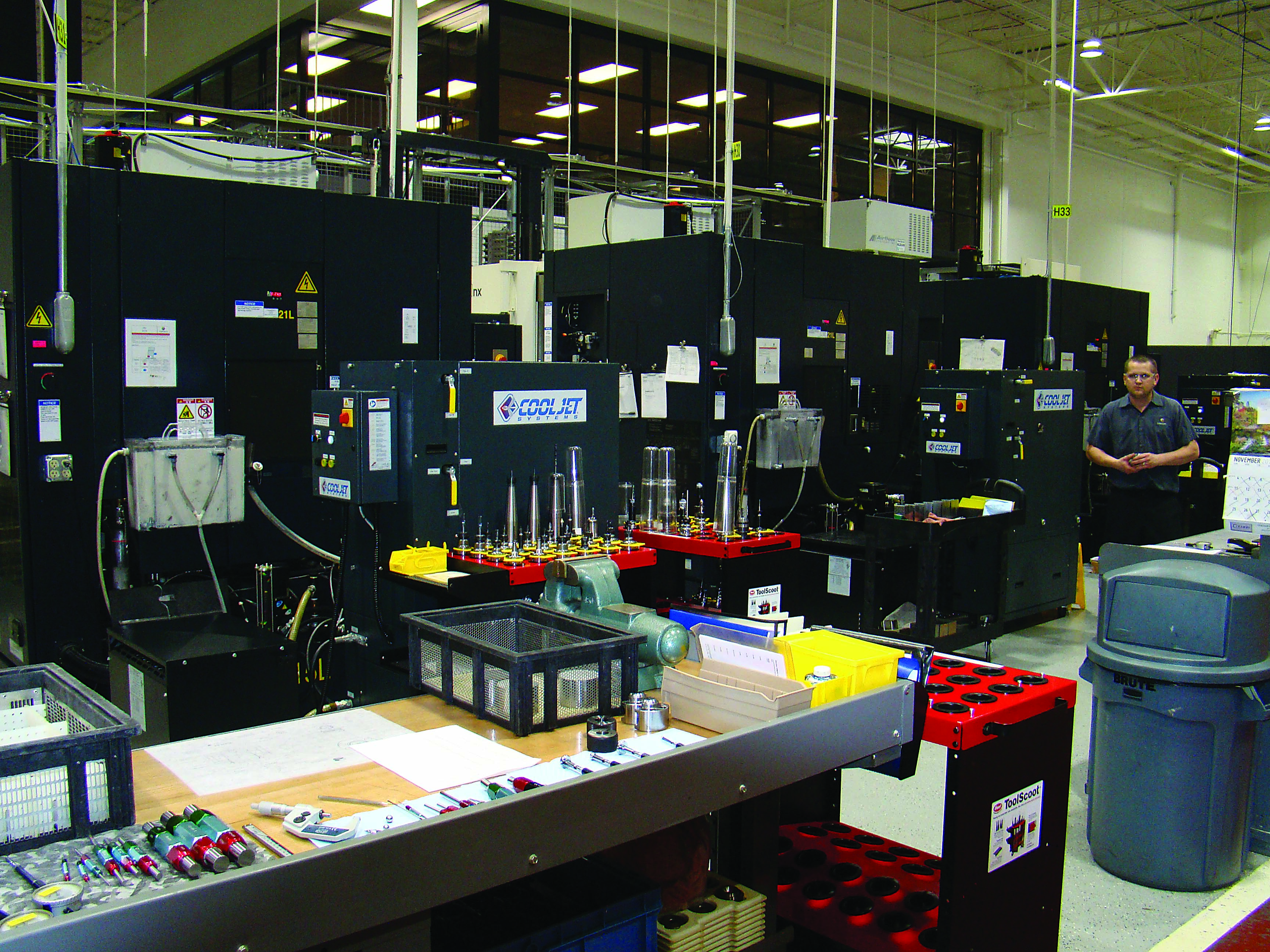

Although it is not a mandatory element, he added that Camcraft developed an independent cutting tool presetting system for the MMC2. “If you’re looking at 95 percent spindle uptime, how are you going to get that without having tools prepared and ready to go?” Ksel asked.
Makino reports that its MMC2’s work-setting stations provide easy access for operators to load and unload parts either by hand or crane. Each WSS has 180° pivoting doors to save space and prevent a cluttered work area.

Camcraft’s system has two stations for loading workpieces. “I only needed one but added the second one just in case,” Ksel said. “Thank God we did, because we are running a bunch of different parts. Everything going to one loading station would be overwhelming; we couldn’t load parts fast enough. Sometimes it takes a while to load parts, depending on cycle time, fixturing design and load time. The loading area can be very busy.”

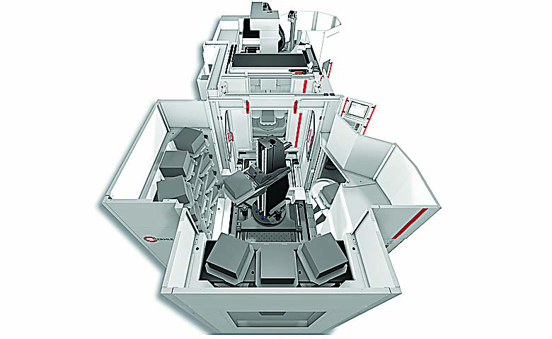

The HS flex handling system is designed to fit the Hermle 3-axis and 5-axis Performance Line machining centers and High Performance Line models. Image courtesy of Hermle USA
The system is designed to fit the Hermle 3-axis and 5-axis Performance Line machining centers (C 250 and C 400) and High Performance Line models (C 12, C 22, C 32 and C 42). Nonetheless, customers frequently ask if the system can be adapted for machines from other builders, Schnitzer noted. “It is available only for Hermle machining centers.”
The rotary, lifting and linear axes of the handling unit enable precise movement of workpieces up to 450kg (including the pallet) among the setup station, the storage modules and the machining center’s working area, according to the company. The maximum pallet size is 500mm × 400mm.
The system comes standard with one storage module. A second module is optional. Modules are structured as racks to enhance customization of the pallet and workpiece arrangement, Hermle reports. Up to four rack shelves can be ordered for up to 25 pallet storage spaces per module, providing as many as 50 storage spaces when two modules are installed.
The company introduced an active pallet gripper for the system in April. That gripper can move and accept pallets with various shapes, unlike the inactive gripper that accepts pallets that are the shape of the gripper, Schnitzer said. Users have the option to change the gripper on the system.
