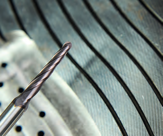

In machining a mold for a truck’s interior panel, Prospect Mold applied advanced tools to maximize its competitiveness. The P-20 steel mold was about 80 ” long × 45 ” wide, and the mold cavity required metal removal to a depth of about 4 “. In addition to other contours and details, the cavity was crisscrossed with more than 750 linear inches of 0.090 “- to 0.100 “-wide × 0.400 “- to 0.900 “-deep grooves to create reinforcing ribs on the back of the molded plastic part. The groove sidewalls featured 2° of draft, or inclination, to allow the panel to release from the mold.
Courtesy of OSG
Prospect Mold replaced a three-step EDM process with one machining operation using rib-cutting endmills from OSG Tap & Die and reduced the time needed to machine narrow grooves in a large mold.

Prospect Mold looked for ways to save time and reduce the cost of the rib-cutting process. The shop investigated applying endmills from OSG Tap & Die Inc., Glendale Heights, Ill., engineered to cut narrow grooves. Gregg Townsend, OSG regional manager, said the toolmaker presents training seminars across the country discussing new machines, workpiece materials and tools. Among the topics is rib cutting because “it is very important and occurs quite frequently in moldmaking,” Townsend said.
The submicron-grain-carbide endmills for cutting ribs have a 5μm radius accuracy, according to OSG.
When Prospect Mold applied 2.0mm- and 2.5mm-dia. OSG Exocarb-SHP rib cutters with flute lengths of 16mm and 25mm to the panel mold, the time required to produce the rib grooves fell to just under 100 hours.
In addition to the time savings of more than 60 percent, using the cutters simplified the mold production process. “If you can eliminate three steps by doing one, instantly you are ahead of the game,” Shroyer said.
Another factor in the success of the job was that the endmills could be run at higher than a 300-ipm feed rate with acceptable tool life. Finally, because the machined surface didn’t have a recast layer from EDMing, polishing time was cut in half.
