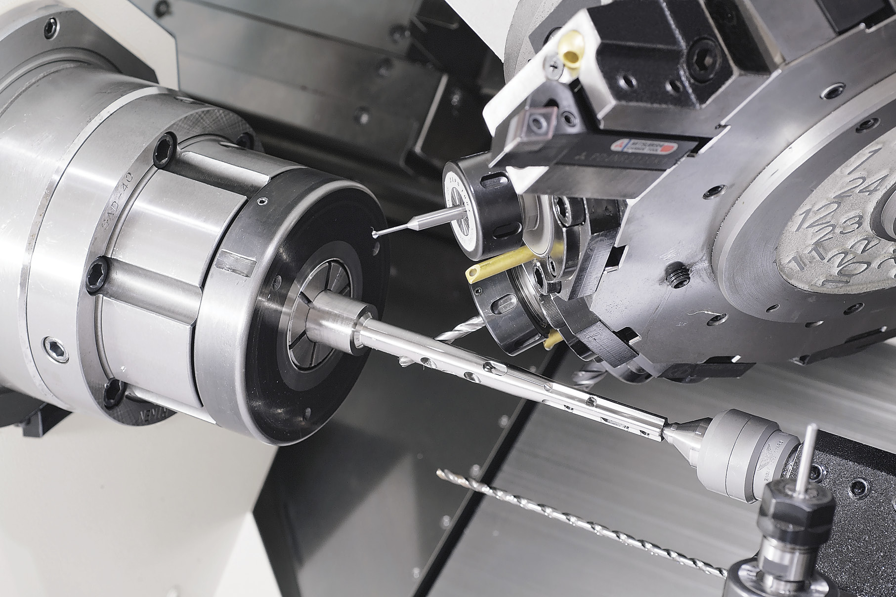

Multitask machines, such as this Nakamura-Tome NTJ 100 with a B-axis upper turret for machining features at any angle, are going to continue to grow in popularity as manufacturers push to increase productivity. Image courtesy Methods Machine Tools.
