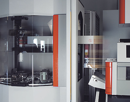

Sometimes turning center automation doesn’t involve a robot. That’s the case with EMAG’s inverted spindle design, which is an integrated, self-loading turning machine concept where end users do not need robotic handling devices, according to Peter Loetzner, CEO of machine tool builder EMAG LLC USA, Farmington Hills, Mich. “The core feature is the pick-up spindle, which travels outside of the machining area, picks up the part, brings it inside, does all the machining and unloads it all by itself,” he explained.
The inverted spindle is on EMAG’s VSC, SLC and VL series vertical pickup turning machines. Loetzner added that all moving automation parts and accessories are outside the cutting area and on top of the machine, which helps keep the machine envelope clean and maintenance free.
An end user could add a robot with a camera to take parts out of a bin and load them into the automation equipment, but if the parts are manually loaded into the carrier prisms, then the end user doesn’t require accessory robots or any other external components, Loetzner noted. In addition, the universal carrier prism design allows the machine to accept a range of parts without any changeover requirements or fixturing or palletizing of parts, according to Loetzner. If needed, inexpensive pilot pins or pallets of a simple design can also be used as a standard automation solution.

Courtesy of EMAG
EMAG’s recirculating, prism-type loading frames—the carrier prisms—take components to and from the pickup station and require no resetting. They accommodate workpieces with different sizes, shapes and diameters.
