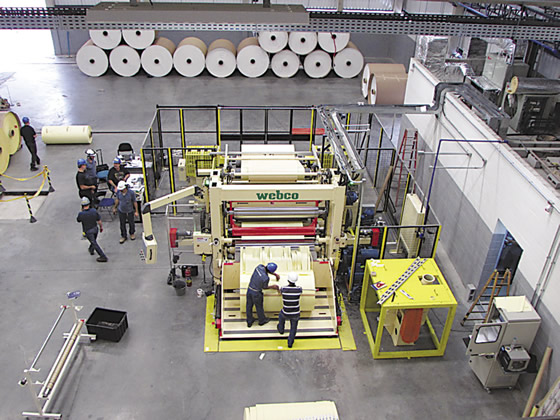

Folding Guard partitions ensure equipment at Brazilian automotive manufacturer Webco are up to all current safety codes.

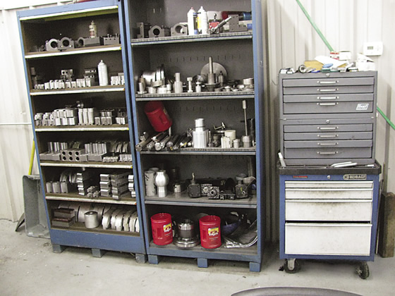

A well-defined organizational system—and ensuring employees stick to it—keeps parts and tools from cluttering the shop floor at Crow Corp.
Ultimately, though, he admitted that a shop can hang as many posters, conduct as many safety meetings and mandate as much training as it wants, but accidents still happen. Jennings said: “It doesn’t matter how careful you are, human beings just do goofy stuff, even when they know better. So, another part of our plan is to make sure our managers and supervisors are well-trained. That way, when they see employees being careless or unsafe, they can hopefully step in before an incident occurs.”

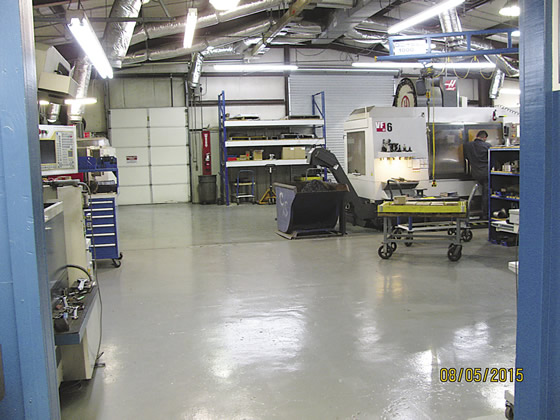

The other pillar of shop safety, according to Jennings, is shop housekeeping. Crow’s machine shop features painted floors, bright lighting, ample space around machines and—perhaps most importantly—as little clutter as possible.”
“A lot of shops don’t have a lot of extra space, which means they’re limited in how they can arrange things,” Jennings noted. “I’ve visited shops that are a safety hazard simply because they lack adequate space to properly arrange and store everything, which can really impact the quality of housekeeping and maintenance. We’re limited in our shop’s total space, but ensure we arrange equipment with plenty of space around the machines. You need enough adequate space to move around, check things and perform maintenance, all very important.”
Housekeeping might be a bit of a vague term, but Jennings has a simple philosophy: He doesn’t want employees working in a shop environment that he as an owner wouldn’t be happy working in. Painted floors look better and they also brighten up the shop and are easier to keep clean. Good lighting ensures machinists aren’t straining their eyes, but also makes potential hazards easier to spot. Keeping a shop clean makes for a good first impression on customers and also minimizes the number of potential problems in the shop.
Painted floors, bright lighting and adequate space for movement without clutter are key elements in how Crow Corp. keeps its machine shop safe.
“Another important safety factor a lot of shops overlook is simply purging clutter once every year or two and thoroughly cleaning,” he said. “Guarding and safety practices are important, but you can’t underestimate the positive impact of good housekeeping.”

In addition to insurance companies, there are governmental regulatory bodies setting standards by which all machine shops must abide. To remove an element of worry, Folding Guard, Bedford Park, Ill., ensures its Saf-T-Fence partitions, Drop-N-Lock bracket systems and other products are compliant.
“In theory, manufacturers should be designing safety equipment that meets all those specifications—sweep space, mesh size and placement, safety switches,” said Colin Burt, marketing manager for Folding Guard. “However, there are a lot of regulations to be aware of. OSHA is the big one, but there’s also ANSI regulations in America, CSA regulations in Canada, specific guarding standards like ISO 14120 and EN 953, and they’re all being updated all the time. Sometimes, a machine starts out up to code but gets outdated; other times, there are issues inherent to the design.”

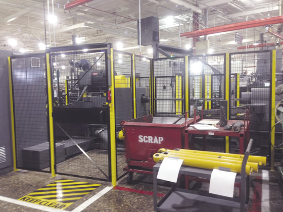

Folding Guard’s Saf-T-Fence machine guarding is used for a rod friction welder at the John Deere Internal Cylinder Div.’s plant, Moline, Ill.
“There are some very basic rules every shop should live by, and, typically, if you keep those in mind, you should be fine,” he said. “Mesh needs to be tight enough that you can’t fit your fingers through the opening, for example, and the distance between the equipment and the sweep space needs to be kept in mind. However, we need to see the shop in person in order to help bring things up to code, because there are plenty of hazards and deficiencies that might not come up unless you’re there to see it—lots of little codes and regulations that tend to go unnoticed.”
