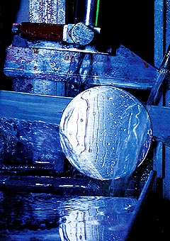

A bimetal bandsaw blade cuts into a difficult-to-machine material.
When metalcutters talk about bandsawing today, they’re talking the language of money—cost per cut, cost/benefit ratios, higher productivity demands, blade specialization, and the bottom line.

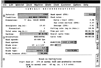

Massive databases enable the user to input specific cutting conditions for an individual sawing operation, such as the workpiece material and its machinability, shape and size of the workpiece, and whether the workpiece is an individual piece or a bundle.
Using this data, the program can provide a complete set of sawing-parameter recommendations and cost information.

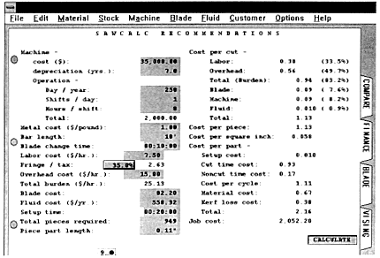

Parameter recommendations include correct blade type, tooth specification, feed rate, cutting rates and times, and new-blade break-in. A cost-cutting analysis is also provided to show specific costs of the operation. By making changes to any of the sawing parameters, the user can determine the effect a given change would have on productivity, in terms of blade life, total cost, or cost per cut, without having to make the change in reality.

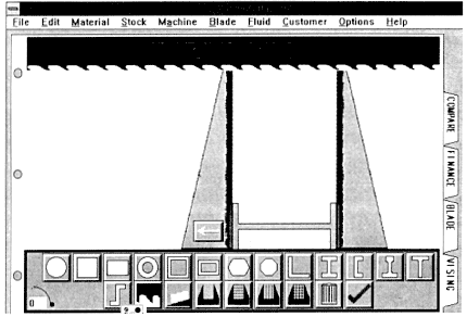

Today’s advanced software programs can utilize graphics to provide precise instructions on cutting structural materials. To do so, the program must recognize whether the material is standing up or lying down, an impossible task for such programs in the past. Advanced programs “see” how the material is positioned and can measure the exact angles of the material to be cut.
For example, let’s say you want to determine the best way to position an I-beam to maximize the effectiveness of the cut. On the screen, you pick an I-beam from an array of possible workpiece shapes and put it on the machine bed. You can rotate the piece yourself to check other possible positions.
The ideal position for a workpiece depends on your machine and material-handling equipment. Also, the varying thicknesses of a structural piece make positioning important. The bandsaw blade should meet the material wherever the cut will be most continuous throughout. Bandsaw blade life depends in part on proper positioning of the workpiece.
This type of Windows-based software program’s graphics capabilities and user interface make it more flexible than earlier models. In a difficult operation such as sawing structural steel, the user can achieve maximum machine and blade productivity or the most cost-effective cut, whichever is preferred, by simply employing the suggested speeds, feeds, and saw blade.

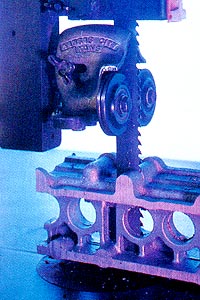

Figure 4: Carbide-tipped blades such as this Lenox Tri-Master blade cut a variety of ferrous and nonferrous materials.
HSS blades are fine for sawing mild steels and alloys. But carbide-tipped blades represent the more profitable approach to bandsawing in many nonferrous and some ferrous materials (Figure 4). Use of carbide-tipped blades has doubled in the last two years, probably because they cut faster and last longer than other blades when it comes to sawing materials that generate high heat and wear, including tool steels, aluminum, bronze, aluminum honeycomb, brass, copper, titanium, epoxy resin, carbon graphite, chrome, superalloys, and other new composites used in the aerospace, automotive, and commercial military industries.
Carbide-tipped blades also leave less “ghosting” on the material surface than HSS blades do, so workpieces require less secondary machining. Ghosting is a pattern left by set tooth blades, which have left and right set teeth. As the left tooth enters the material, the blade yields slightly and the tooth bounces, leaving a pattern on the workpiece. Then the right tooth enters and yields slightly, again leaving a pattern. As more teeth enter the cut, the teeth offset each other and there is less bounce. That’s why ghosting occurs mostly at the entrance and exit of the cut; when the blade is close to the center of the material there are more teeth in the cut. Carbide-tipped blades have ground teeth that cut equally on both sides, so they don’t bounce and, therefore, don’t cause ghosting.

Figure 1: Software programs such as SawCalc from American Saw & Manufacturing Co. can identify an array of cost factors in a specific bandsawing application.

Figure 2: Programs such as SawCalc permit the user to input specific cutting conditions for a bandsawing application.
