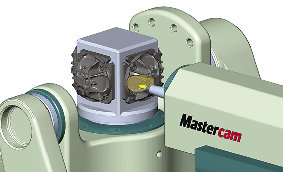

■ When quoting complex work, it is often beneficial to obtain a seat for the CAD program that was used to design the part. This makes it possible, for example, to evaluate the CAD model to ensure it is complete, give design-for-manufacturing feedback to the customer and create workholding fixtures based on mirror images of critical part features. This helps reduce lead times and reduce the time burden on the customer if the shop must repeatedly ask for clarifications of design intent.
■ If a shop works with customers on prototyping, having a CAM programming solution embedded in the design software can eliminate the time spent reviewing and reconciling changes made in either the CAD model or CAM software. For example, Mastercam for SolidWorks has been adopted by numerous shops that must live simultaneously in the design and manufacturing realms. It is fully associative, so changes made to the model in the design or CAM environment are automatically reconciled. This approach saves time and money, reduces errors and shortens lead time for prototypes.
■ Advanced CAM software packages have myriad capabilities. Two examples are oscillating toolpaths that reduce tool wear during trimming, and the ability to compare an STL file generated in CAM to the CAD model and inspect the part before making it. Most part manufactuers don’t have the time to browse through a CAM package’s capabilities and determine which ones could offer advantages. However, if a shop has a good working relationship with its CAM software reseller, the reseller should be able to point out beneficial capabilities based on his understanding of the shop’s manufacturing challenges.
■ As component complexity increases, 4- and 5-axis machine tools must achieve tight tolerances. In addition to upgrading CAM software so it supports multiaxis programming, almost all of the other moves mentioned here make multiaxis manufacturing more effective. CTE
