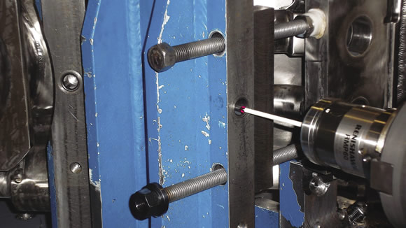

Each fixture has a datum feature, such as a bored hole or tooling ball, that corresponds with the coordinate system in the CAM software; programs begin from this common origin. The part probe then verifies the fixture location by probing a known location, and comparison of the datum location to the programmed value tells us if the fixture has been correctly located. By using logic statements in the code, we poll the machines to compare the measured locations to the predetermined locations and command the machine to stop and display a message if an error is found.

A part probe is ready to verify the fixture location and set the work offsets on an Okuma vertical machining center at Savannah Machinery Works.
We can probe the part to verify it has been properly loaded using the same method, again forcing the machine to stop and display a message if a large error is found. If the part is correctly located, the probe will fine-tune the coordinate system for the part before the program continues.

Probing takes place on a 1,350mm horizontal boring mill, which Savannah Machinery Works uses to machine large weldments that measure 1,000mm tall and weigh 300 lbs.
The artifact should reside in a known position and have documented dimensions. Calibration compares the known dimensions to the measured dimensions. If the measured values are acceptable, the probe measures the part. If the measured values exceed the allowable limits, the machine stops and provides an error code.
