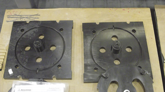

Savannah Machinery Works can produce a fixture, such as this large tombstone with a vise that has a set of machined jaws, in a few hours to solve a machining problem.

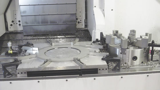

A chuck and a quickly made fixture on a vertical machining center demonstrate Savannah Machinery Works’ flexibility.

Savannah Machinery Works can set up its new dedicated fixtures to fit on tombstones or subplates and be ready to run in about 10 minutes.

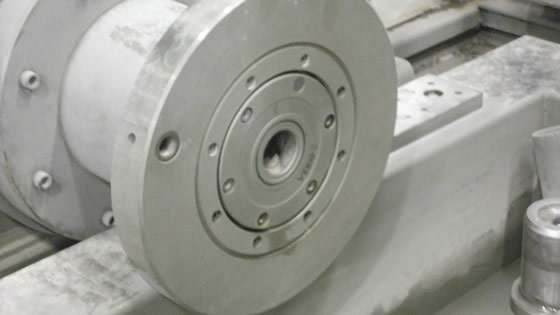

This fixture enables quick changeover on a 6-axis waterjet machine at Savannah Machinery Works.
