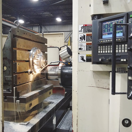

valve%20half.tif
A valve component is machined on a Union T&K table-type horizontal boring mill.

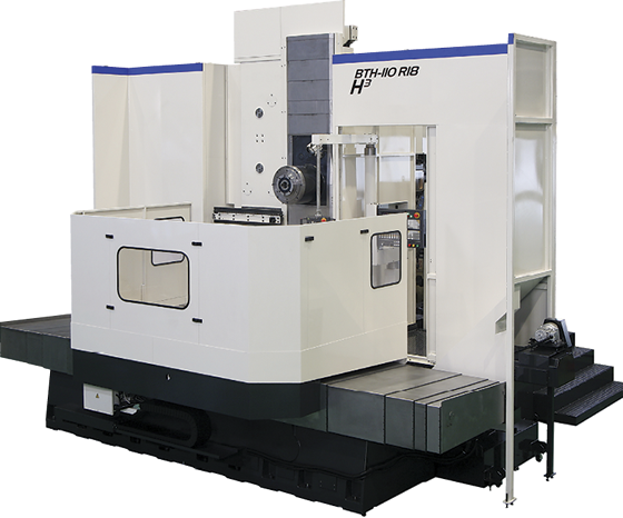

BTH-110.R18.tif
Toshiba offers a full range of table-type boring mills for various applications, including the BTH-110.R18, developed to provide machining center flexibility, according to the company.

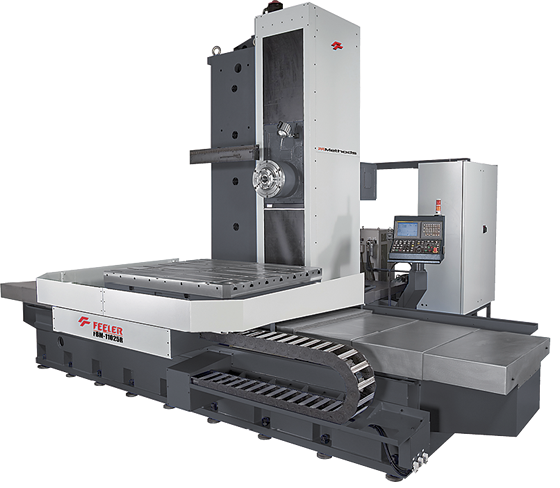

FBM-11025R.tif
A Feeler table-type HBM from Methods Machine Tools has a rotary table and an extendable quill.

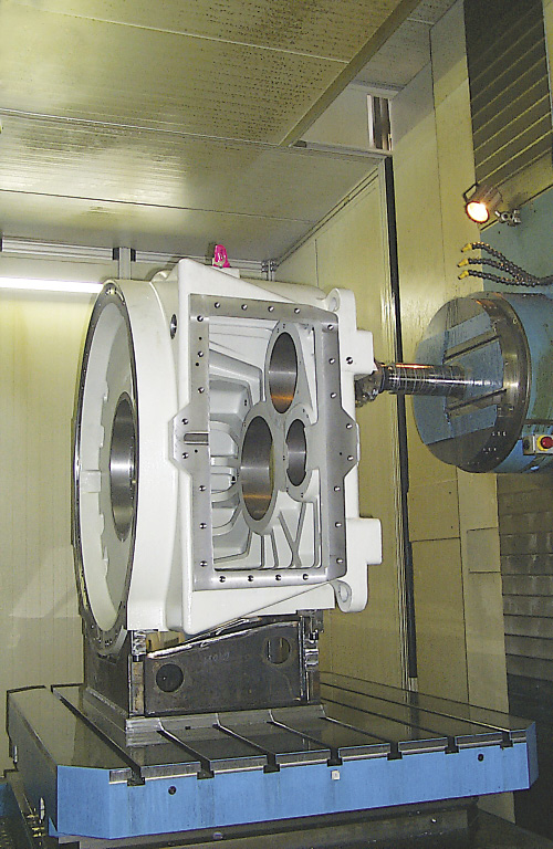

Gearbox.tif
Gearbox manufacturers can make use of the HBM’s quill to ensure all internal and external bores are perfectly aligned.
