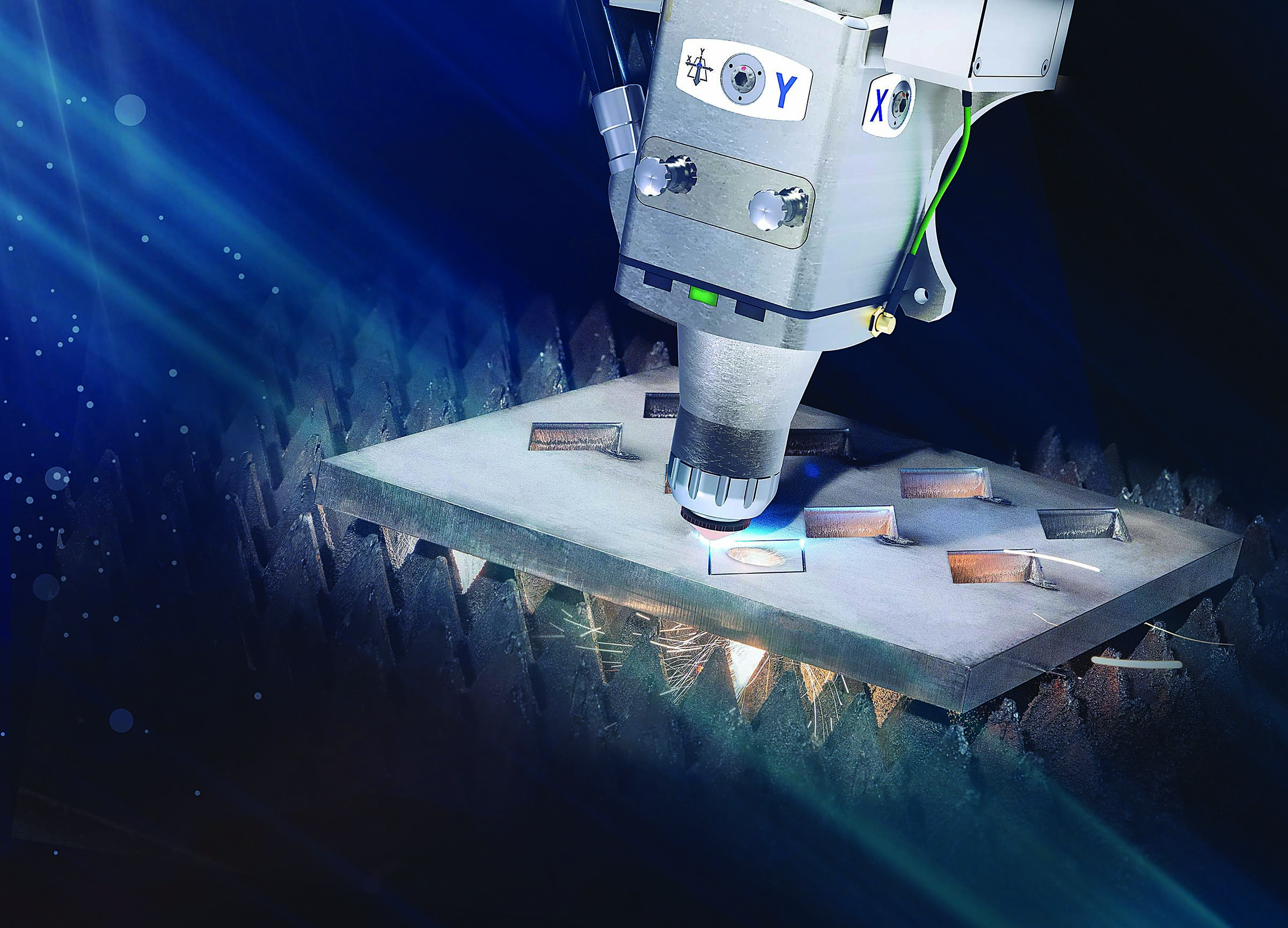

When laser cutting stainless steel (shown at left), different assist gases produce different results. Image courtesy of IPG Photonics

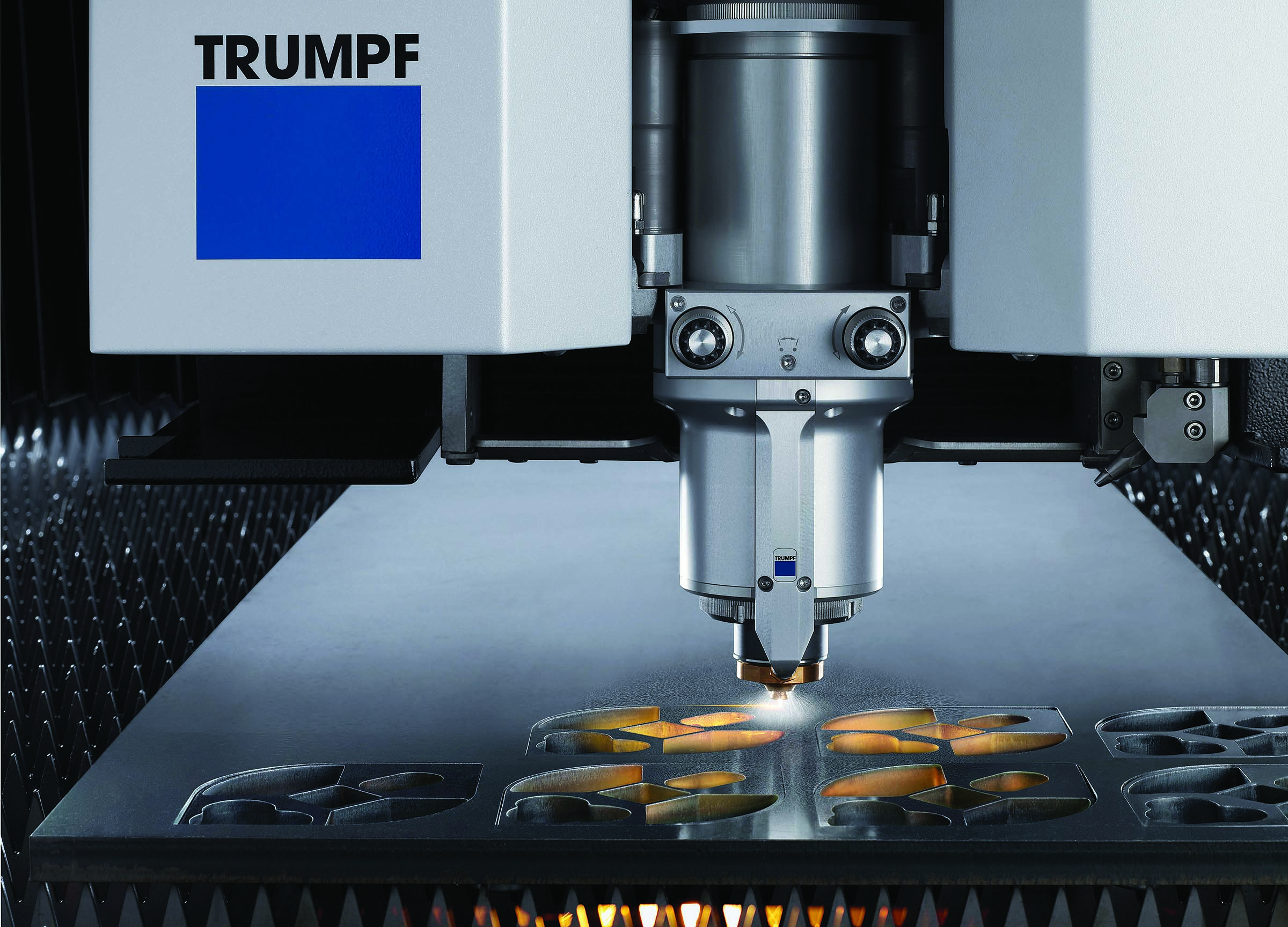

Trumpf’s technology enables selective cooling of a workpiece during laser cutting. The purpose is to improve process reliability and allow new geometries when a laser cuts thick mild steel. Image courtesy of Trumpf

When it comes to types of steel, Sarrafi said the details of the laser-cutting process are different for carbon steel and stainless steel. The main differences include the choice of laser power and so-called assist gas.
For stainless steel, he said nitrogen assist gas provides a shiny, nonoxidized cut surface while high-pressure air lowers cutting costs but produces oxidation on the edge.
As for carbon steel, Sarrafi said it can be cut with oxygen, nitrogen or clean, dry high-pressure air. With oxygen cutting, he explained, most of the process energy is generated by the reaction of oxygen with the iron in carbon steel. The laser is the initiator of the reaction and a supplementary heat source.
“Because of the extra oxidation energy,” he said, “you can cut a thicker section of carbon steel at a given laser power compared to nitrogen or air.”
Oxygen cutting also results in a smooth cut edge, Sarrafi said, but it is oxidized heavily and the heat-affected zone is much larger than it would be in a nitrogen or air process. In addition, he noted that it is difficult to scale up the speed of an oxygen-cutting process, unlike nitrogen- or air-cutting operations. This is because oxygen cutting requires a certain ratio between energy input from oxidation and that from the laser.
“As a result, you cannot apply too much laser energy in this process, so cutting throughput does not scale up well with increasing laser power,” he said. “So cut speed is low with high-power lasers.”
In nitrogen cutting of carbon steel, however, Sarrafi said cutting speed scales well with laser power, so carbon steel can be cut very fast with high-power lasers. But he also pointed out that nitrogen is expensive. On the other hand, he noted that cutting with high-pressure air offers the speed advantage of nitrogen cutting without its cost drawback. But to get a high-quality cut in thick carbon steel with air, he said users need high laser power — typically at least 8-kW.
How much of a difference can the choice of assist gas make in a laser cutting process? When cutting 16 mm (0.63″) carbon steel with a high-power laser, he said the speed of oxygen cutting remains at about 2 m/min. (6.56′) when laser power goes from 10-kW to 30-kW. But when air cutting at 30-kW, he said the speed is over 9 m/min. (29.53′), more than four times faster than cutting with oxygen.
