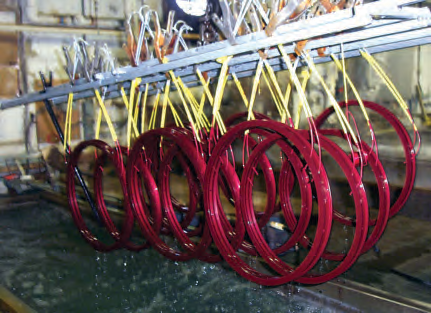

Courtesy of Aluminum Anodizers Council
Aluminum parts anodized in a chemical bath and dyed red.
