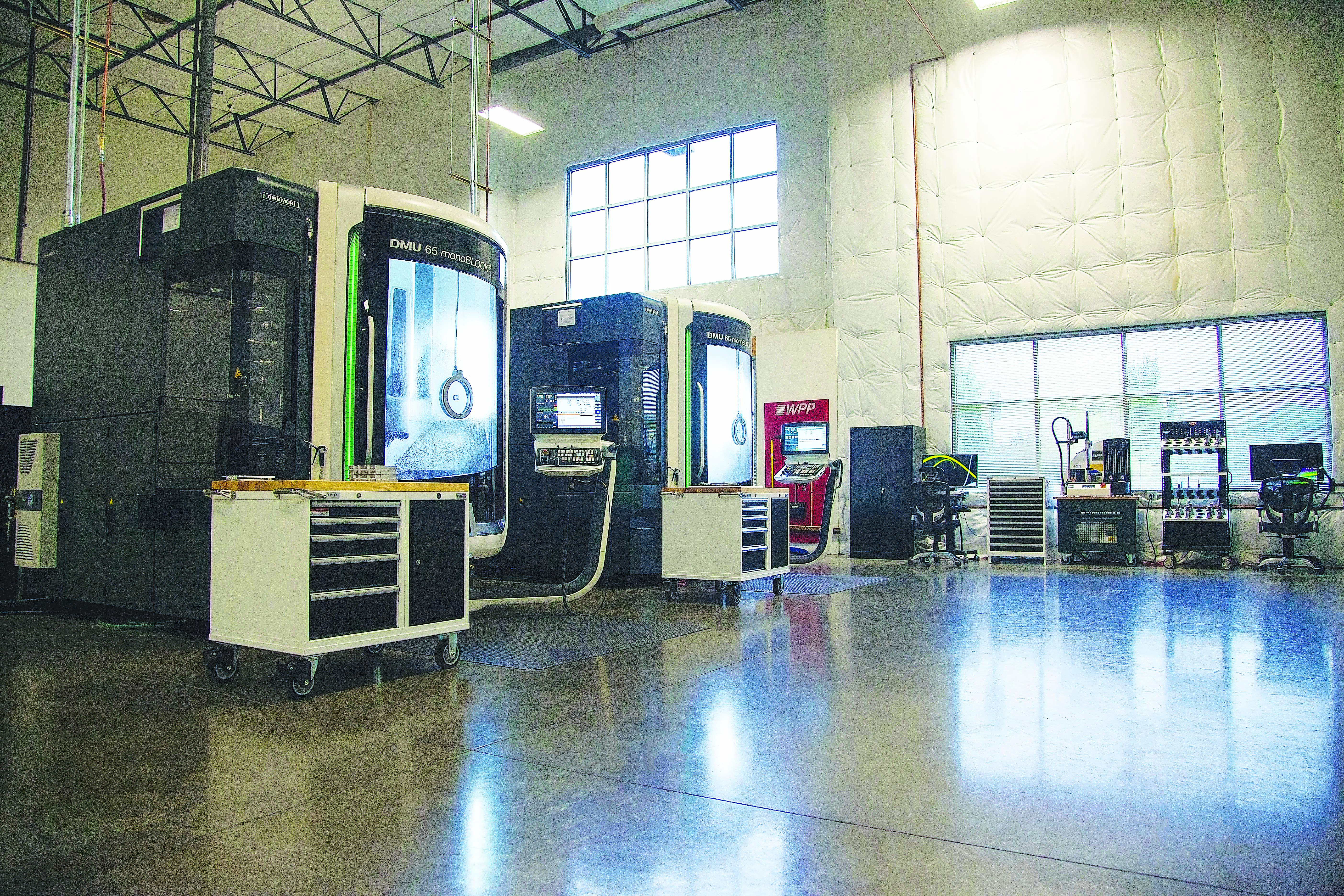

The “quick-turn” department at Western Precision Products boasts offline presetting, hyperMILL CAM software and a pair of DMU 65 monoBLOCK 5-axis machining centers from DMG Mori. Image courtesy of Western Precision Products

In October, the Mullins took a step toward Industry 4.0, opening a prototype department with “state-of-the-art technology from top to bottom,” Jerry said. The shop installed a pair of DMU 65 monoBLOCK 5-axis machining centers from DMG Mori, invested in an offline tool presetting system equipped with Balluff-style Bluetooth chip readers and implemented a hyperMILL CAM system from Open Mind Technologies.

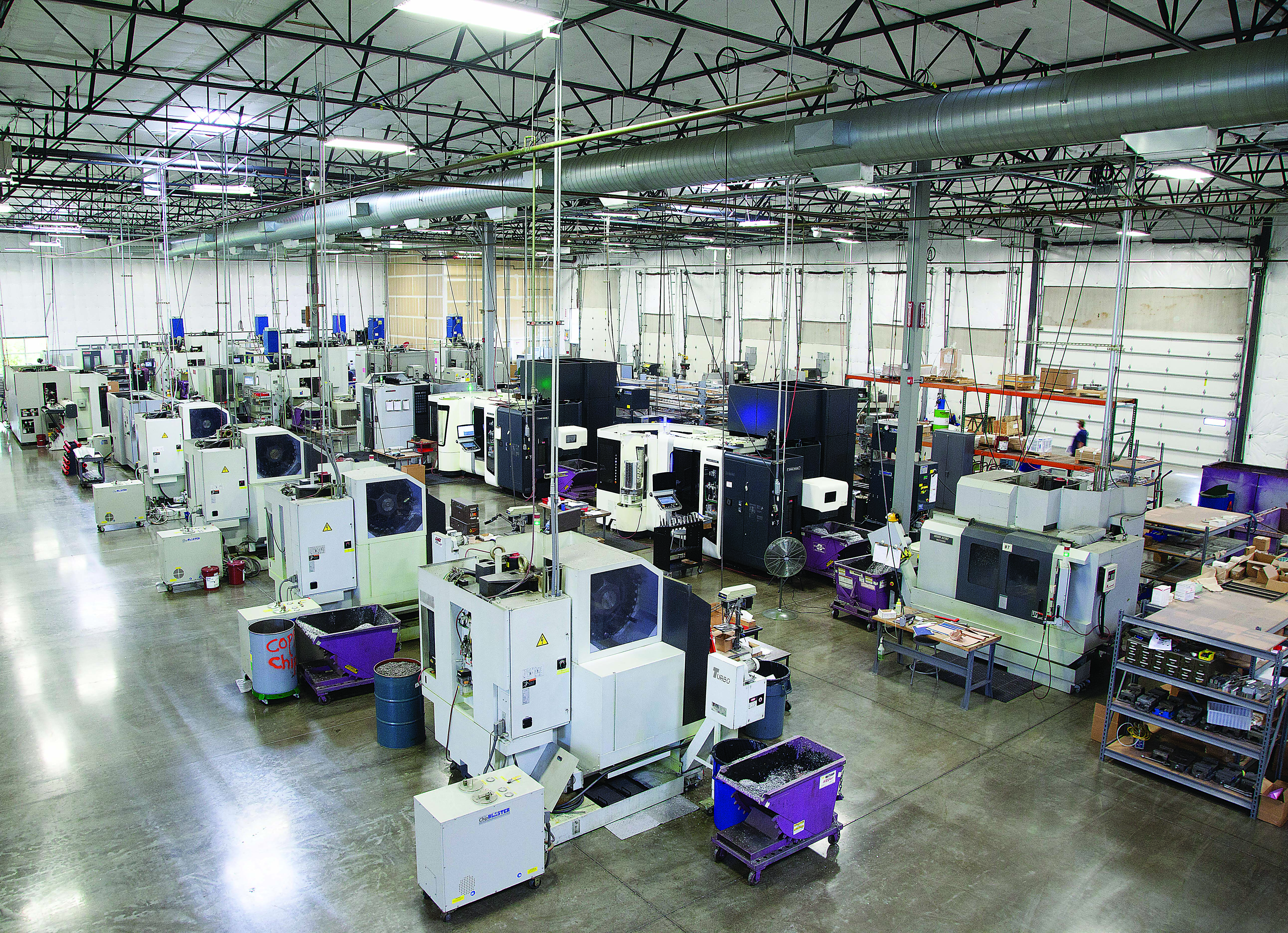

A bird’s-eye view of Western Precision Products’ state-of-the-art production floor.
