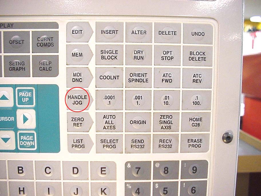

This part of the controller (left) shows the end-of-block and write/enter buttons. Once in handle-jog
mode (right), you can pick the incremental amount you want the table to move for each click
of the handle dial. Images courtesy of J. Harvey

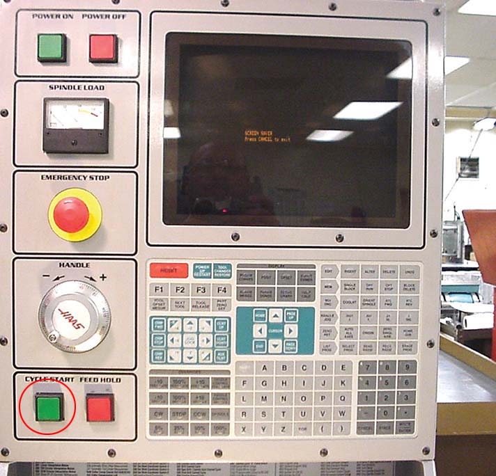

Press the green cycle-start button to run the program. If the spindle turns on, which it should, you have successfully written and executed a short program.

Use handle-jog mode to move the table manually. Press the handle-jog button to get into handle-jog mode. Then rotate the hand dial to move the table.

When you’re ready to run a program, press the cycle-start button. Image courtesy of J. Harvey

Once in handle-jog mode, you can select the axis you want to move along and choose the increment or “speed” at which you want to move. You have to be careful here. It’s been my experience that a lot of crashes are caused by careless handle jogging.
If you push the .01-increment button, then each click of the hand dial will move the spindle/table 0.010″. You have to be especially careful when moving 0.1″ per click because things happen quickly at that setting.
The only time you need to choose between a plus-axis or minus-axis button is when you want to lock the movement of the spindle or table in a specific direction in handle-jog mode. You do that with the jog-lock button.
Take some time to cruise around in handle-jog mode, changing axes and increments until you get used to how the machine responds. You’ll spend a lot time in this mode to indicate parts and find their edges.
