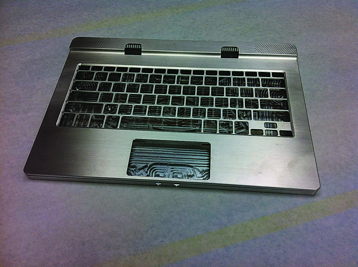

The vast majority of Form Factory’s jobs involve machining one to five copies of a prototype, such as this one for a notebook computer. Image courtesy of CNC Software
“He’s looking for surface finishes that are way beyond what most shops that do prototyping are,” Rowley said. “He’s always pushing the boundaries.”

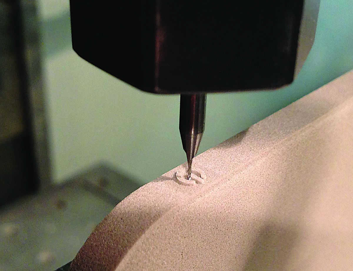

A microendmill is applied at Form Factory to create a Thanksgiving plaque. Image courtesy of CNC Software
Dynamic toolpaths also include a rest milling option, which removes material left by previous operations. For example, if a scallop is left in a corner by a cutting tool with a diameter too large to remove it, the software automatically will plan to remove the scallop with a smaller-diameter tool.
