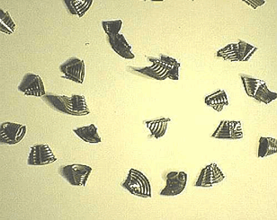

Output from the evaluation produced a typical chip, as seen in Figure 2. Physical testing substantiated the computer models. The new insert produced the chips shown in Figure 3.

Figure 3: Ingersoll developed its new drill insert based on data collected during simulations. Shown are actual C-shaped chips cut by the insert.
Performance tests showed that the final design had the broadest range of chipbreaking abilities ever achieved by a single insert design when drilling soft materials. This case proved to be an “out of the box” success, meaning only one prototype mold had to be constructed.
