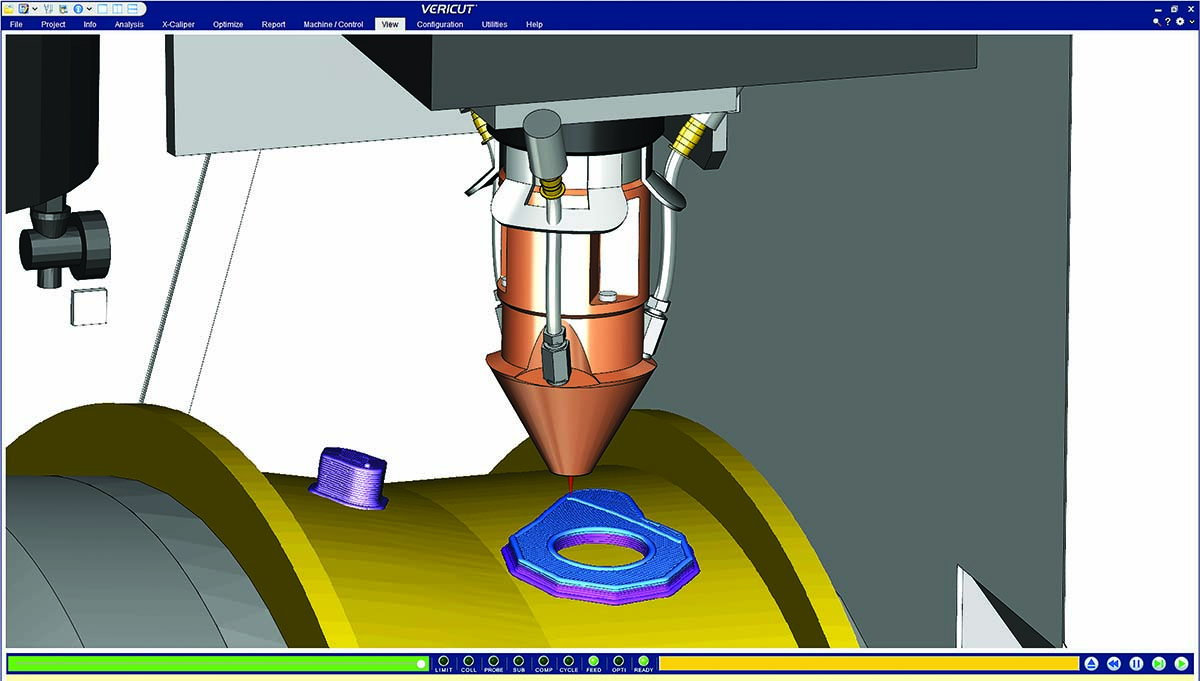

Thus, the desire to simulate programmed cutting routines in a virtual environment before the actual machining begins. “CAM software people tell you that they have a way to check their programs” prior to the start of real machining, noted Ely Wahbeh, Vericut product manager at CGTech, a software developer in Irvine, California. “But the issue there is the programs are simulated before they get post-processed.”
Software developers can help customers identify and solve CAD/CAM problems. Image courtesy of Mastercam
Post-processor software translates CAM toolpaths into Geometric code, or G-code, for a specific CNC machine. Since the verification tools offered by typical CAM systems simulate programmed cutting routines before they’re converted into G-code, Wahbeh said, they can miss collisions and other program-related problems that crop up during the actual machining processes.
That’s why there’s demand in the machining industry for software like CGTech’s Vericut. Capable of integrating with all major CAM systems, Vericut can simulate a variety of CNC machine tools from leading manufacturers. The software checks a programmed cutting routine by running the G-code on a digital twin of the machine that will make the parts.
“You get to see a part cut virtually,” Wahbeh said. “If everything looks great, you’re good to go,” Wahbeh said. “If there is a problem, you can see where the collision [occurs] and which section of the program is causing that problem. Then you can go back into your CAM system and work on it.”
Discovering machining problems at this early stage is far better than discovering them later on. “It’s easier to recover virtually than it is from a real [problem] on the shop floor,” Wahbeh said. At that point, “there could be a lot of damage to the tools, spindles, fixturing, you name it.”
Besides simulating subtractive manufacturing, Vericut can be used to check metal deposition processes performed by 3D printers and hybrid additive-subtractive machines. As Vericut does with machining, the software’s additive module uses the same G-code file that will be used to drive the real production process so the simulation will match the actual machine behavior as closely as possible.
A brand new capability offered by Vericut version 9.4 is a CNC Precheck application, which can be used on shop floor computers or Windows tablets next to CNC machines. The application connects to machines to compare setup information in the machine to the corresponding settings in the Vericut simulation.
According to Wahbeh, verifying that these settings match as closely as possible is another way the software helps users breathe easier when it’s time to push the cycle-start button to initiate real machining. With the CNC Precheck application added to traditional Vericut, “you get a check from the CAM side and a check from the live machine side,” he said. “And by doing these two checks, your confidence level goes much higher.”
