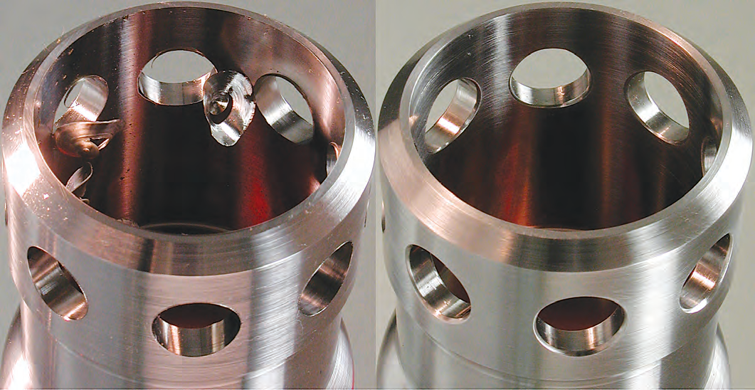

Jet-engine manufacturing typically requires through-holes that accommodate fasteners for various components and subassemblies. These through-holes must be chamfered, free of burrs and have radiused edge transitions.

Heule cutting tools, along with BRM’s Flex-Hone tools, remove burrs and caps created when drilling holes in nickel, Inconel, Waspalloy, titanium and stainless steels. A precise, smooth though-hole is critical for aerospace parts.

“Every jet engine includes many static and rotating parts,” said Gary Brown, vice president and general manager of Heule Tool of North America Corp., Cincinnati. “Hole drilling and edge-breaking processes must be performed perfectly so that these parts stay together—particularly rotating parts. We stress making good through-holes by drilling, milling or reaming—whatever process is called for.”
Brown added that aircraft engine manufacturers demand controlled holemaking and edge-breaking processes so the parts come off their CNC machines finished and to spec. In particular, these manufacturers want to avoid costly and time-consuming bench operations, where components are deburred and finished by hand.
When cutting nickel-base and titanium alloys, drills and reamers quickly dull and can create large, extruded burrs that are difficult to remove. Burrs created from improper machining are also difficult to remove because they tend to workharden.

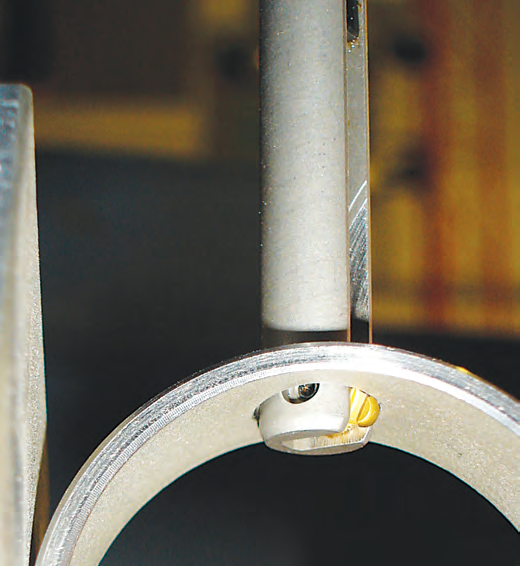

In combination with Heule cutting tools, a major jet engine component manufacturer applies the Flex-Hone from Brush Research Manufacturing on the machining center for final deburring of through-holes, which is usually an expensive and time-consuming manual operation.
In combination with Heule cutting tools, the BRM Flex-Hone is used for final deburring and edge blending of through-holes. “Our tool produces radiused edges on the front and back of the metal part and removes the drill burrs and drill caps created by the drill, reamer or endmill,” Brown said. “Our tools also perform the edge-breaking step, but we recommend the Flex-Hone to go in after the beveled edges have been created to round the transition between the beveled edge and the hole.”
Brown noted that drilling workpiece materials that produce long chips, such as stainless steel and titanium, can create raised material around the hole. The Flex-Hone is effective for removing such burrs up to 0.003 ” in length.

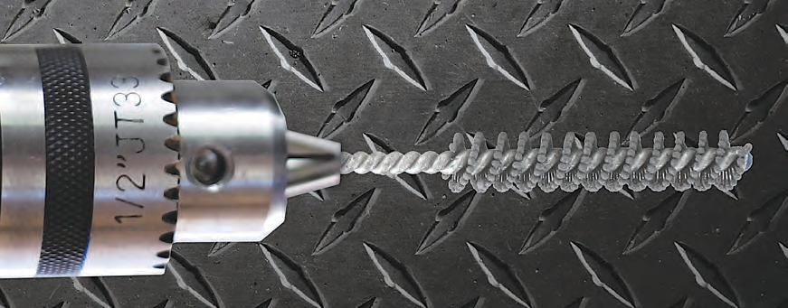

The Flex-Hone is available in various abrasive types and grit selections to provide optimal surface finishes on base materials. It is commonly used to reduce Ra, Rk and Rpk values while maintaining Rvk and Vo volume for oil retention.
Heule typically recommends that customers specify Flex-Hone sizes with 180- to 240-grit silicon-carbide abrasive and speeds and feeds of between 800 and 1,200 rpm and 40 to 60 ipm, respectively.
“Simply inserting the tool for three strokes in both directions (in and out) will normally produce a smooth transition between the breakage and the finished hole,” Brown said.

Manufactured in standard sizes beginning at 4mm, the Flex- Hone is characterized by small, abrasive globules permanently mounted to flexible filaments. A relatively low-cost tool also available in custom sizes, it is used for ultrafine surface finishing, deburring, plateau finishing and edge blending.

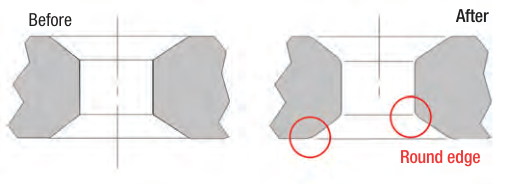

BRM soon determined a special would be required. “The tricky part was the diameter difference between the main bore that goes though a little web piece and the size of the countersinks,” Miller explained. The tool must be large enough to reach entirely to the outside, effectively deburr and radius that transition, pass through the hole and do the same procedure on the backside of the hole, he added.
To further complicate matters, the tool could only enter the front of the part because of the setup on the machine, but a standard-diameter Flex-Hone wouldn’t be flexible enough to reach through the small-diameter bore and “pop out” the backside to simultaneously perform the required deburring and edge radiusing. “A tool sized for that large of a diameter would be too stiff to pass all the way through the part,” Miller added.
Diagram Flex Hone Smoothing Operation wcaption.tif
The solution was a special tool much larger in diameter than would be normally applied based on the specific through-hole diameter. To ensure the tool could enter the through-hole and perform the same operations on the backside of the part, BRM designed it with lighter-diameter filaments and lighter gauge stem wire.
“If we attempted to pass a standard tool through the small through-holes, the balls would have sheared off,” Miller said. “With our custom design, we are able to handle combinations of through-holes with countersinks as large as 0.050 ” over the size of the hole. We also worked with the customer’s surface-finishing lab to develop operating parameters that maximize tool life.”
