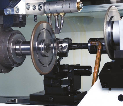

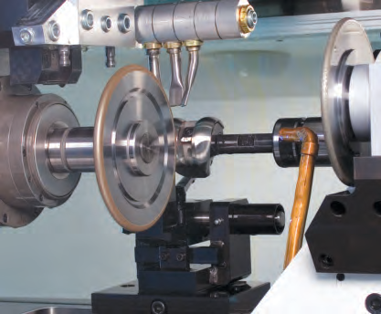

A major advantage of grinding vs. other metal-removal methods is its ability to impart extremely fine surface finishes. Now, advances in grinding techniques and wheel technology are pushing that capability into the realm of what traditionally has been considered polishing, using slurries of loose abrasives. The loose abrasive polishing process is said to be slower and less repeatable than grinding.
Walter_femoral_knee_grind.tif
Courtesy of Walter Grinders
Superabrasive wheels easily can produce finishes in the range of 18 µin. Ra and finer as illustrated by this femoral knee component ground in a 5-axis Helitronic Walter grinder. In addition, advances in wheel technology are enabling the production of finishes in low-single-digit µin. Ra range, formerly considered the realm of polishing.

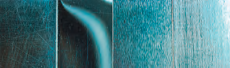

What level of finish actually constitutes polishing is a matter of opinion. Glen Rosier, applications engineer/business development for Abrasive Technology Inc., Lewis Center, Ohio, said: “Polishing is defined differently by each and every customer. When someone refers to polishing, I always ask what Rathey are looking for. A lot of people consider a polish to be a 5, 7 or 9, while my idea is a bright polish, which is somewhere around 2 µin. Ra or better. Whenever a customer says he needs a certain finish, I ask him to send me a part. I have it measured with a surface profilometer so I know what he is really talking about.”
The appearance of a polished surface may not accurately reflect actual surface roughness. “We did a grinding test for a customer who was trying to generate what he called a bright polish,” Rosier said. “He took a competitor’s wheel and ran a part, then he took our wheel and ran a part, and he kept repeating that the other part looked better than ours.”
Rosier said the competitor-ground part actually did look smoother, and suggested measuring the surface finish on a profilometer. The competitor-ground part measured 3.5 to 4 µin. Ra, while the part polished with the Abrasive Technology wheel was 1.8 to 2.2 µin. Ra. “The other wheel was just polishing the peaks of unevenness off the surface, where our wheel actually generated a superior finish,” Rosier said. He attributed the results to differences between the two wheels’ blend of bond and superabrasive grit.

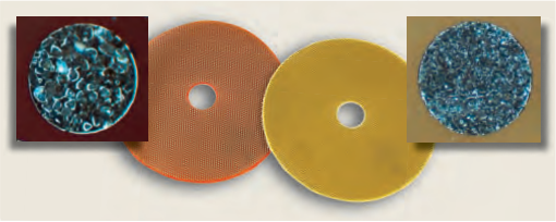

In some situations, polishing discs with fixed superabrasives, such as these Genesis diamond abrasive polishing discs from Abrasive Technology, can offer advantages over methods that employ loose abrasives. The approximately 30× magnifications show the 220-grit abrasive of the left-hand disc (left) and the 600-grit abrasive of the right-hand disc (right).

Courtesy of Abrasive Technology
The level of finish that constitutes a polished surface can depend on opinion and looks. These four approximately 30× magnification images show, from left to right, sample surface finishes of 4 µin. Ra, 2 µin. Ra, 8 µin. Ra (lapped) and 8 µin. Ra (ground).
