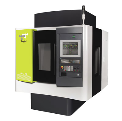

The new iVU-5 from Tongtai can operate with or without ultrasonic-assist. Image courtesy Absolute Machine Tools.
Sound Shakes Up Machining
A significant development in UA machining technology, according to Short, is EWI’s “ultrasonic machining module.” Designed in the form of a conventional toolholder, the module can be attached to new and old machines. EWI’s module technology is the basis for the NFP and NRT units from Acoustech Systems, also of Columbus, for multiple-spindle machines and lathes that perform centerline work.
Another option for UA machining is the iVU-5 from Taiwan-based Tongtai Machine & Tool Co. Ltd. The dual-function iVU-5 can operate as a vertical machining center and perform rotary UA machining.
Rotary UA machining combines high-speed spindle rotation with high-frequency vertical vibration of the cutting tool to reduce the cutting force, boost productivity (in its UA mode, the iVU-5 cuts three to five times faster than conventional machine tools) and impart ultrafine finishes, according to Absolute Machine Tools Inc., Lorain, Ohio, which sells the machine in the U.S.
Applications for the iVU-5 include microdrilling and machining of hardened steel, aluminum and high-nickel alloys. Before the introduction of the iVU-5, “manufacturers would have to use a slower EDM approach for microhole production,” said Courtney Ortner, Absolute’s chief marketing officer.
On the downside, the iVU-5 costs more than a wire EDM. Then again, Ortner noted, buyers “are getting two machines in one.”
