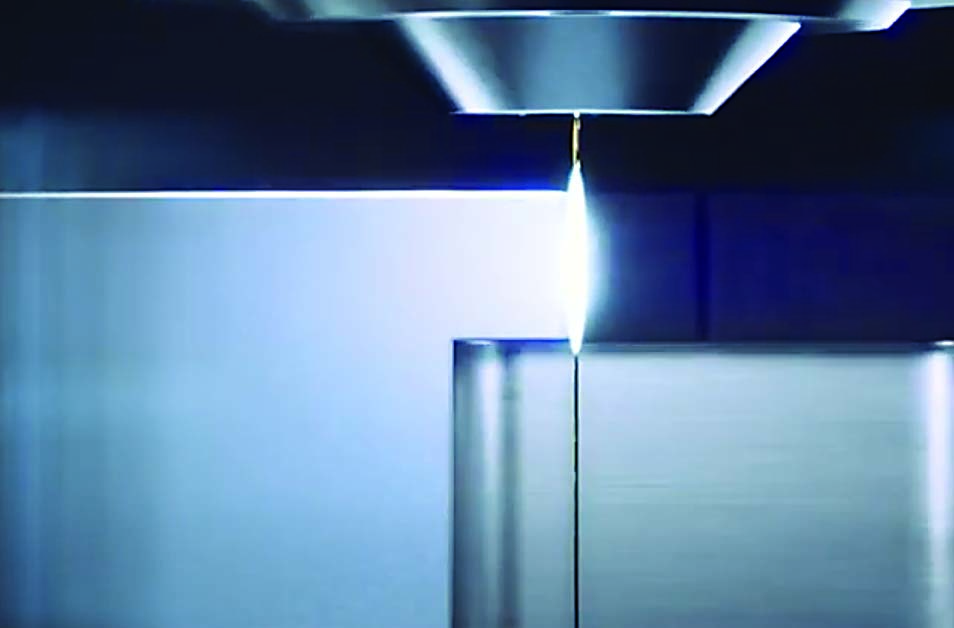

The tool electrode in the wire EDM process is normally a thin wire. Today, the diameter of an EDM wire is typically 0.01″, said Eric Ostini, business development manager at Lincolnshire, Illinois-based GF Machining Solutions LLC, which sells EDM machines. As the EDM process melts material, the wire continues to unspool and move through the workpiece to cut the desired through-cavity shape. The process can include an initial roughing pass and a number of “skim” passes to improve the accuracy and surface finish of the cavity, he explained.
Wire EDM can include an initial roughing pass and a number of skim passes to improve accuracy and surface finish.

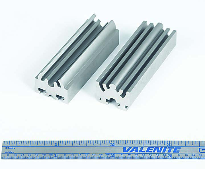

Wire EDM is employed to create parts with fine details and intricate geometries.

Coward pointed out, however, that certain shapes and features simply cannot be milled. Or maybe you can mill them, he said, but if they’re really intricate, they actually could take longer to mill than to make with a wire EDM machine.
“Wire EDM is very easy to program,” he said, “and you can get things like very tight corner radii that you’re not going to be able to do in a mill unless you go down to very small cutters and then go in and pick out those corners. But that’s going to be very inefficient in terms of cost because those cutters are very expensive and they’re going to wear fast.”

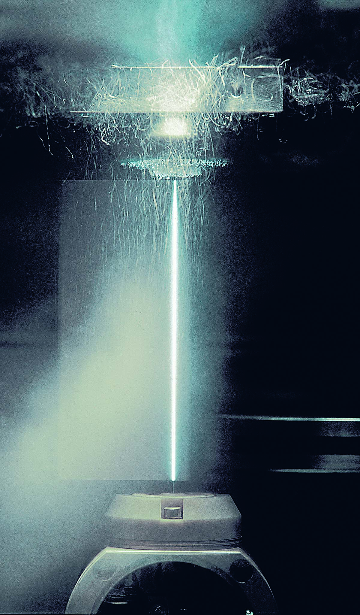

Today, wire and sinker EDM users also are benefiting from recent developments aimed at making the processes more economical and easier to use. One such development is the introduction of iWire technology by GF Machining Solutions. Ostini said iWire automatically adjusts the speed of a wire-dispensing spool to match cutting conditions at any given moment. If the thickness of a material being cut suddenly went from 3″ to 0.5″, for example, he said most EDM machines would have to be adjusted manually to slow the wire spool speed accordingly. By contrast, he explained, iWire would sense the change in material thickness and automatically make the appropriate adjustment. Prompt automatic changes of this kind can reduce wire consumption in a typical EDM process by 30% to 40%, he said.

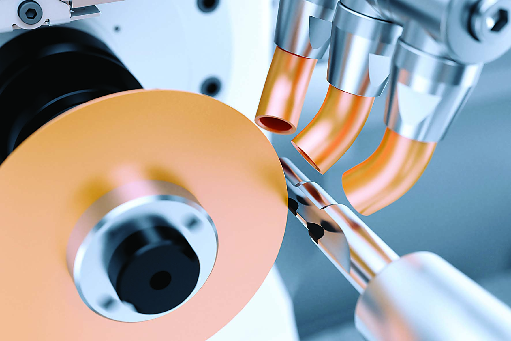

For toolmaking applications involving polycrystalline diamond, Vollmer recently unveiled the VHybrid 260, a machine that combines a grinder with an EDM generator. The grinder can be used to produce the carbide part of a tool while the EDM process shapes the PCD tip, which is difficult to grind. Brown explained that the VHybrid 260 erodes PCD with a disk-shaped electrode made of copper tungsten in a process similar to sinker EDM.
Introduced at IMTS last year, he said the VHybrid 260 could be a game changer for toolmakers struggling with the challenges of machining PCD.
“I am excited about the machine and how it’s going to make manufacturing of PCD tools much easier,” Brown said.
