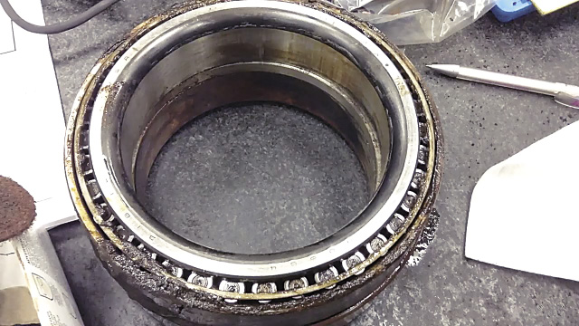

The main cause of spindle failure is bearing contamination. Image courtesy GTI Spindle Technology.

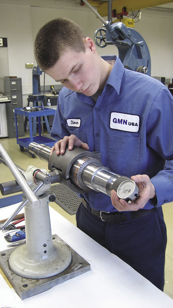

A technician checks the taper of a spindle shaft for size. Image courtesy GMN USA.
