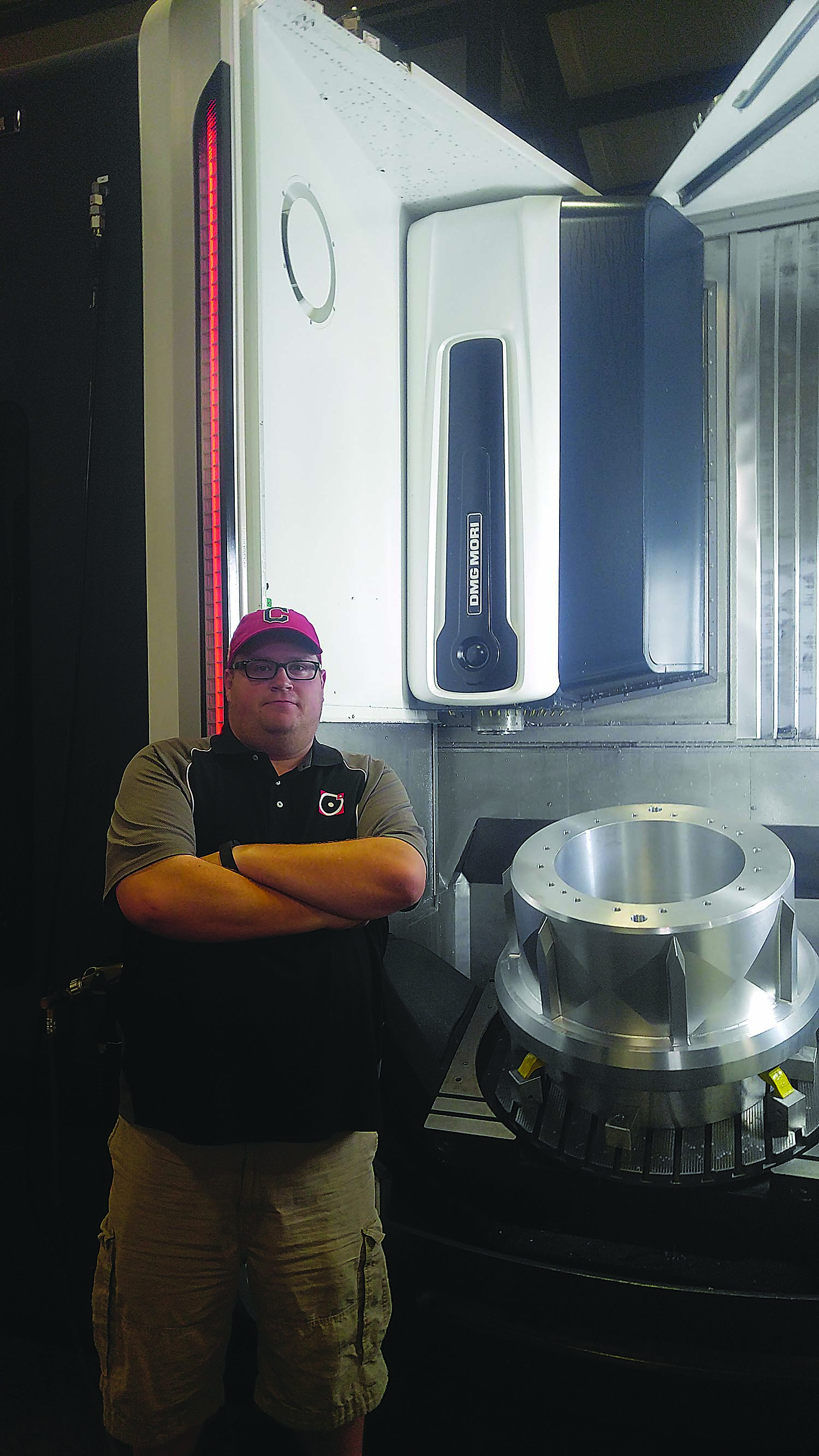

Ansco Machine Applications Engineer Dave Sterling stands next to a suction manifold and the company’s DMG Mori DMU 65 monoBLOCK. All images courtesy of Ansco Machine.

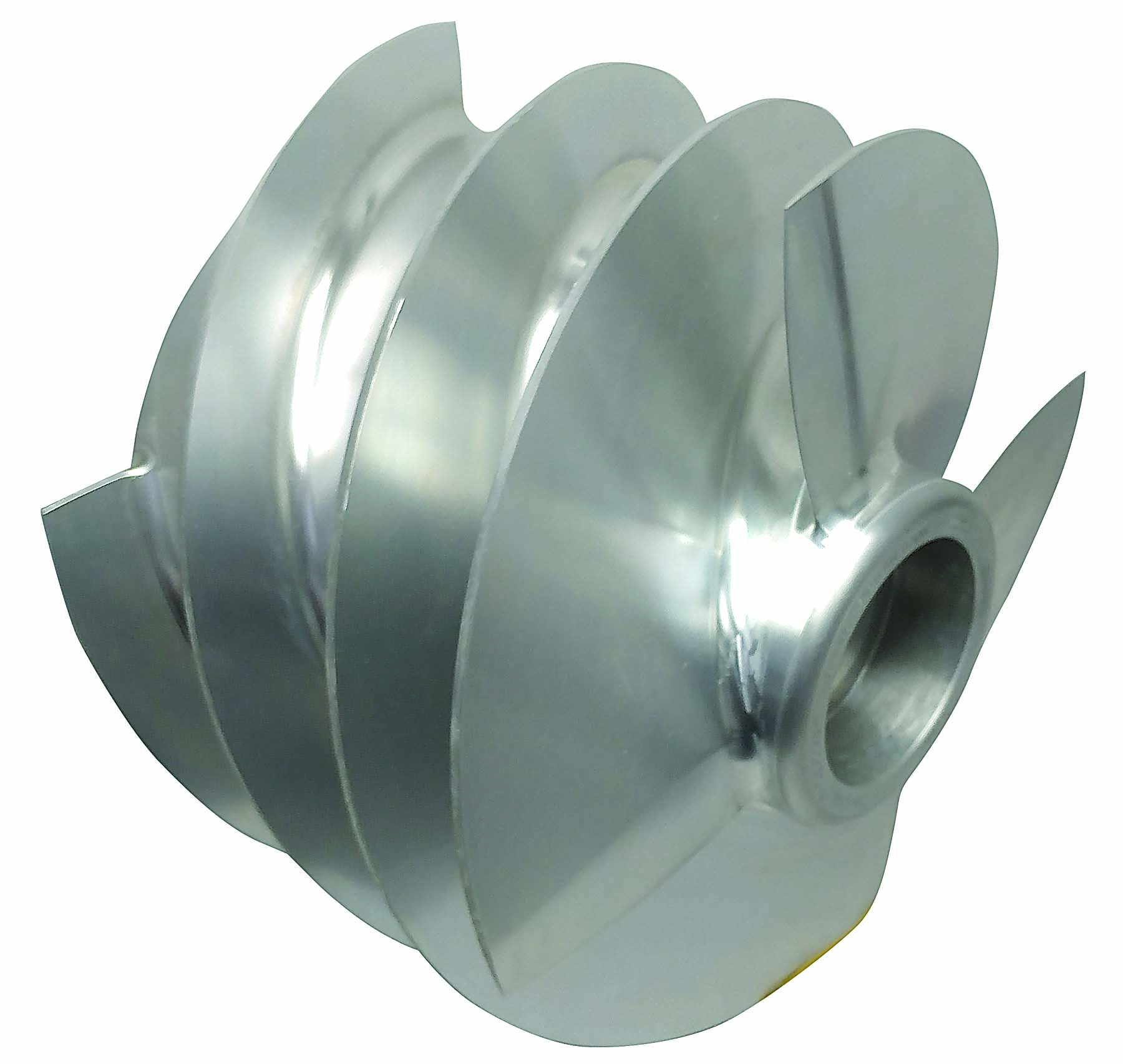

Then, Ansco received an emergency inquiry from a customer in the liquid natural gas industry. The customer needed an order of fan-type inducers within a week. Ansco had made a few similar parts in the past using one of five Makino HMCs, but the process was painstaking. Sterling would machine one side of the part, make a nest for it, then cut the back. This method worked well enough but wasn’t ideal.
For this fan-type inducer, Ansco Machine used ESPRIT CAM software to program the part on a DMG Mori DMU 65 monoBLOCK machine.
The new inducers could be programmed on an HMC. However, the parts’ complexity would require knowledge of 5-axis machining, which Sterling didn’t have. He called ESPRIT. Two days later, he was on a plane to Charlotte, N.C., to get one-on-one training that would enable him to do 5-axis programming on Ansco’s 4-axis Makino machine. Ansco completed the order in time and went on to use the same method for a number of other parts.
Later, Ansco needed to undercut a more complex inducer and realized that a 4-axis machine wouldn’t do the trick. The company considered contracting the work to another shop but ultimately invested in a DMG Mori DMU 65 mono-BLOCK to complete the job.
