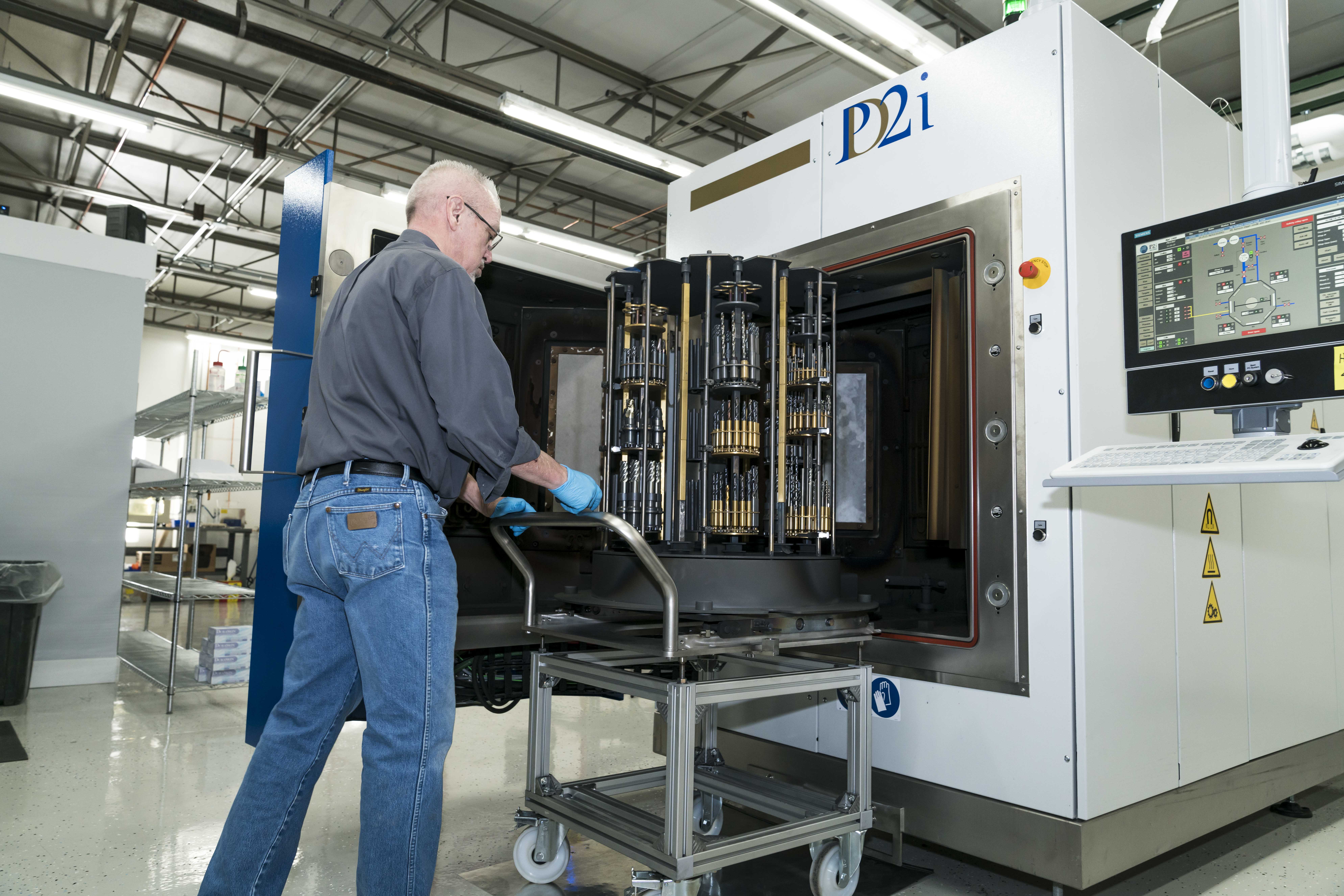

To perform physical vapor deposition coating, Wichita, Kansas-based STS reports that it invested $2.2 million in equipment and hired additional employees. STS has a German-made MpC1000 coating vessel from PD2i that has 12 spindles and can deposit a number of coatings, including TiN, TiCN, AlTiN, Alcron, AuRoRa, Micral TeToN and AlTiSiN.

STS has a German-made MpC1000 coating vessel from PD2i. Image courtesy of Superior Tool Service
STS specializes in making custom tools and can coat different types and sizes of tools at one time. “We really have to tailor our recipes and fixturing to make sure we get the same coating thickness,” Whitney said.
