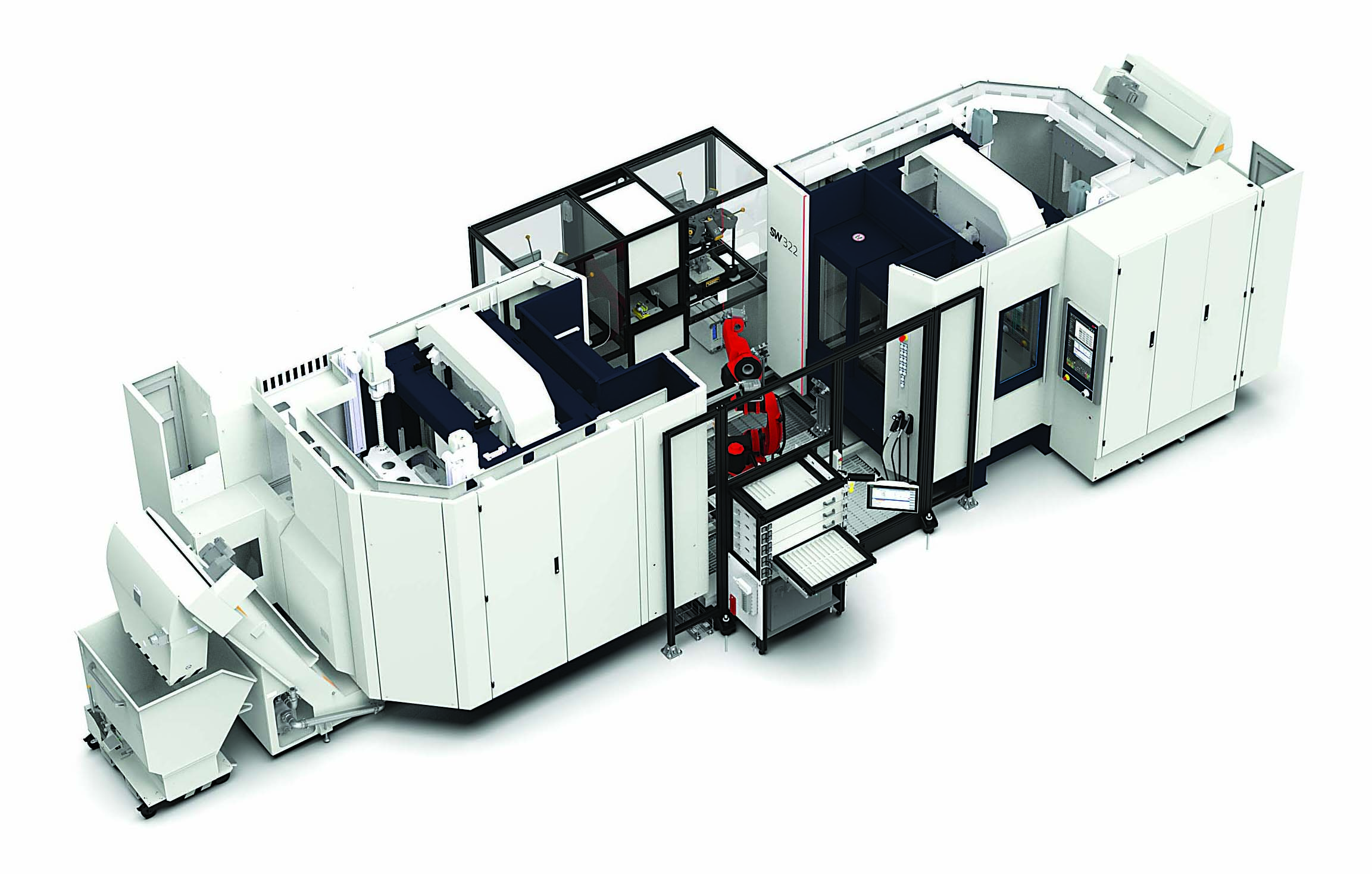

This complete production system (shown above) includes two horizontal machining centers, robot automation, shop floor comparators, a laser marker and a part storage unit. Image courtesy of SW North America

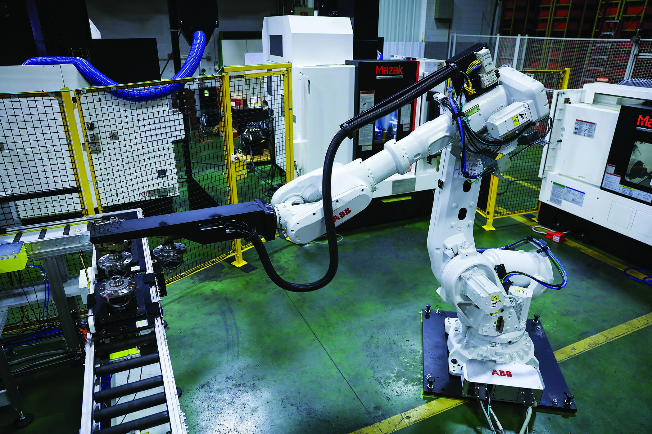

Raw and finished parts are moved through each of three machining cells on a loop conveyor diverting system. Image courtesy Mazak
