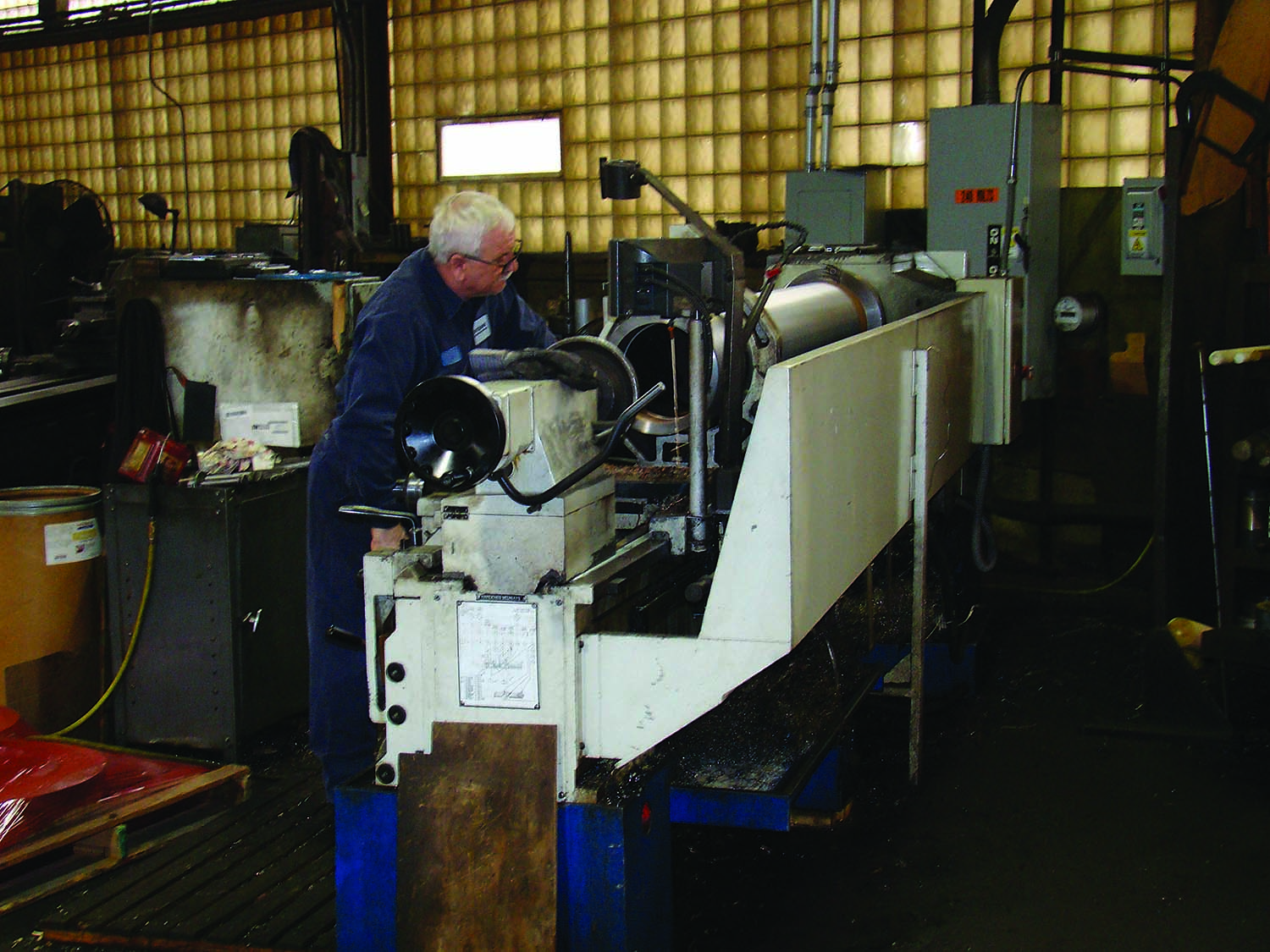

Factors that typically hurt machining accuracy are magnified when parts are larger.
Factors that typically hurt machining accuracy are magnified when parts are larger. Image courtesy of A. Richter

In a company blog post about the challenges of large-part machining, Shirsat said factors that typically hurt machining accuracy are magnified when parts are bigger. This means that careful consideration needs to be placed on monitoring and countering these factors. Temperature is one of the more notable and significant examples of this. The process for machining massive parts generates a lot of heat, so users must compensate for the heat to maintain integrity of the final part. As these parts have larger surface areas, additional quality checks may be required to ensure that parts are being fabricated with reliable repeatability. Taking semifinishing passes and setting aside time to measure between passes before taking one or more finishing passes can be critical to achieving tight tolerances.

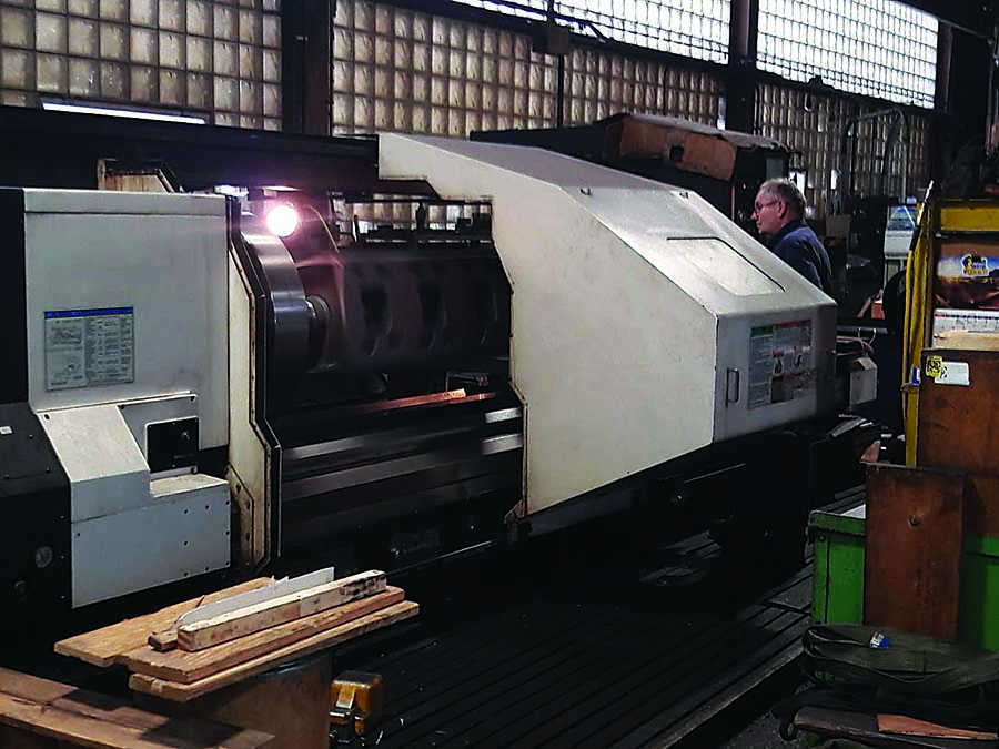

Technox Machine & Manufacturing's equipment for machining large, heavy parts includes a King machine tool.
Technox Machine & Manufacturing’s equipment for machining large, heavy parts includes a King machine tool. Image courtesy of A. Richter
“Some take maybe three days, some take two weeks, and some take longer,” Shirsat said.
However, he said lengthy cycle times don’t involve lights-out machining once a shift ends at the shop’s climate-controlled facility.
“We’ll just stop and restart it the next day,” Shirsat said.

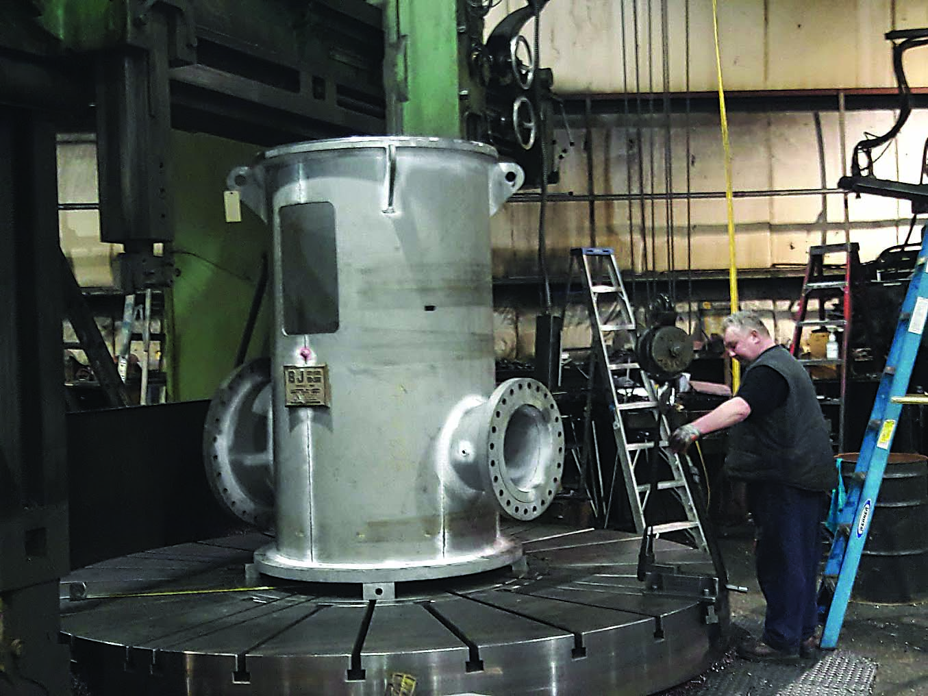

Technox Machine & Manufacturing produces a variety of large and not-so-large parts.
Technox Machine & Manufacturing produces a variety of large and not-so-large parts. Image courtesy of A. Richter
