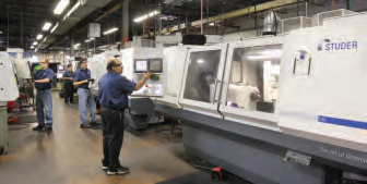

The Studer S40 CNC cylindrical grinder from United Grinding enables Damen Carbide to process shafts up to 63" long and weighing 286 lbs.

Over time, Damen Carbide purchased five CNC Studers: three S40 cylindrical grinders, an S31 cylindrical grinder and an S22 production grinding platform. In addition, the shop bought a Blohm Profimat MT 408 for surface, profile and creep-feed grinding and a Walter tool and cutter grinder, with another Walter on order.
The new equipment enabled Damen Carbide to reduce cycle times, particularly ID and OD grinding on the Studer machines, and allowed one person to operate multiple machines.
In addition, the shop was able to bid on RFQs that it previously was unable to because of capacity limitations. For example, the S40, which provides up to four grinding wheels via a turret wheelhead that automatically swivels and has a high-resolution B-axis and C-axis for form and thread grinding, gives Damen Carbide the capability to grind longer and heavier workpieces—up to 63" and 286 lbs. Previously, the maximum length was about 25".
"The CNC S40s have opened new doors to customers in the long-shaft business," Bachmeier said, noting that it's possible to grind a small part in a big machine but not vice versa. "We make parts only 1" long in those machines."
Also, the S22's HSG (high-speed grinding) package, which offers circumferential speeds up to 140 m/sec., enables out-of-round grinding of any shape, such as hexagon, triangle or square. "It calculates so fast that I can put a round part in the machine and make a square out of it," Bachmeier said.
Damen Carbide still uses some of the older grinders, even circa-1950 ones, to perform secondary operations and produce small part runs because it's difficult to make a profit setting up those jobs on a CNC grinder, Bachmeier explained. "Once you have 10 or more pieces, then it's worth using the CNC."
Besides grinding speed, a major difference between older and new technology is the price of the machine. "Back in the day, you could buy a machine for $30,000, $40,000, $50,000," Bachmeier said. "That's not even a 10 percent down payment on one of these machines."
While the financial risk for Damen Carbide has increased, so has the reward. "When we put on our Web site that we had five CNC Studers, it was amazing the number of new and large customers that called us," Bachmeier said.
